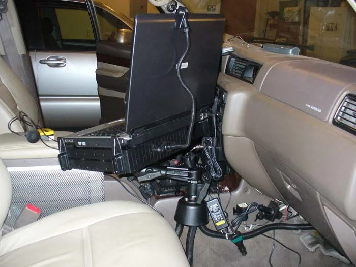

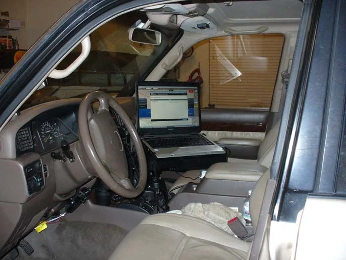

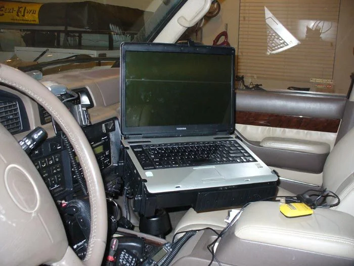

I replaced Rachel's laptop last year and I had this 4 year old laptop lying around. I took it on trips like Moab and the Black Hills. It still works fine for the web and most office type applications.
I had a Dell Pocket PC I used as a GPS. The one thing I didn't like is it provided a small view based on its screen. When I expanded out it was hard to see.
So I researched computer mounts and seemed a lot of people had success with the RAM Mount III.
I went ahead and installed the setup. Using it for GPS and detecting wifi spots. In addition to my company provided broadband card, it provides a lot of flexibility on the road to surf the internet, look up my PDF engine repair manual, use MS Office for anything needed and to use for GPS for on and off road. I can also watch movies (Not while I am driving). So I also bought a 12V plug for the laptop to run off one of my aux ports
Not sure how much punishment it can take so I will try it out at Moab. If I like having the laptop and this doesn't hold up, I can get one of those smaller tough books.
If I don't like it, I can go back to my PocketPC setup

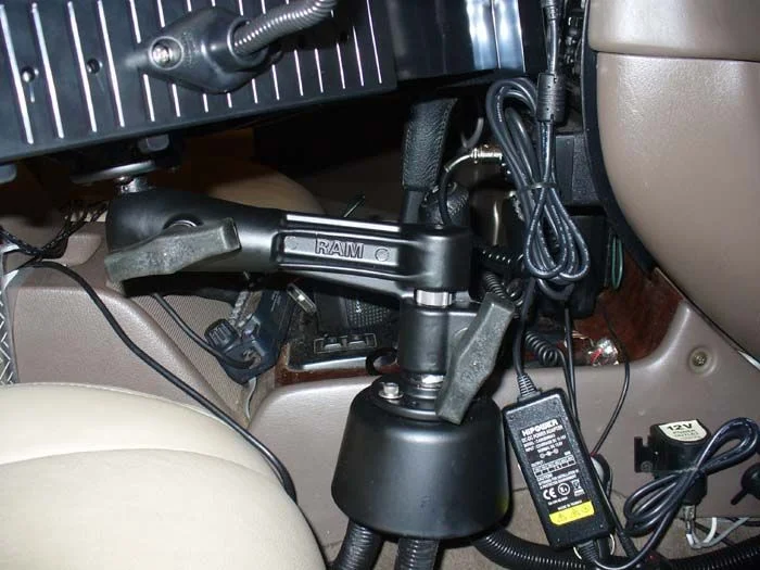

The RAM Mount was fairly simple to install, kind of a PIA though the way You had to drop nuts down a hole and shove something in it to hold it in place while you ran a screw from the other side.
The base has a spring that slides to open different sized laptops and keeps it in place
Pretty stable setup. It does vibrate a little bit, but thats to be expected.

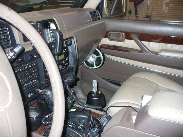

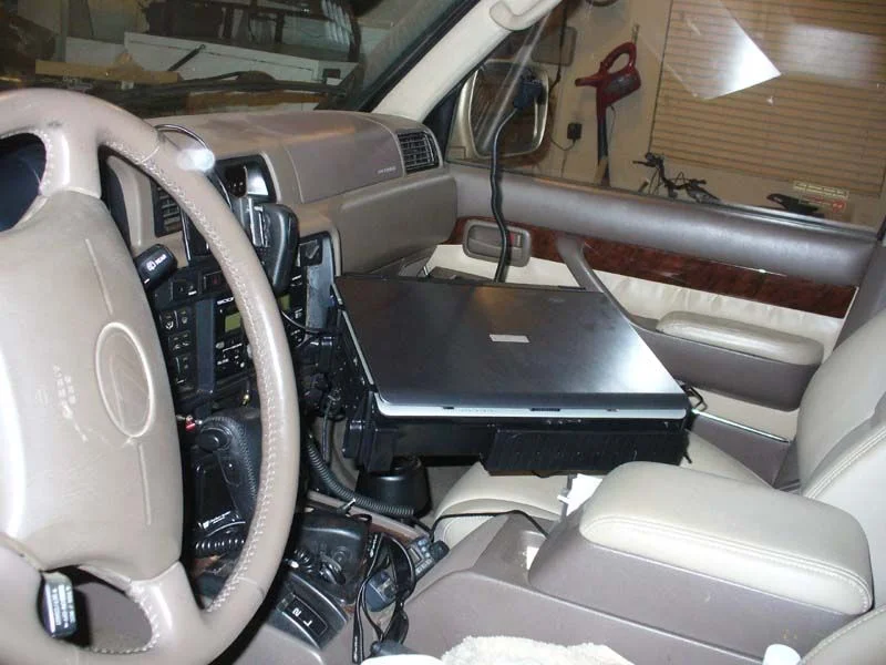

I can take the top part off easily and the base really doesn't get in the way of the passenger.
With the laptop installed, you can still fit a passenger, just part of the laptop is in their space

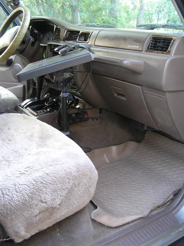

Jotodesk standard mount
This was mine, the "standard" Jotodesk that had a plate with four (one at each corner) and I just used self-tapping metal screws into the tranny hump and it held up very nicely. Not perfect for some but a cheap eBay alternative. A pin would allow the entire stalk to be removed leaving just the metal plate with a steel stud. I placed mine based on the forward most extent of the passenger seat and made it snug. The screen control arm thingy was really beneficial and I found the velcro straps held much better and securely than the stretchy things.

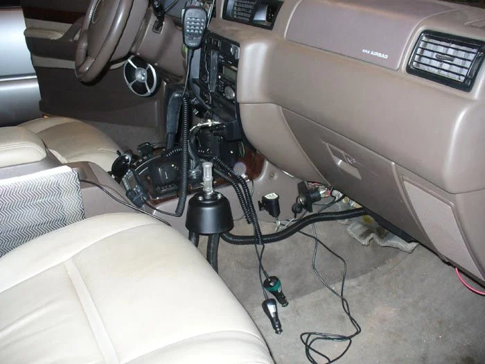

EXCELLENT add, Romer. I've been looking for something like this for a while. Was about to get the generic Jotto or Ram mount, and have a friend fab up a no-holes mount for it.
EXCELLENT add, Romer. I've been looking for something like this for a while. Was about to get the generic Jotto or Ram mount, and have a friend fab up a no-holes mount for it. Of the group I'm chasing with in May, half use Jotto, the other half Ram. Here's the TIV2 with a Ram. The inside of your LX is close to looking like this one!
