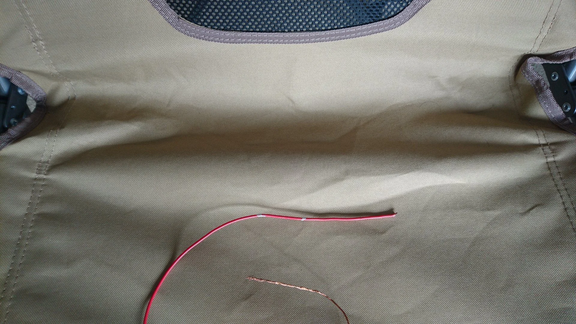

I just put a wire in the glow plug holes. Third hole has a different depth.
Does this definitely mean a dropped precup?
Where do i go from here?
Picture for reference
Thanks again
With a wire, it is posible to feed the wire right through the precup. A straw wont as easily. Double check with a straw and triple check again. But yes it sounds like a precup fell into the cylinder. Have you over heated your truck lately or forgot to put anti freeze in? Hope the precup didn't do a whole lot of damage. You will have to pull the head off your engine. Not a beginners job, but not that hard either.
