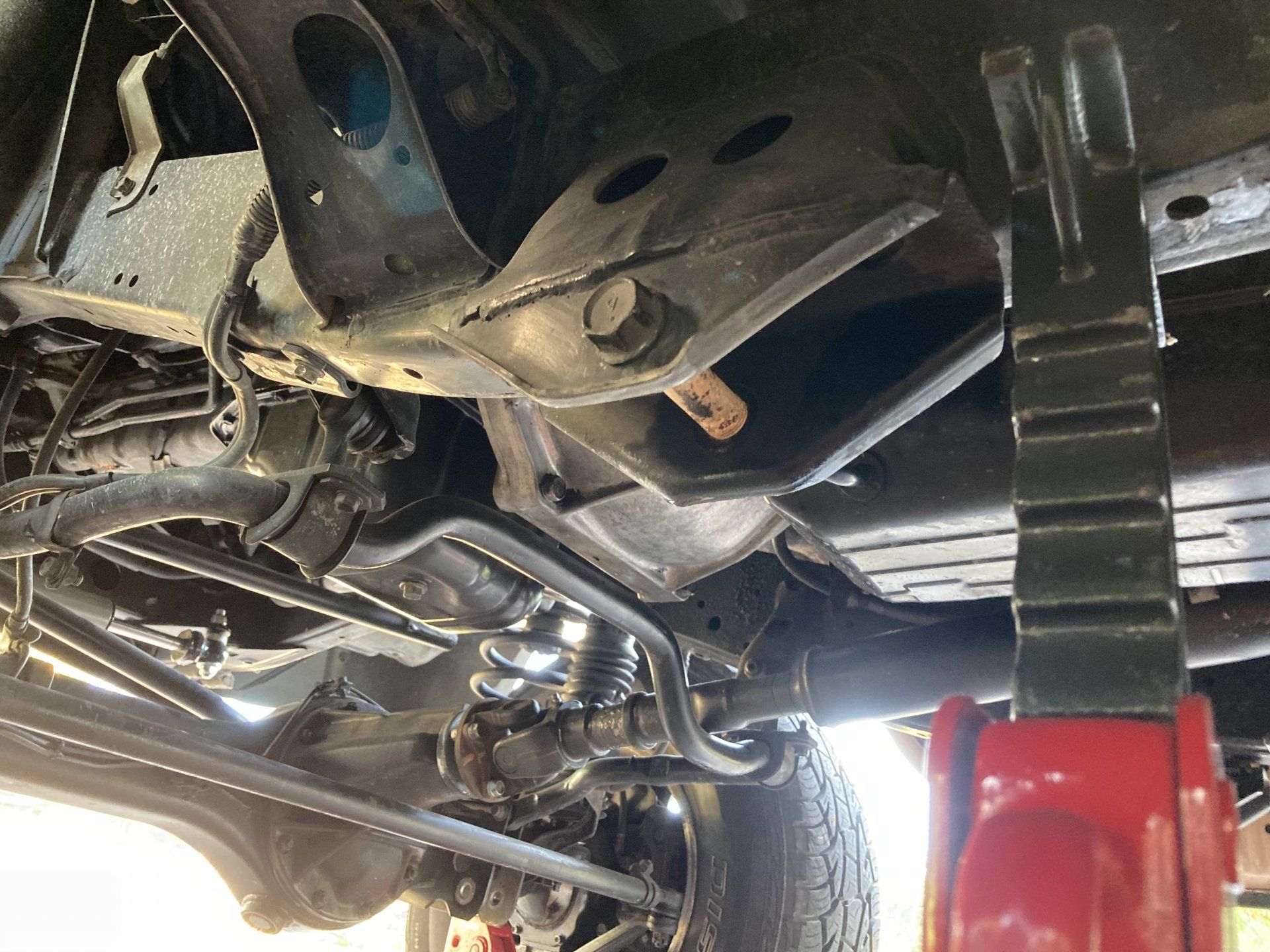

can i use something like a stone bit in a die grinder to take out that material at the top? looks like it would be as quick as anything else i suppose?

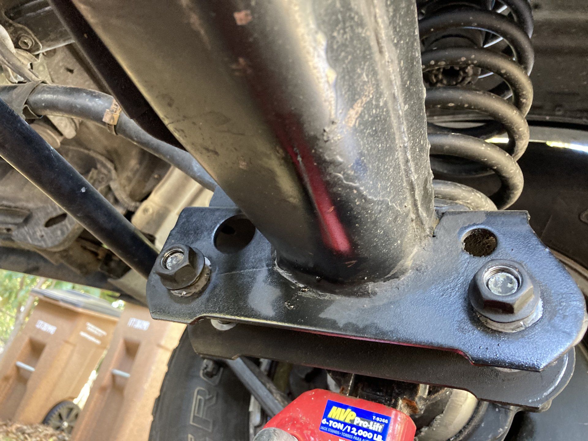

I had notched my arm mounts to the axle shell to run Slee plates when they were the only way to camber correct for 4” lift.
I had to weld back the missing material before drilling new holes to install LT’s plates - so I literally got a punchlist of the drillbit size & such, and a few short notes like the short bolt/nut that pinched the plate / filled the empty hole & then you just dropped the 4 longer bolts w/ the new nuts that took into account you just added 1/4”-3/8” width to the axle arm mounts.
-Frankly I forget any need to remove material from the mount, I recall a ~5/8” bit to drill the relocation hole.

If you have the 2.5” plates all you need is a grinder not a cut off wheel. Drop the arms and mount the plates with the rear bolt in place, then stencil the new location for the front bolts, I used spray paint. Then get after it with the grinder, a normal grind wheel for metal gives you the ability to shape the top half of the front bolt‘s new location. Bolts are round so I just wanted to remove the material I stenciled with paint, no more. The grove from the bottom should be the width of the bolt.
I’m slow as molasses and this my first 80, took my time so I wouldn’t fubar the damn thing and the whole job took 4 hours from pulling out the floor jack to beer (step 6). Best 4 hours invested to date after the new suspension.
Crawl under there and hold the plate up, it’s not that hard to visualize how the plates mount and what they do to the orientation of the axle.

I have two variations of plates now and the 2.5” plates don’t require drilling. The 4” still does.

floor jack goes under the pumpkin and as it lifts it slips around a bit and the weight of the vehicle shifts so i leave it unchocked at the back wheels?
the issue i always have is i think i fill up the tank and it always leans to the DS side like a mofo so i have to get the jacks under it a hair earlier than i would prefer.
so right now i had the FRAME JACKS under it (with some steel plate under those) and the front tires were in fact touching the ground.
then i jacked the axle up a hair under the pumpkin and got the PS axle and wheel jacked up a hair (and the wheel here is off the ground).
then i got the floor jack under the axle on the DS and got it up a hair and off the ground. the wheel on the DS is still touching the ground however.
this is noob territory for me since jacking a rig like this up is a tad different than anything i am used to. also, i am not totally sure what happens when i unbolt the radius arm but i guess if the axle was not jacked it would want to drop straight down?
THANKS for any additional help and of course proper apologies for any extraneous noise.
also i can delete this if it belong on a separate thread. wasn’t sure where to post it actually.
No need for jack or jack stands, just unbolt and remove control arms, they are not holding up the vehicle or anything else....
thanks. am i good to go like this though for dropping the radius arms?
rick seemed to indicate i could put it on jack stands. one guy i was talking to seemed to say it was a bitch to do it on the ground with one guy.
“On assembly you will be able to rotate the axle using a floor jack on the front steering arm on the right side of the axle.”
OK. so jacked it up and got the arms off.
tools:
22mm socket
24mm socket
22mm closed end crescent
24mm closed end crescent
1/2" breaker bar
1/2" ratchet
drift to knock the bolts out
mallet or mini sledge for the drift
variously sized pipe extensions to get leverage on the breaker bar (make sure you have some shorter ones)
the four 22 mm front bolts have the BOLT HEAD on the outside facing in and have the four raised locking areas on the NUTS on the inside. so you want to undo the BOLT HEAD on the outside face because the nuts are captured on the inside.
the two bolts at the back have the 22mm BOLT HEAD on the inside so the bolt is facing OUT and the 24mm NUTS are on the outside. the raised locking areas switch sides and on the back bolts the raised areas are actually on the BOLT HEAD head back here. so you want to undo the NUT on the rear bolts.
the easy way to remember this is that you are removing bolts by the bolt head or the nuts from the /outside/ of the frame.
these take a lot of force to get off and if you have 12 sided sockets you are in business. but if you don't make sure you have different sized breaker bar extenders. the ones here are from an old hammock support thing someone threw out and i kept one leg and chopped one down. what else? well if you find yourself putting too much force on these make sure you are turning in the right direction (!) or you are not on the locked side of the bolt.
i had to run out for a 22mm socket for some dumb reason because i had everything up to 24 except 22. and also i got hung up on the rear bolt DS. i actually "accidentally" got the first rear one off because i automatically continued on the outside of the frame and took the nut off on the first one on the passenger side and then i was like "s*** i was supposed to take those off from the bolt head side i wonder why that came off" and i spent 30 minutes ****ing with that sixth one by trying to take it off from the locked bolt head on the inside of the frame.
also if you don't have 12 sided sockets you can angle that breaker bar outward or inward and get some /angle/ on the handle and slip the extender over it and then lean the handle back in or just work it at an angle.
if your undersides are gnarly do yourself a favor and soak them a couple times a week ahead of time. i wouldn’t want to be under there with rusted nuts trying to figure out my clockwise counterclockwise raised lock head or raised lock nuts where can i get the extender in over here and wondering why it’s not turning basically.

you can see the washer under the head of the bolt in some cases and it goes under the nut in others. the other way to think of this is you want to undo on the /washer/ side because the other side is going to have the raised locking area.
front has the raised area on the nuts and this is on the inside:
rear has the raised area on the bolt head and this is on the inside of the frame:
