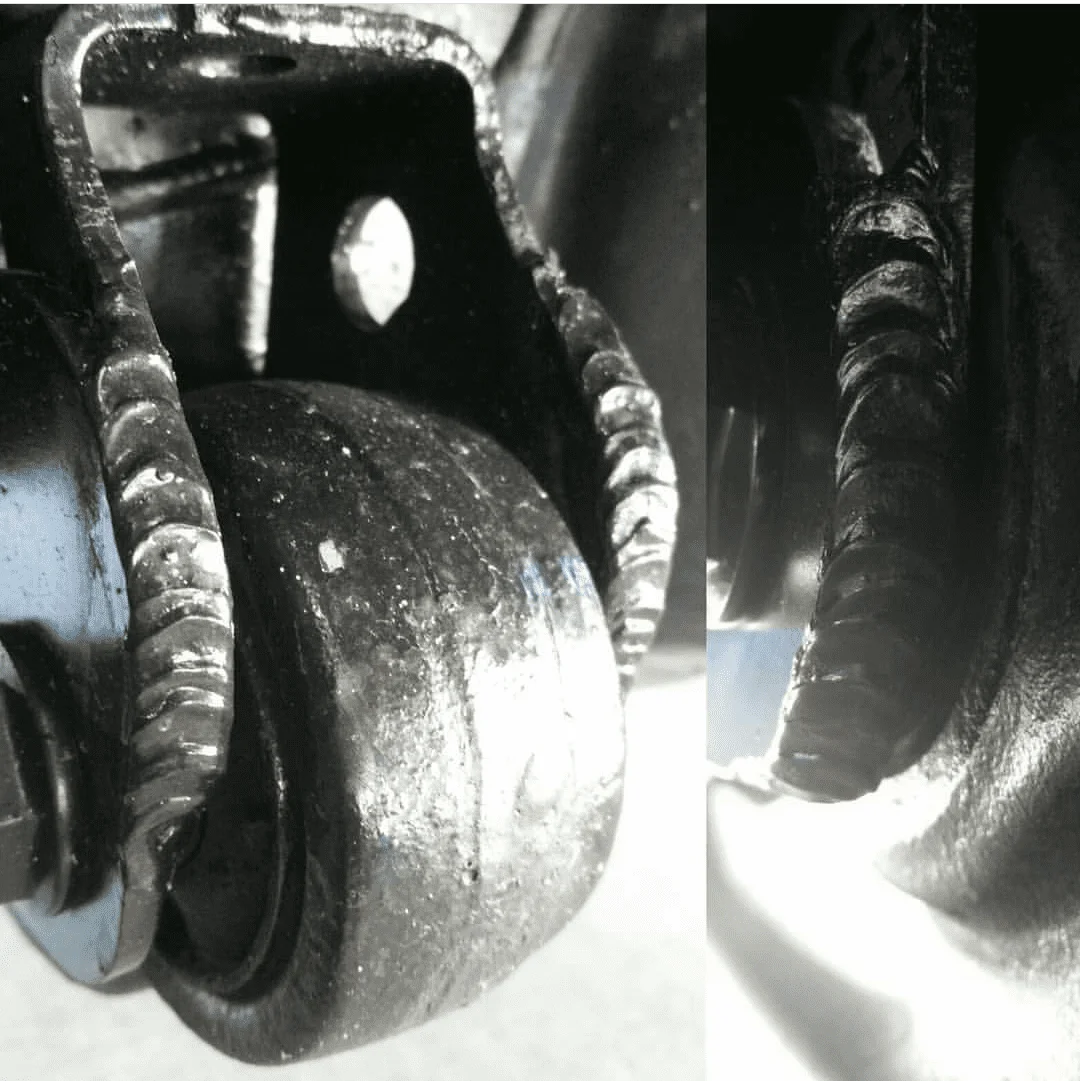

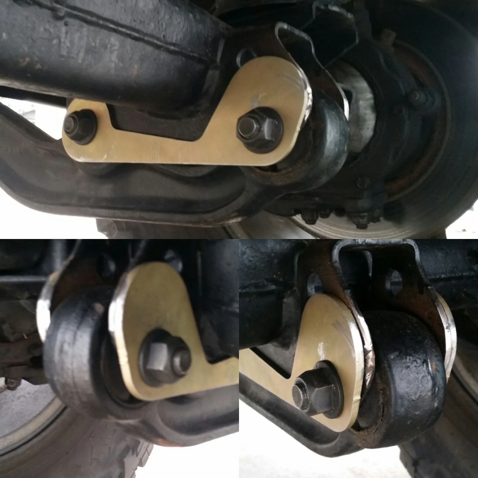

Finally got my Land Tank Caster Plates installed. Pretty easy job, just a little notching involved and a couple of welds and your done! Oh and paint.
I just replicated this install. No issues so far and my handling is dramatically increased. Was at close to -1 caster angle with correction bushings prior to install. Removed the corrector bushings and installed all new OEM bushings. Used a harbor freight 20-ton and the wits end press kit and they popped out like butta.
Welding up the plates was pretty straight forward. Just put beads up the front side of the plates. (Someone chime in if more is needed :eek:)
Nope, good to go

As @FJsapper experienced my caster was out of spec with just the caster correction bushings. I was at 0* caster before and now that I have @landtank’s plates I’m at 2.6* with much improved road manners. Also, as @Qball said you lose the poly bushings and can return to OEM bushings with the aforementioned bennies. I like my new hg, but really like my rig with proper caster and OEM bushings. I didn’t realize how junky the ride was with caster out of whack and the poly bushings installed.

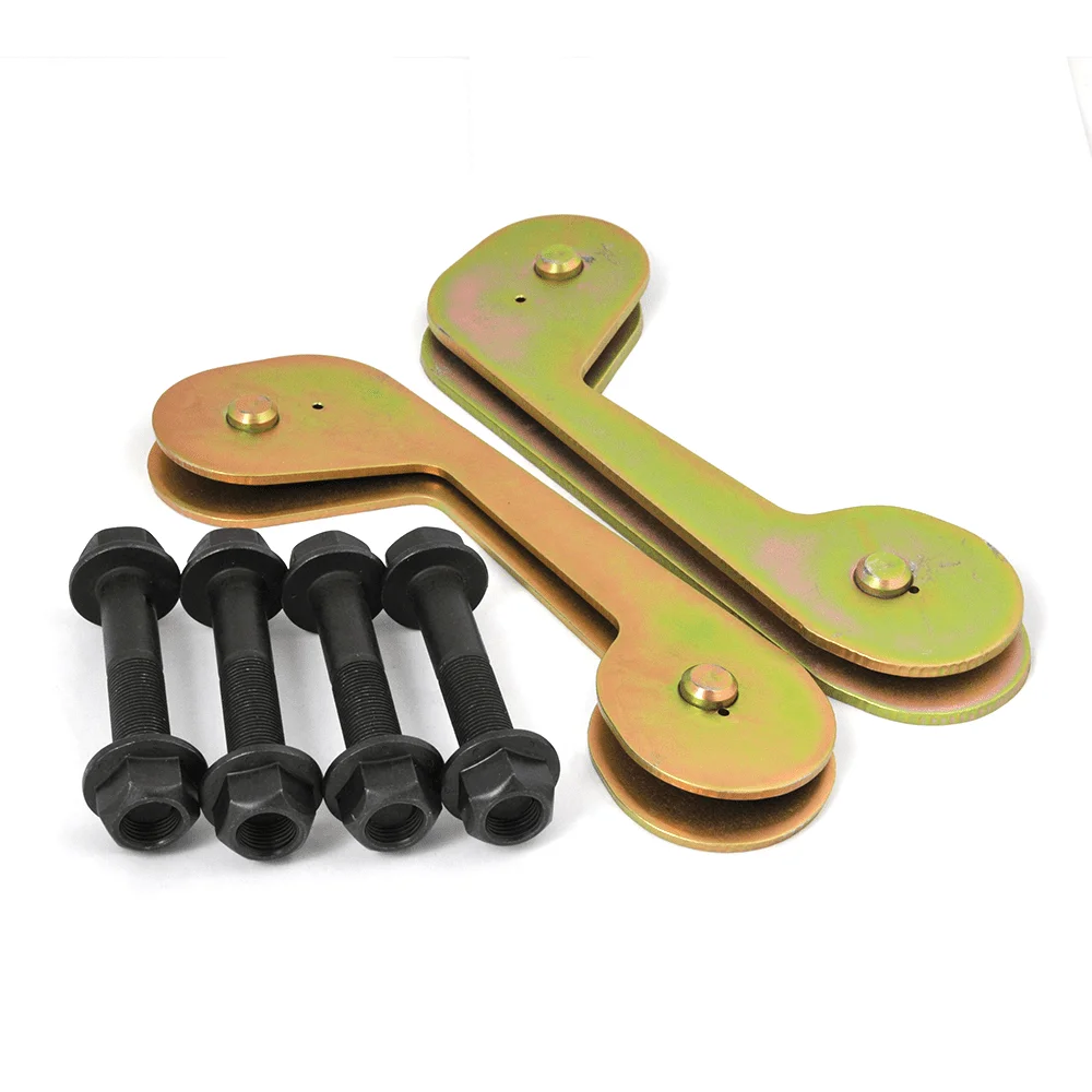

So not sure if this is a stupid question but the hole above the notch doesn't have a bolt that goes through it so your just counting on the weld to hold the plates on ? Looks like Slee and some others use the two bolt attachment set up.
There are pins inside the bracket that align with the old bolt hole. The weld stabilized the plate from shear to prevent wallowing of the bolt hole over time.

Would these plates be safe to install at home and the drive with out being welded a short distance to the welder?
Yes, totally safe to run around town with without the welds.
