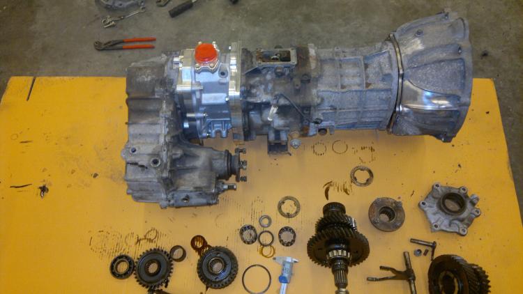

The idea is to get the best off road performance and dependable, on a street legal vehicle. Reliable as a Land Cruiser.
- Toyota 1UZ-FE 4.0 V8 (2gen, Soarer).
- Toyota R151F with split case (19 splines) from australian HJ78. 5 speed manual.

Stock 1UZ manual swap into SWB feels a gorgeous!. Very quicly throtle response, lightweight, and with low gearing of the Volvo portals, to have a nice crawler ratio.
I before built a 1rd and 3st gen 4runner with 1UZ manual. And feels really great, much more in the 1st gen, he is more light.
I think the 1UZ is a very good engine for a short wheel base and lightweight vehicle, always with manual transmission. Feels and sound like a racing car.
