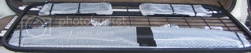

The packaging was pretty impressive. After opening the cardboard box I found the whole thing wrapped in heavy paper to avoid scuffing.
All the mounting brackets were wrapped in bubble wrap and zip tied to the rack. Looks UPS proof to me.
Always a plus.

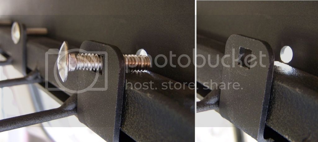

The rack is heavy gauge square mesh that looks like it will never sag, with thick steel mounting brackets. The whole thing has a very nice powder coat finish. The mounting hardware is stainless carriage bolts & stainless flanged nylock nuts. It's all high quality.
I did notice no installation instructions. Doesn't look difficult but instructions are always nice.
I assembled the rack before installing it. The shelf drops into the side brackets making it very strong. The keyed holes and carriage bolts made assembly very quick and easy. I had to play with the spacing a little before installation. I like the location.

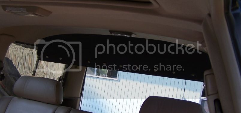

The side brackets bolt directly in the third row grab handle mounting holes (remove the handles). They fit perfectly. The spacers and necessary hardware is provided. I determined they mounted with the bolt holes forward. It's pretty obvious.
Because I pre-assembled the rack I needed a second person to hold the rack while installing the bolts & spacers in the grab handle locations. In hindsight I think you could install the side brackets, then rack, then front guard. I'm not taking it apart to test this, just a theory.

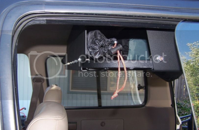

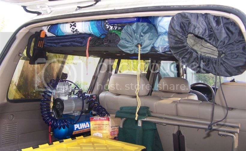

I ran about 100 mile of the OR Back Country Discovery Route #3 on my way to a family camping trip. The rack remained solid. No creaks or rattles. I slept in the truck Friday night so the above head storage was very nice.
One thing I really like is the quick access. The smaller things I usually lose are right there easy to find.
I have a Foxwing awning, the poles and tie downs were always in the way or lost. Now they're easily accessible through the side window and not in the way. I'm pretty happy.
You do lose a little visibility through the back window. Personally I carry a lot of gear and gave up on seeing through the back window a long time ago.
