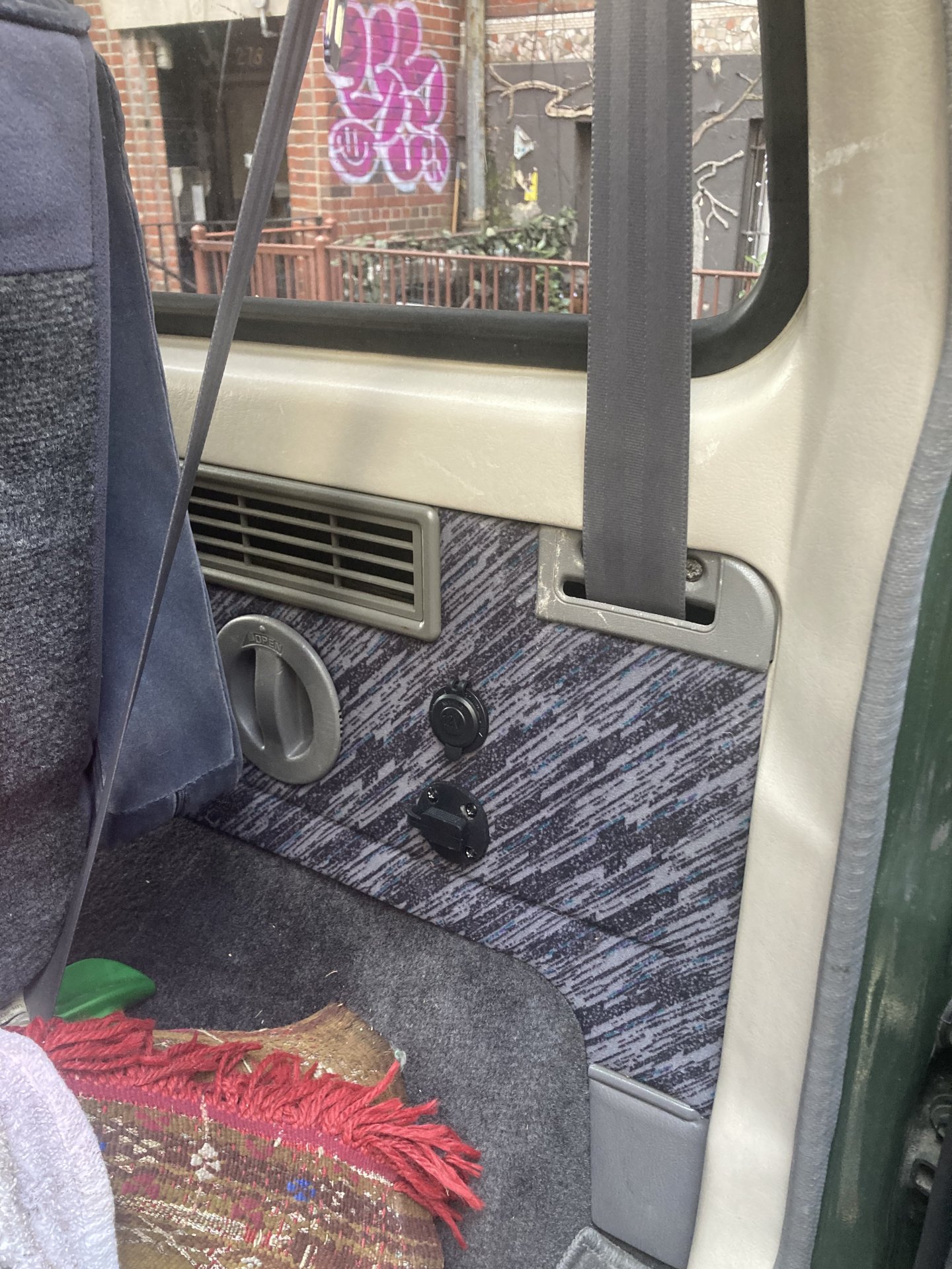

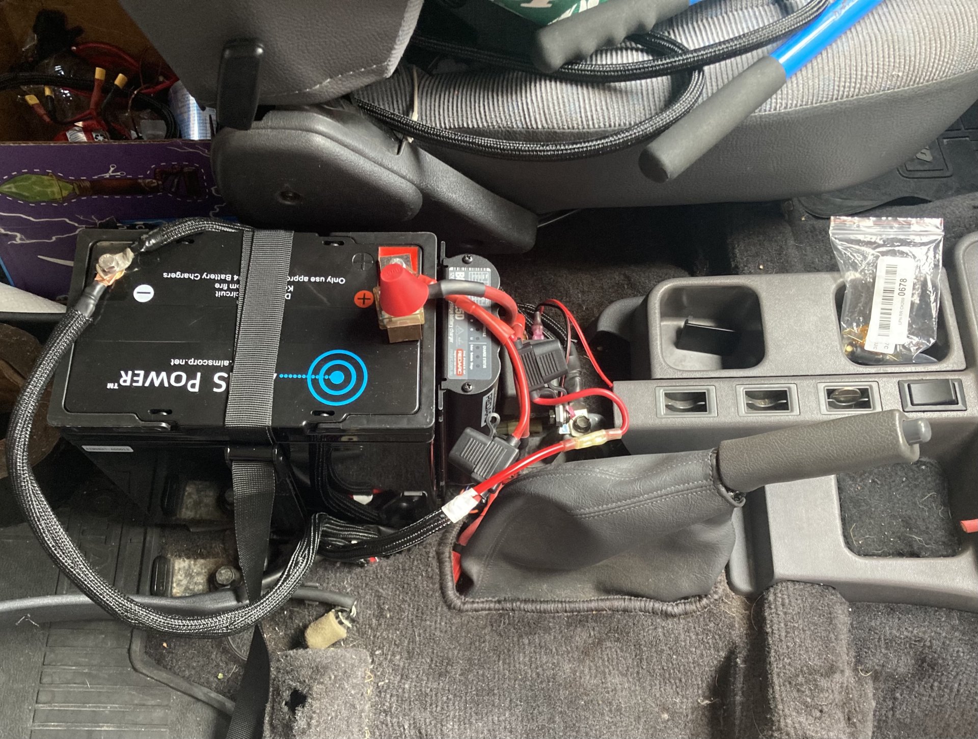

I was never happy with the amount of space my aux battery box took up with how limited space is in my truck already. So I decided to delete the rear heater system, which I always considered a bit overkill in such a small truck, and I relocated the aux battery to the space in the center console previously occupied by the rear heater blower.
First I bypassed the rear heater lines at the T-fitting by just replacing with a 5/8” joiner piece. Then I removed the heater, sealed the hole, and worked out how to make my battery fit. I had to raise the console brackets an inch. Then I wired two 12V outlets and an SAE socket to connect my portable solar panels to. Pretty pleased with how it turned out.
I also managed to find a blank rear panel for the console to replace the one with heater controls.

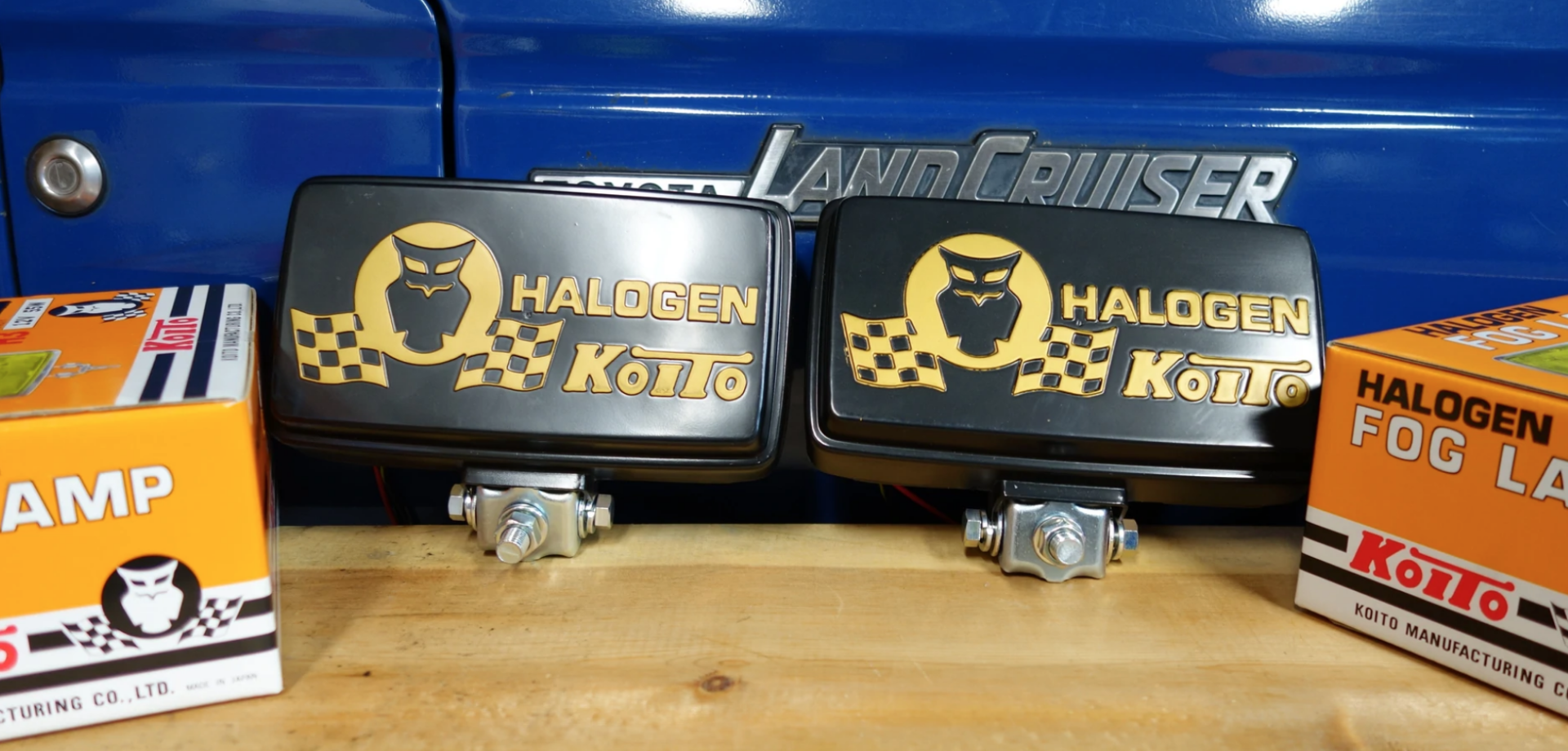

I have asked everyone I know their opinion on which of these lights to go with, and I'm leaning towards the rectangle lights. I feel like they will look good with my rectangular headlights and the angular lines of the car. The circles are cool too though. What do people think?

I’m a big fan of round lights.

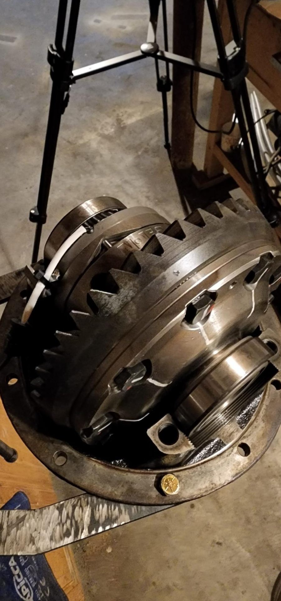

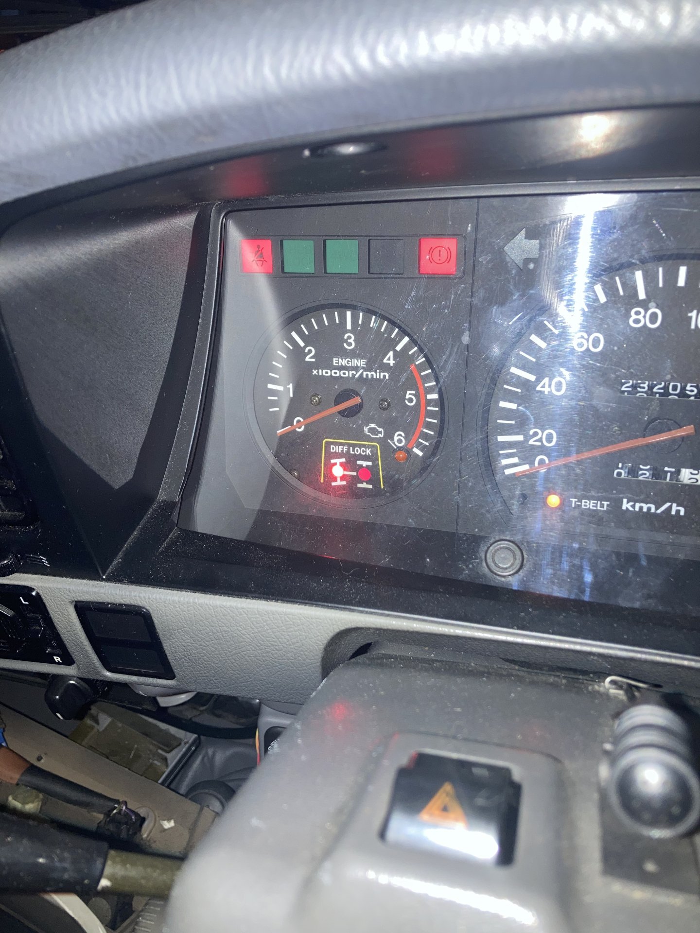

Heading to the shop this week to have my eaton e-locker installed. In an effort to save a bit on labor I went ahead and and did the wiring, through the factory diff lock dial. Then I added an indicator light on the dash where it would have been from the factory on a front and rear locked model. I think it came out looking pretty good.
