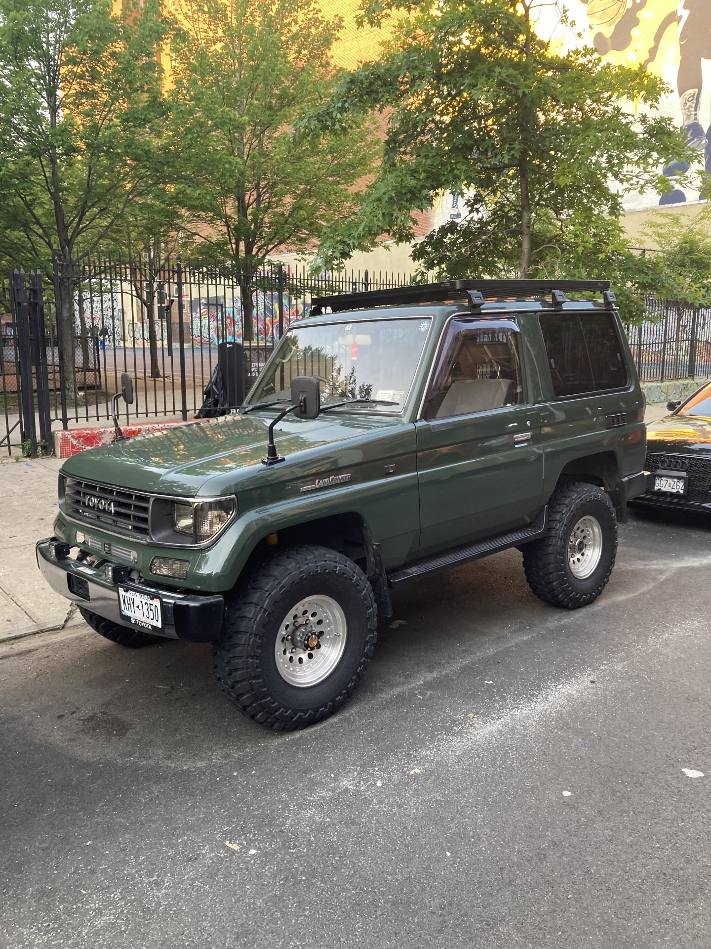

Finally, got the dobinsons 60-65mm kit installed, with 33x10.5 tires. Initial impressions are very good.

taking a poll: who thinks I should lose the side steps? Kind of feel like they look a bit soccer mom.

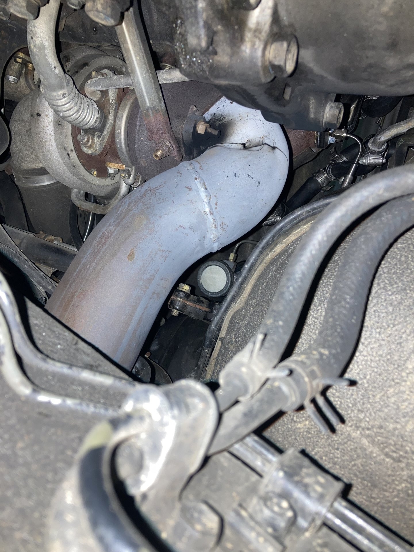

Well today was a mixed bag. Put on this sweet ladder and 80 series speaker grilles, then discovered a huge crack in my downpipe. Not sure what I’m going to do about that. Any suggestions?

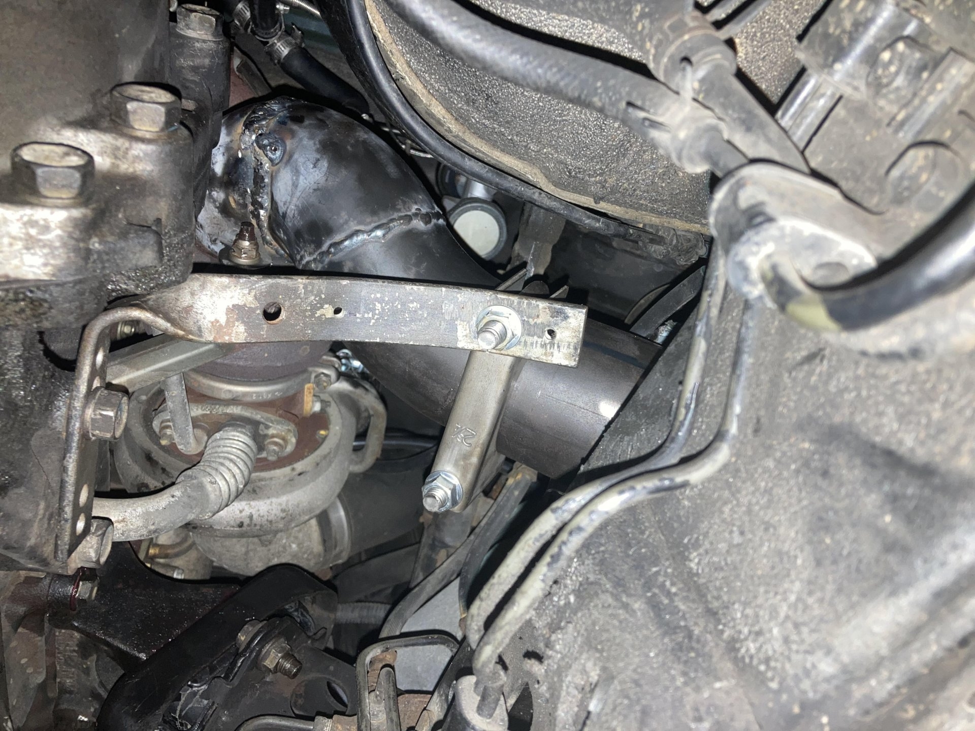

Alright, finally got the downpipe welded back together and a brace added between it and the engine. Now back to the fun stuff.

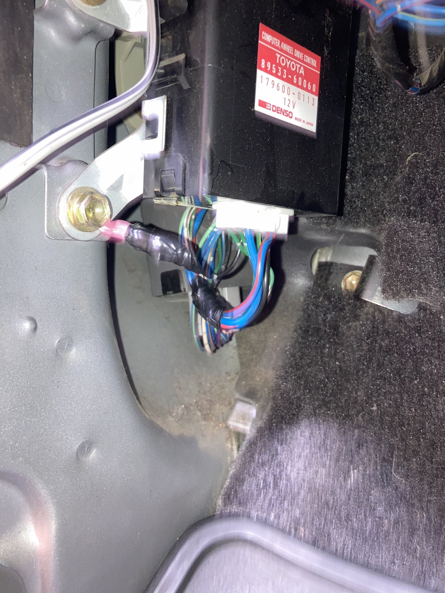

As is the case with all of the Toyota factory e-lockers I know of, the locker will only engage in 4LO. To bypass this, you can simply ground the black wire (pin 8) on the 4WD ECU in the passenger kick panel. Did this today and now my locker engages in 2WD, 4HI and 4LO.
