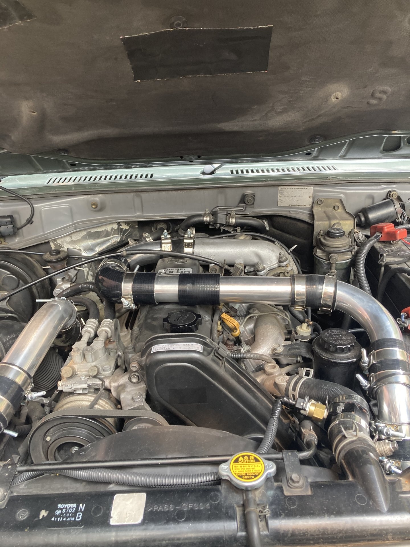

Forgot to mention I changed all of my intercooler piping to 2”. The 2.5” was getting pinned between the hood and valve cover and wore a groove into the valve cover.

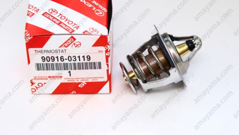

I recommend that you replace the thermostat with this one
1kzte aussie specs
works much better besides using silicone oil in the fan clutch of at least 10,000 cst
with that welcome any hill that must be climbed under the summer sun

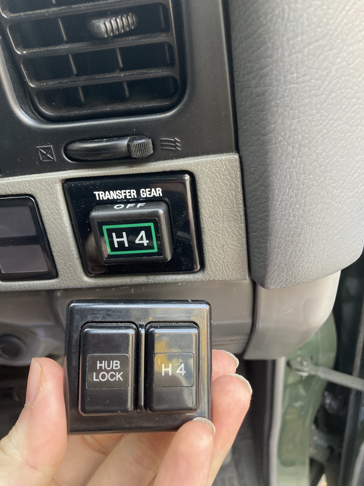

Having been converted to manual locking hubs, my hub lock dash button served no purpose, so I got the manual hub style switch. Luckily, the plug for this one is already hanging out behind the dash unused, so this was an easy swap.
do you know what the part number is for this?
