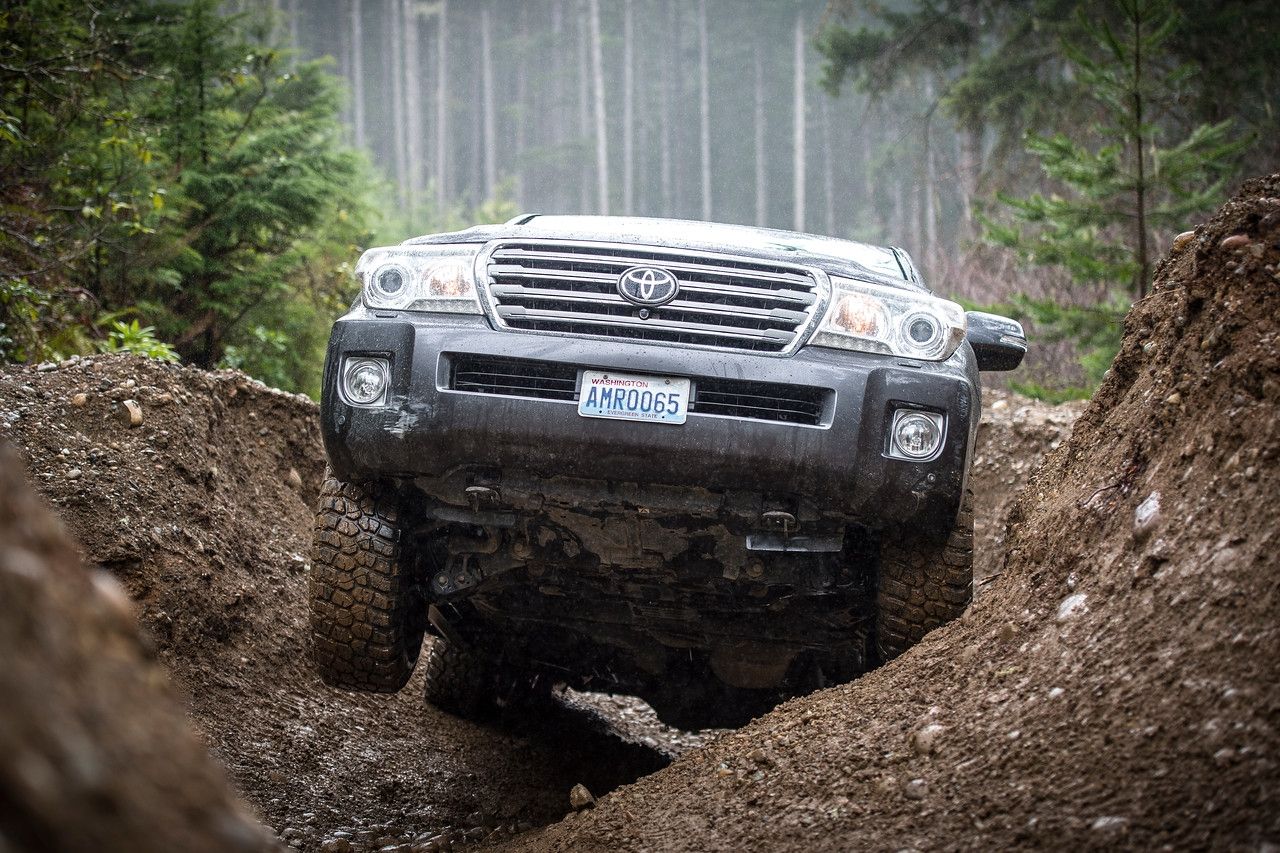

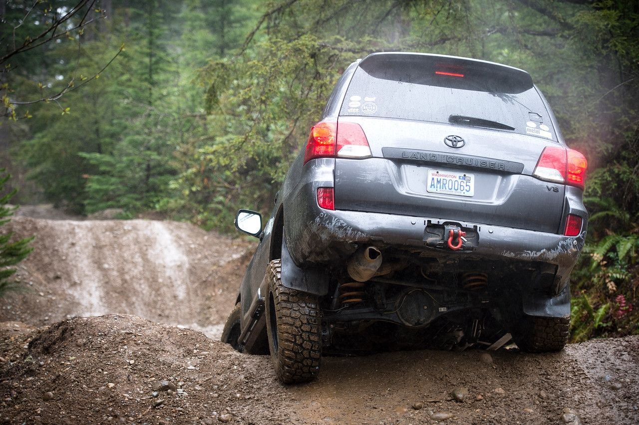

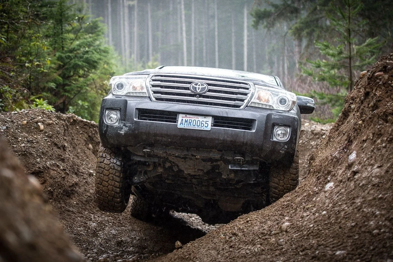

Just gonna run Tahuya, a local trail just 25 minutes from my house. It's a chill trail but has lots of flexy spots , we call the below section the "Tank Traps", if ya rub you will find out quick:)
