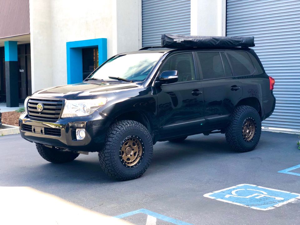

@drftsub looks great! would you mind a straight shot pic of the rig so I can see how far the wheels stick out? love the wider stance!
Not the best photo, but they barely poke with the narrow tires. I do not expect rubbing in the rear and the front can be dealt with, this thing will get wide glass fenders eventually anyway so if I need to clearance these that’s fine although not ideal for now.
looks really good with tire wheel combo! I'm liking the more narrow taller tires these days... how much lift do you think you have?
Thanks, and considering it came to me with the lift on I dont have much other than parking next to other 200's, which are surprisingly common in Santa Cruz for some reason, I see 2-3 on a daily basis and have seen as many as 7 in one day here.
That said Its probably around the 2.5" ish area, and I am considering lifting the front up a little more.

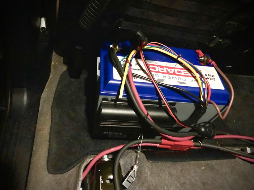

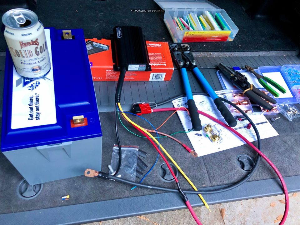

Last night I thrashed to get a secondary power source in as we are leaving today to go out this weekend.
As I do not have drawers yet, I needed to keep my setup fairly removable while I wait on @cruzerDave to get the new design out so I can permantly install all this stuff.
Went with a 100ah LiFePO4 from Battleborn, yes they were a little pricier than a DIY, but considering timing I didn't want to play with all the variables, and it came with great reviews and warranty. I may do a DIY 180-200ah setup after I do some more research
To charge it I went with the Redarc BCDC with the Lithium profile, and wired accordingly.

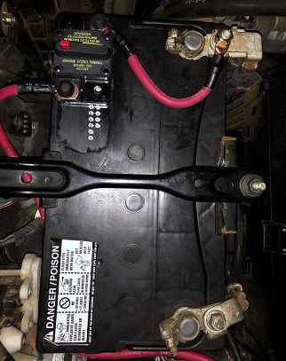

Under the hood ran through a 100A Bluesea breaker.
A little VHB to keep things together for now, we will see how this does for the Dometic CFX75DZ compared to my last AGM setup.
The Anderson plug pops up through the hole in the carpet left from the seat removal, so I can unplug and remove when home. The pigtail on the feed side let me place the battery setup basically anywhere I need it to be.
That is sick! Those Battleborns are the way to go for plug and play, they are literally "drop in replacements" for lead acid and have built in BMS. And as far as price, those things are actually a good bang for the buck. 3k to 5k cycles... In comparison that is 6x to 10x the life expectancy as a Yeti Goal Zero.
How are you planning to draw power from it, I assume you'll connect an inverter?
Edit: I'm going to do something exactly like this and mount in the same location, I have enough room behind/in my "drawers" to fit all the power components plus around 18g of water if I can ever figure out a solution I like.
I am running a simple dc "cig lighter" plug and have the fridge plugged into it. I will be running a Redarc Smart Start Load Disconnect but it didnt arrive in time. The end plan will be for this to feed a dc fuse panel in the rear and that should run:
  • Fridge plug
  • Aux rear lighting
  • Power to the RTT for lighting / phone charging
  • Water pump
  • inverter for when the wife wants to make margaritas in the desert
I may need more than 100ah lol.

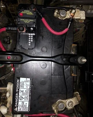

  • Fridge plug
  • Aux rear lighting
  • Water pump

@TonyP ran a similar setup, but I believe he put the BB in the primary battery location and moved the starter battery to the passenger side.
I was heavily considering that , but saw something about operating temps and changes to life expectancy / state of charge and decided if I could keep it inside without too much issue, save the underhood space for air compressors etc.
