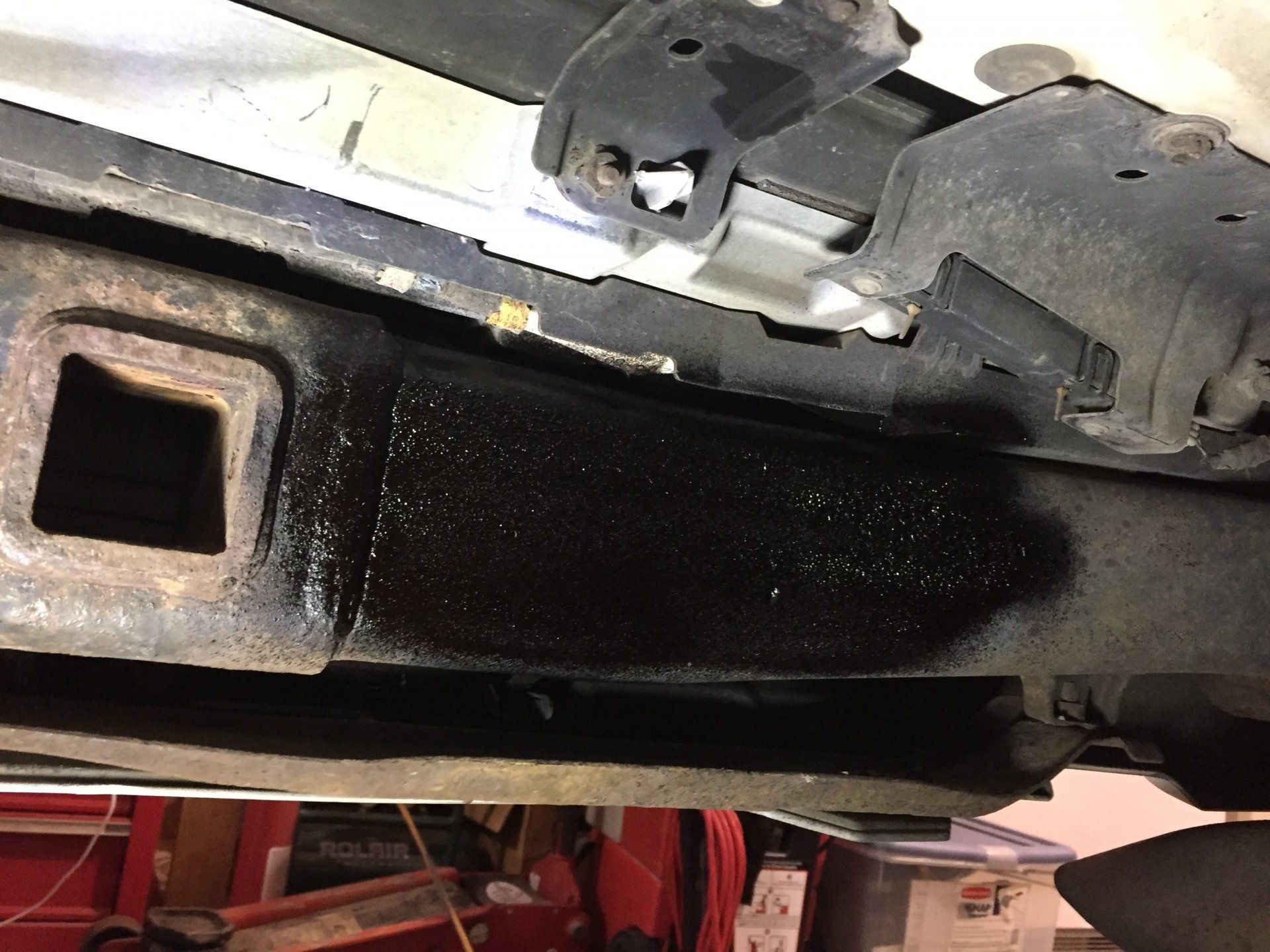

A 295/70/18 fits underneath with millimeters to spare. It's awfully close to 35" in diameter.
Could just the differences in brands of tire also, some 35’s are 34 inches tall and some are 35. Maybe I’ll try to shoe horn one of these Goodyear 35’s under it and see if it fits!
I cut a couple pieces off the rearmost crossmember and off the back of the forward crossmember to get my spare raised up underneath. Then, similar to what we did on the 80's as a spare tire lift, I raised it up underneath. I was going to raise it up again since I now have a little more space. Not sure if this will help, but possibly. I can send another photo but I think it will be obvious what I removed when you look.
Ultimately, the tire must still fit between the those two crossmembers, however if you are just a sliver away from fitting, I would grind just a little off the back of the receiver slot as it protrudes from the crossmember (EDIT: and clear the panhard bar). Maybe another 1/4" without compromising that weld 🤷🏻‍♂️
Ultimately, the tire must still fit between the those two crossmembers, however if you are just a sliver away from fitting, I would grind just a little off the back of the receiver slot as it protrudes from the crossmember. Maybe another 1/4" without compromising that weld 🤷🏻‍♂️
I’ll try to fit one and see how close it is, thanks for the tips, might be able to make it work thanks
