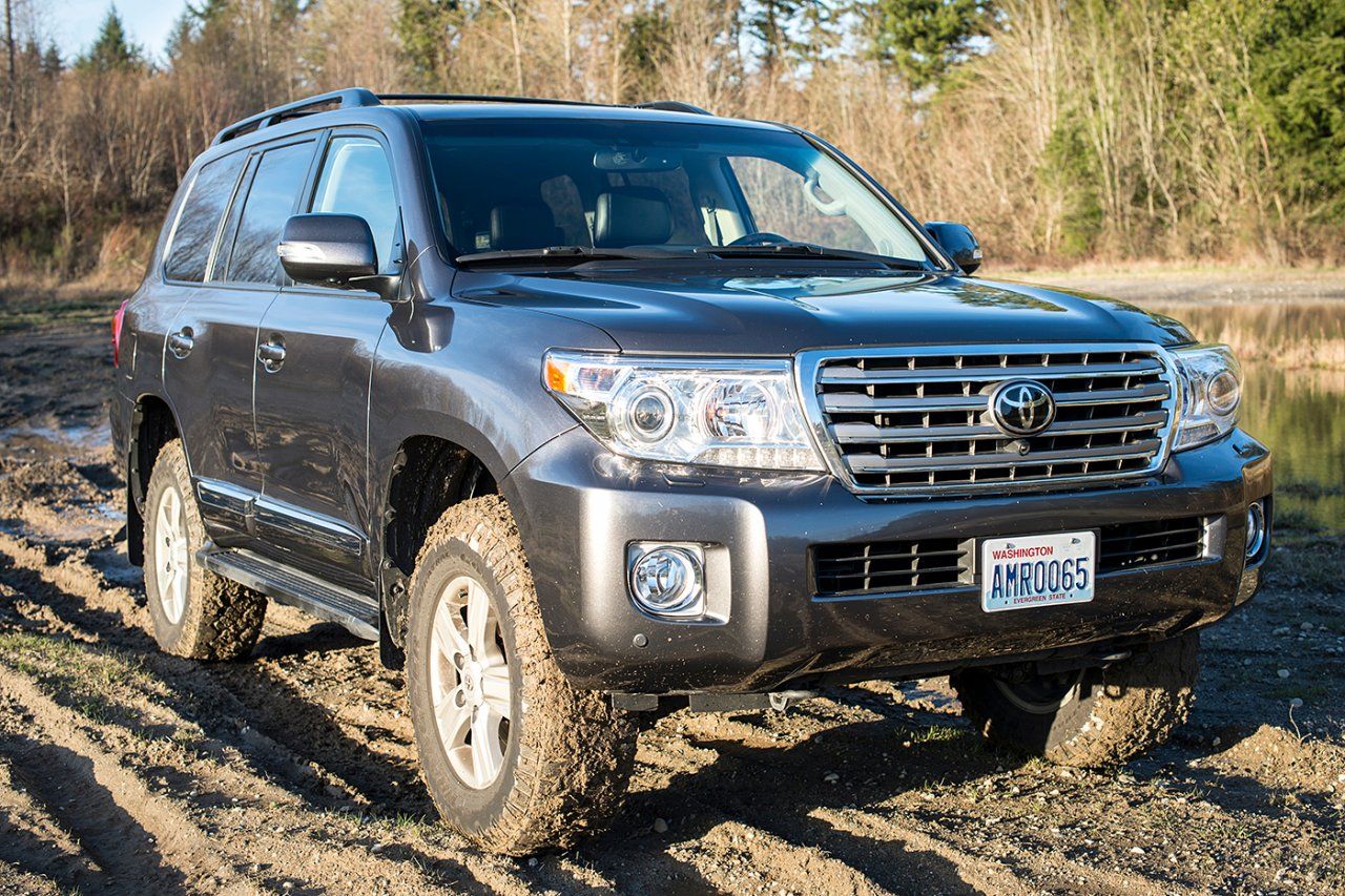

@kreiten I browsed through your thread, and it appears you don't get any rubbing on the KDSS or frame with the Fuel Anzas but I wanted to double check. Any rubbing on anything metal? I think the stance with those wheels and tires is ideal for a 200.
I've had to continually cut out more plastic over the years but do not rub on the KDSS bar, frame or anything metal, for me this setup works perfect! Hope that helps Matt, let me know if ya have any other questions etc...
I have the Fuel Beasts which are almost identical to the Anzas in sizing. The 285/70r18 Ridge Grapplers do kiss the KDSS a bit and I haven't quite perfected the plastic trimming/re-shaping in the rear of the driver side wheel well. I think the RGs are spec'd at like .2 inches larger than the KM2s, assuming that's what Ken is still running?
Thanks gents! I had a wheel/tire that was losing ~5 psi a day even with brand new rubber just installed, so I thought I might have an issue with the wheel. I went back to the tire shop and they inspected and didn’t see any issues, but they replaced the valve and reinstalled. If I have any more issues with it, I’m going to replace with some Fuel 18” wheels and keep these tires which I love and have had 3 sets now.
yep still running the KM2's, if they ever kiss the KDSS I don't feel it at all, but I know at full crank it's close...

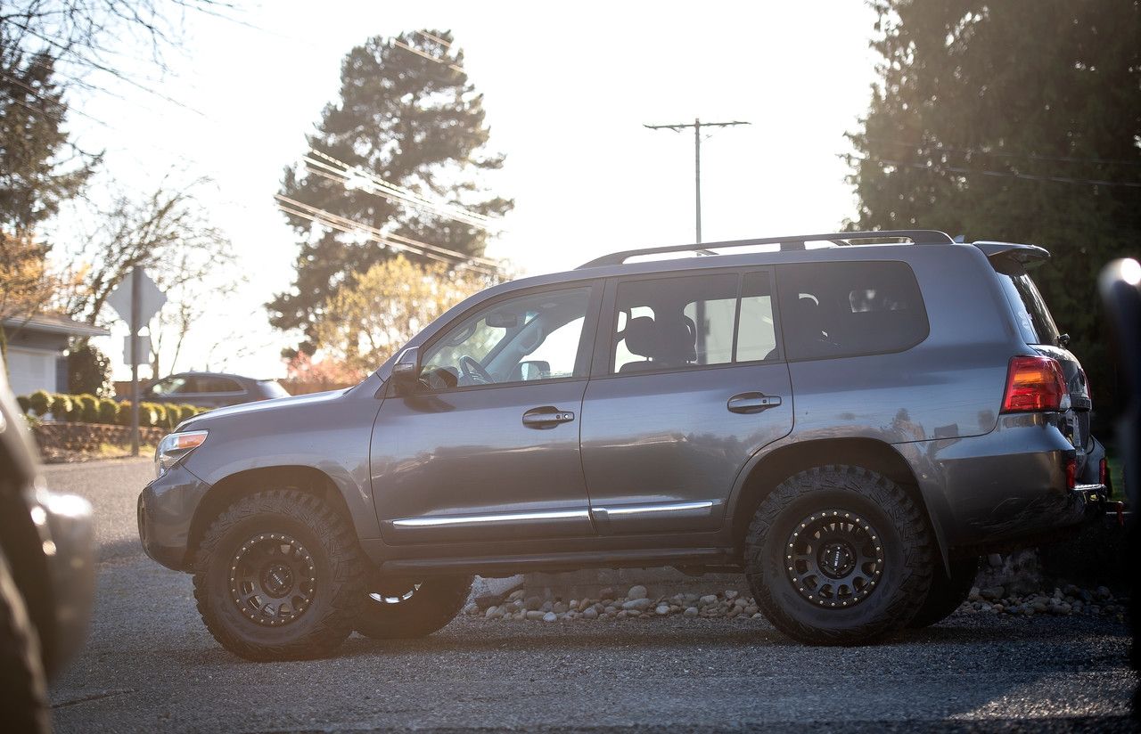

after the lift, still rocking the 275/70 R18'sView attachment 1142384
So this is the setup I'm looking to go with - 275/70/18s plus the Ironman 2inch cellfoam pro kit [heard this lifts ride is amazing, feeling almost better than stock]. Silly question, but any idea of your height at this setup [ground to top of rack in inches]? Mine would be slightly lower w/ a 2 inch lift. Goal: trying to determine if this would fit into my garage.
best guess would be 77 or 78 inches as it sat. Still rockin the Ironman CellFoams, they have taking a beating and are still going.
Good to know, assume you've been pleased with the ride quality [clearly you are off road], but also on road? They are currently on sale. Would you recommend paying extra for the pre-built coil overs? ...77-78 inches would work, I've got 79-80 !
Are those the MTRs in 275/80? If so what do I gotta worry about? Just sold my KM3s and looking to purchase those
These are the MTR"s in the 35x12.50 R17's, used a shoe horn to get these on 🤪
