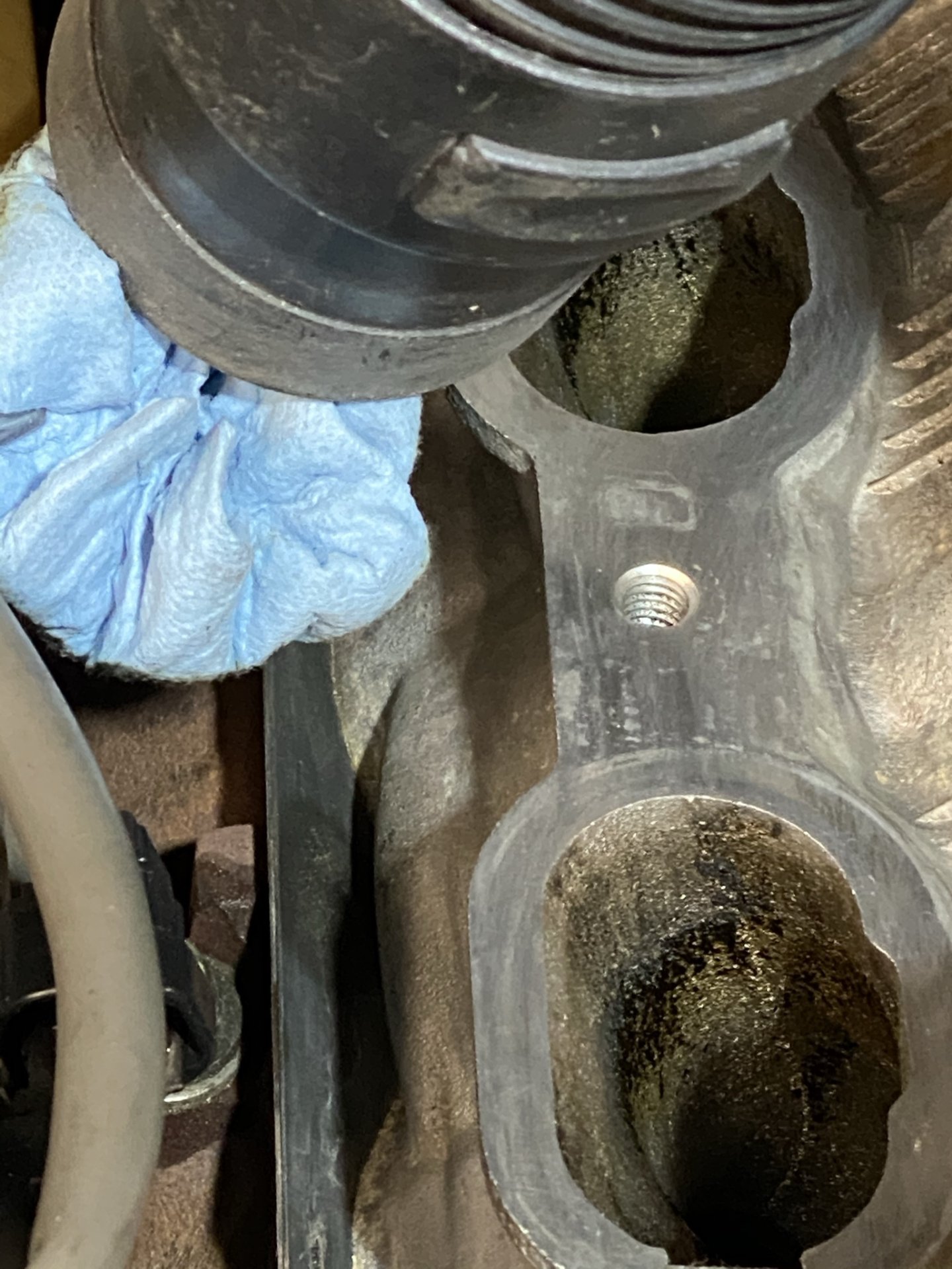

Most important is per-cleaning top of engine. In particular the area between heads and intake manifold. Any dust (sand) getting into intake ports, is a compression killer.

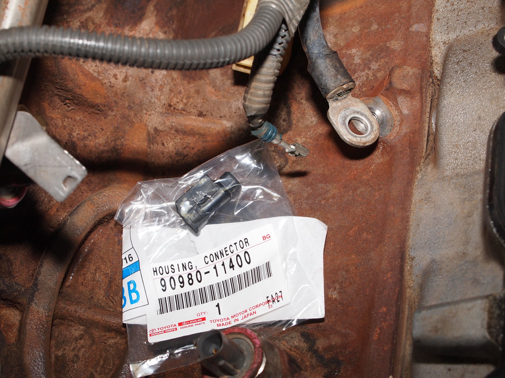

Starter wire housing block, is good to have on hand:

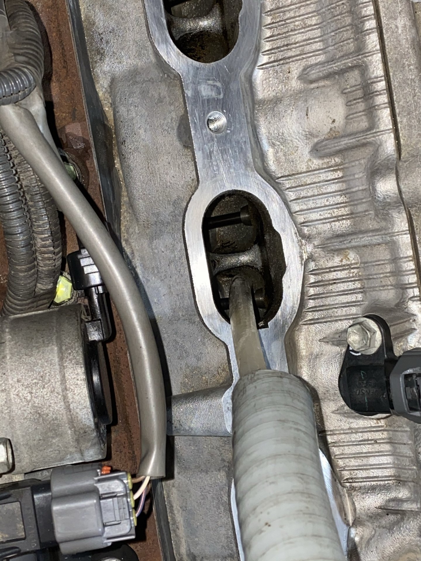

I finish up vacuuming ever intake port of head.

Wire housing block replacement, I've done a ton of them.
When replacing a wire housing blocks. Get parts number from old wire housing block and add prefix 90980-.
De-pinning them, can be PITA. Having new on hand, we can see how they're locked and pinned. Which helps!
Tip:
1) Take picture of order of wire in block, first thing!
2) Unless reusing housing. Don't de-pin, just breakaway old plastic wire housing block. Be careful, just nibbling away at plastic. I find, what works best. Is small curved needle nose. Careful, so you don't damage the pigtail metal pins within.
