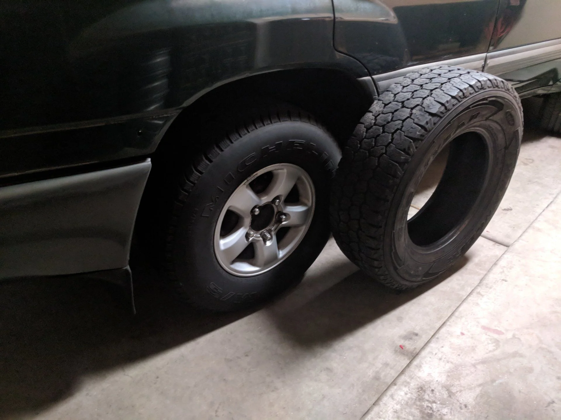

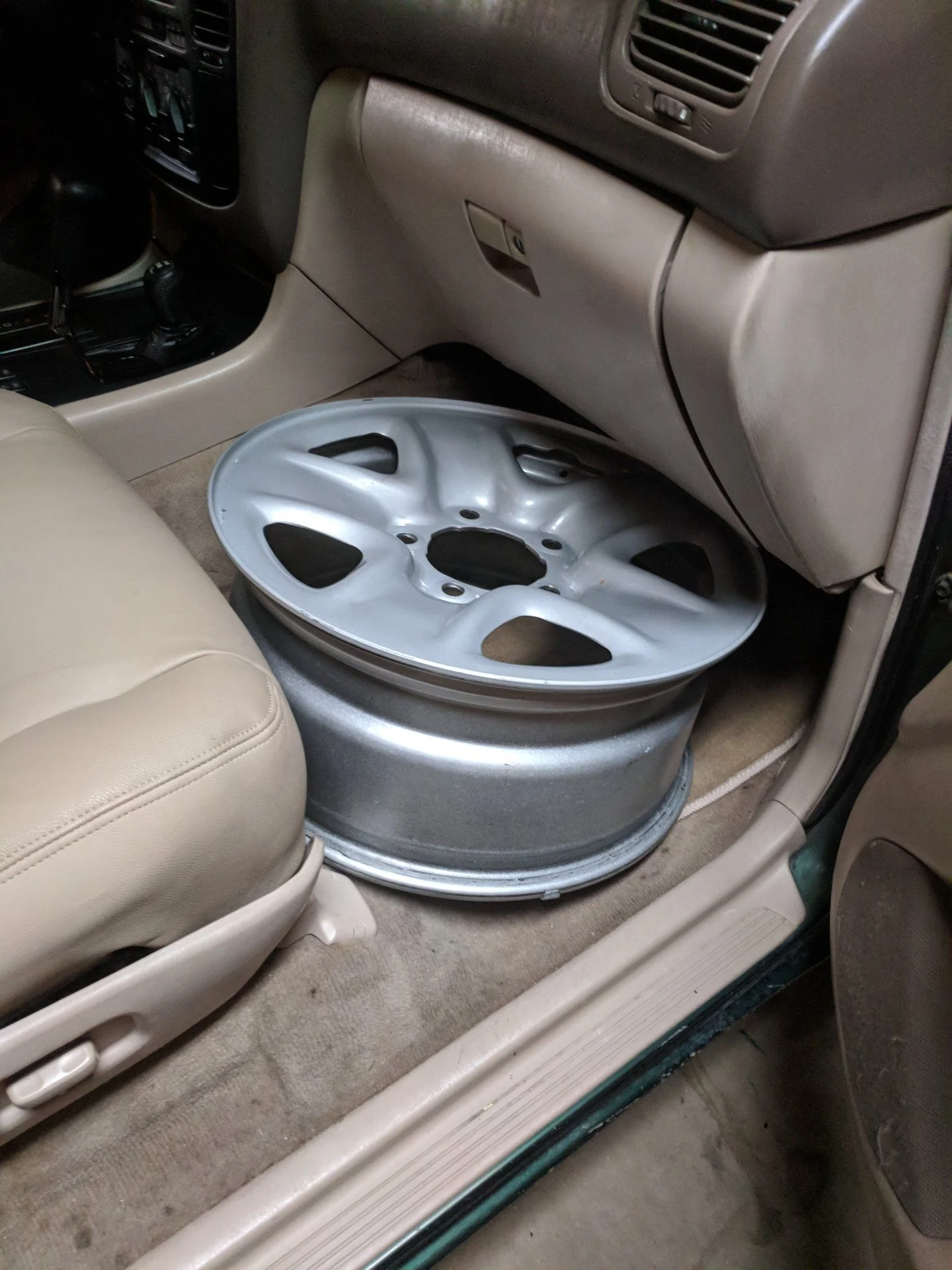

I've been super busy this past month. Not that anything will change, but I finally found some time to pick up a set of tires. 275/70/18 Goodyear Wrangler AT Adventure. Not exactly what I wanted but they should be good for a while. They are about a 2" change. BTW, 5 tires + 4 wheels + 3 passengers makes for a very tight fit in the 100!
I'll get them mounted up here in the next week or so. Also ordered a couple more lift parts, only missing front shocks and some new bushings. That should be a project coming in the next month.

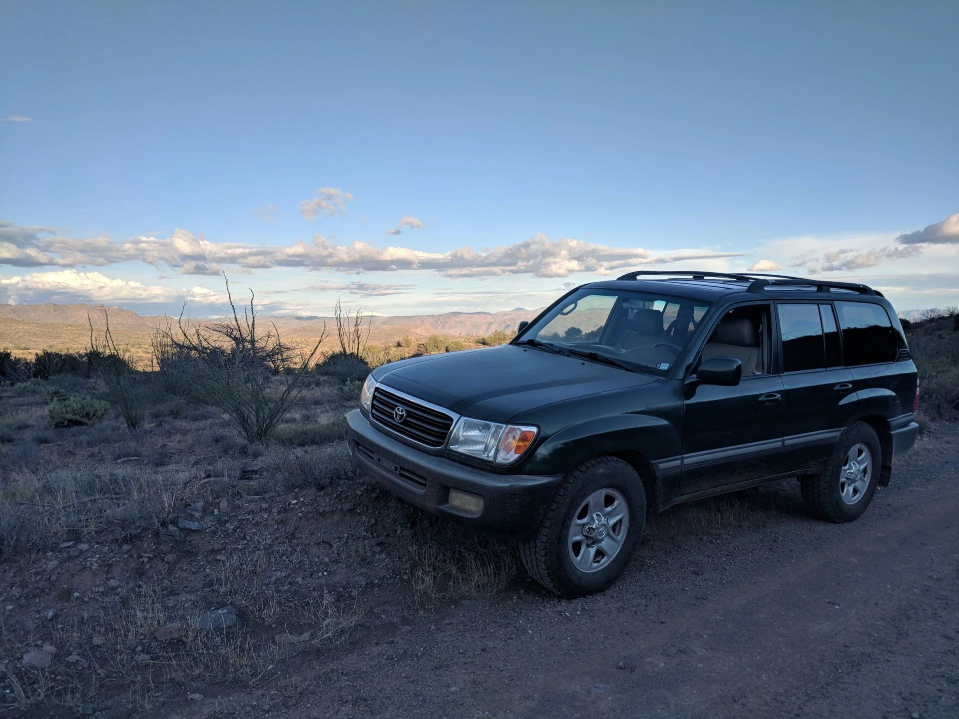

We were able to take a maiden voyage today. I definitely know that I need to replace a few bushings while I'm in there for the lift. Overall the 100 did a great job! I think I kept it in pwr ect, 1st gear, and 4hi for most of the climbing. 4lo was more torque than I needed in more of my situations today.

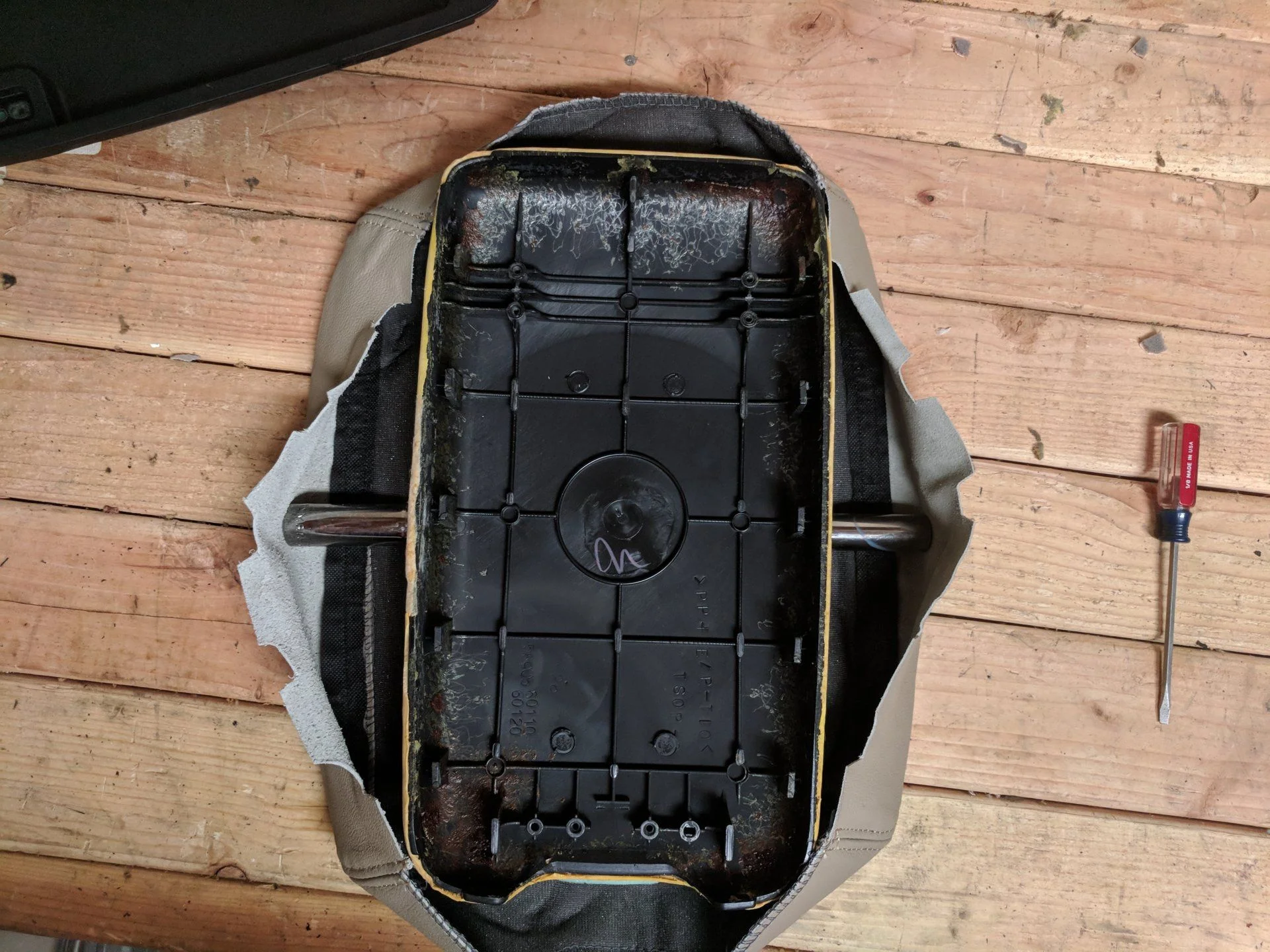

Those seats look great! Mine are in a similar condition and are similarly driving me crazy. Was there a thread or video you used as a guide? I can turn a wrench but have zero experience with upholstery
Just seeing this now @TorchRedTulsan , sorry for the slow response! I also had zero experience with upholstery when I started. There aren't really any in-depth guides. I did watch a video from a guy doing a miata seat that I found on youtube just to get the idea, but it is actually pretty straight forward. Fairly time consuming though. I'd say it probably took a total of 10 hours or so to do both front seats.
Really my best guide was just doing one piece at a time and putting them on in the same manner that they came off. If you can wrench, you can do it! I'm happy to answer any questions as you go, it's still pretty fresh in my mine.
@TEXAS 57 's build thread was my inspiration for the seats (and many other things)
I happened upon a 100 Series 4 month build
Semi-helpful miata re-upholstery video: youtube.com/watch?v=_mi1HVCnRv0&t=870s - basically just learned how to use hog rings in this video. I bought a hog ring plier kit off amazon for about $20. It did what I needed it to do.

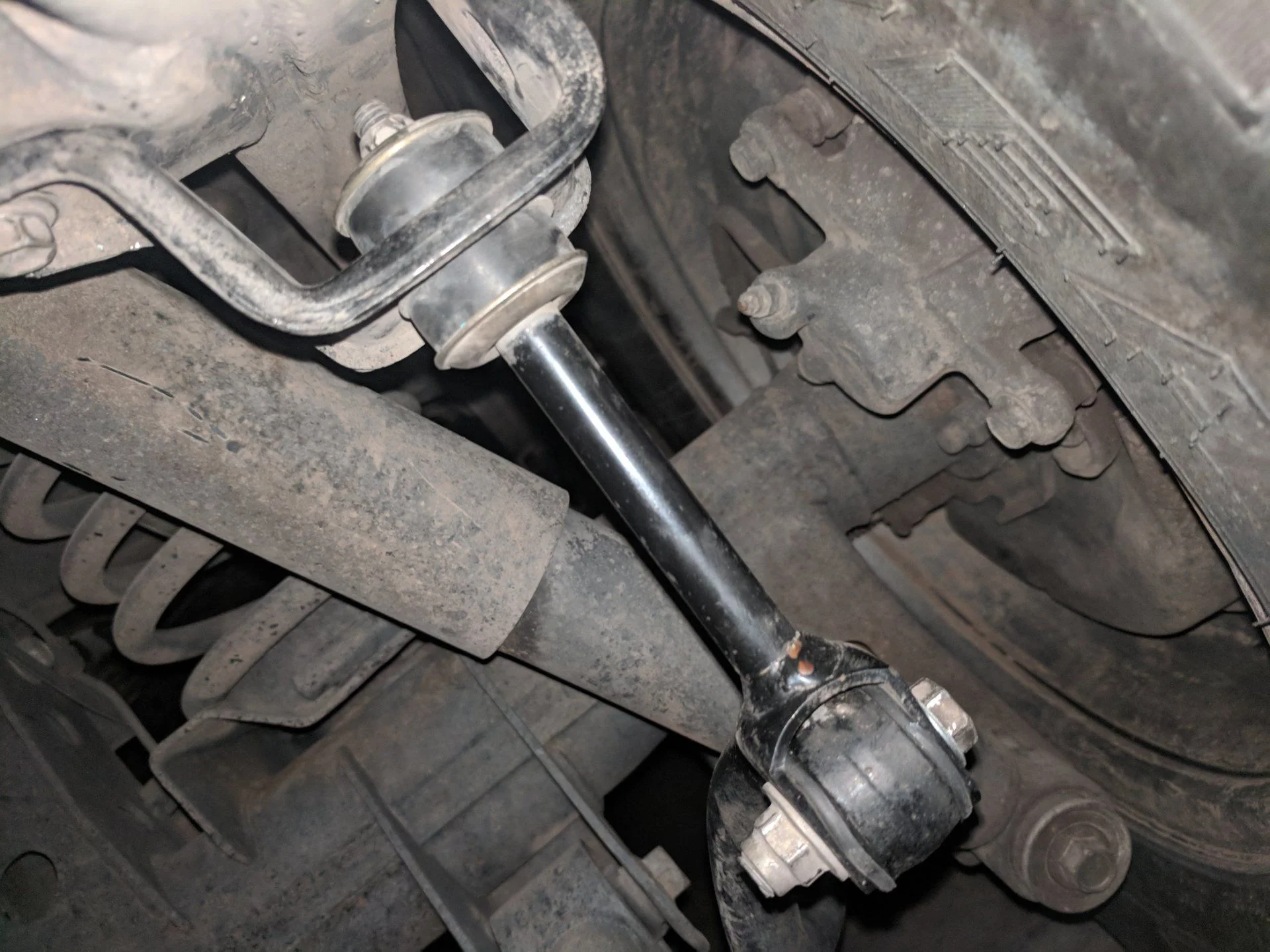

So I didn't have quite the same fun this weekend that I did last weekend. During all of the rough roads of last weekend, I tolerated a continuous clanking coming from my rear left wheel/axle area. I would occasionally hear it going over speed bumps (<3 2 mall crawl) and I assumed the culprit was my rear sway bar end links. The bushings were pretty much shot - go figure for 300k miles...

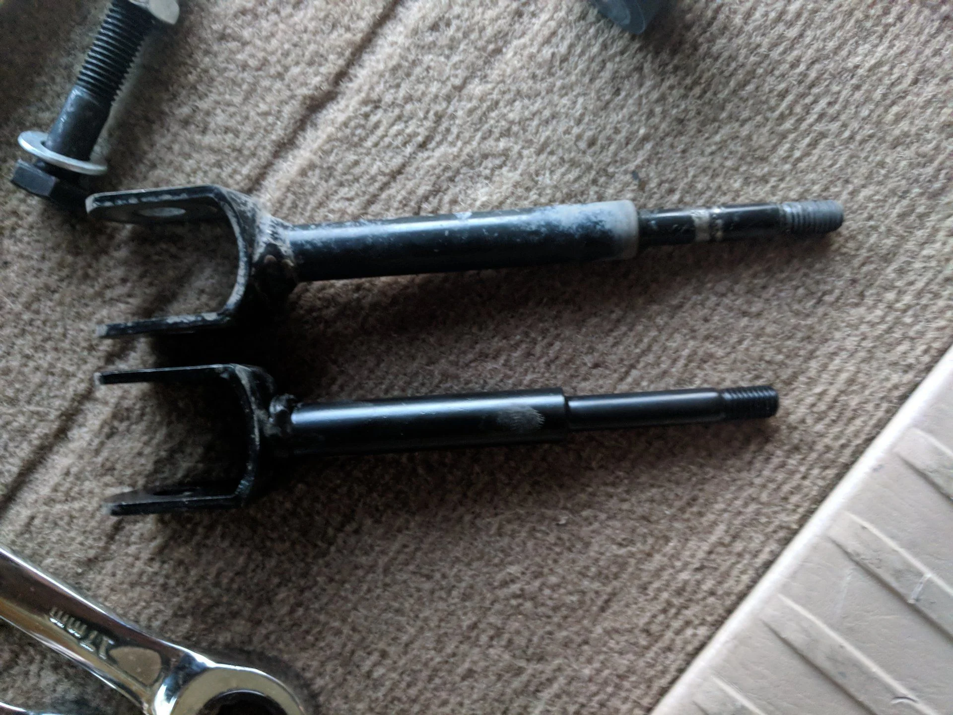

Anyways, spent some time on my back and replaced all of the bushings on the rear sway bar. Feels much tighter going around corners now. But the mysterious clanking is still there. I'll be inspecting skid plates and reading FAQs a little more deeply to diagnose/fix this issue.
I ordered these end links from Amazon rather than OEM because they included all of the hardware and new end links for only about $7 more total so I said why not... Big mistake. The end links were about 1 inch shorter and the bushings didn't seem to be the same quality as OEM. I'm sure they will be fine for many miles going forward, but lesson learned.

Thanks @knewstance I was quoted $600 by my local upholstery shop just for the install if I supplied the leather. I have $20 for pliers and spare time. Looks like it's time to learn something new
Awesome! Just yank out that passenger seat and get to work! I'm here to answer questions along the way.

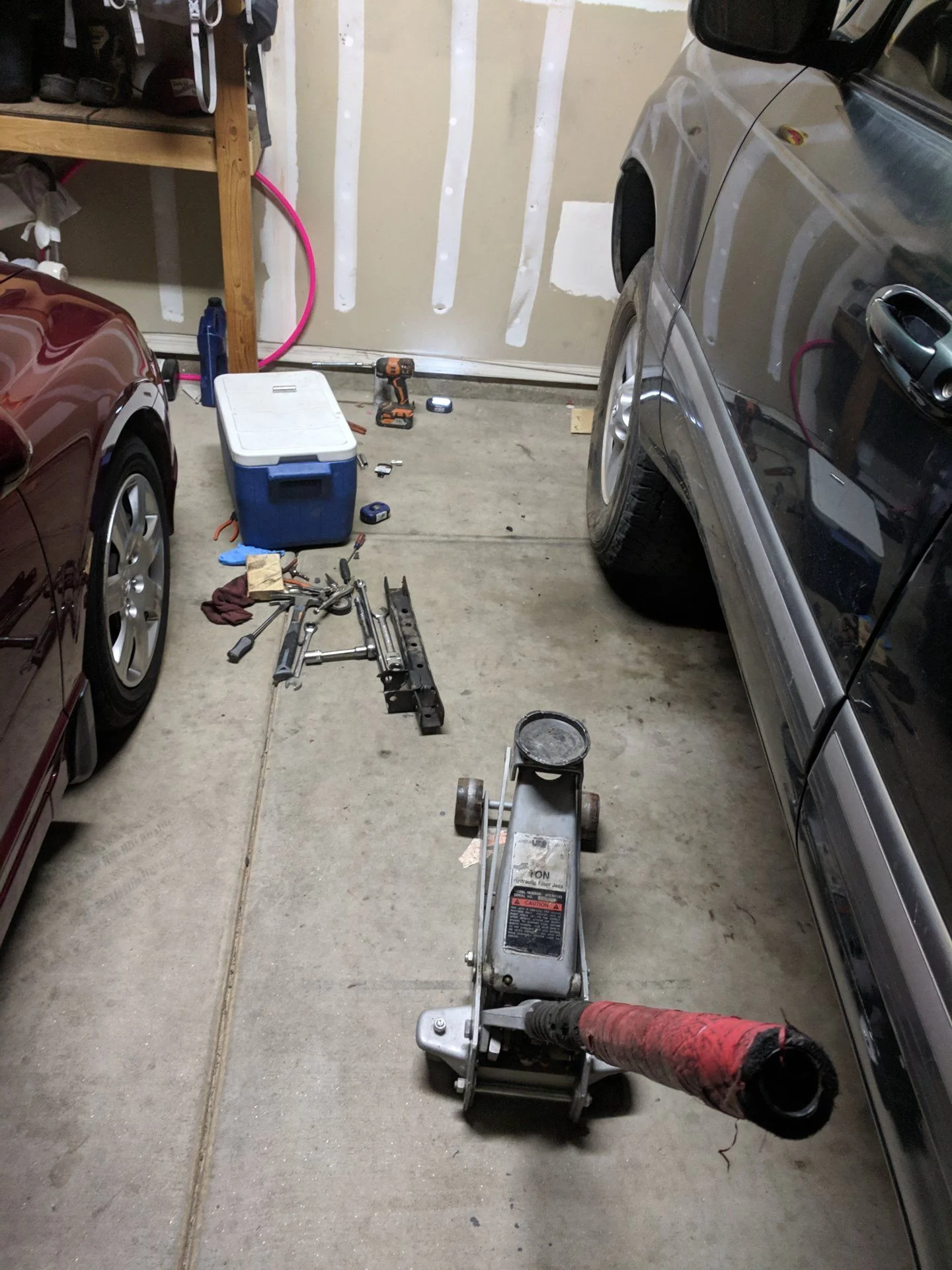

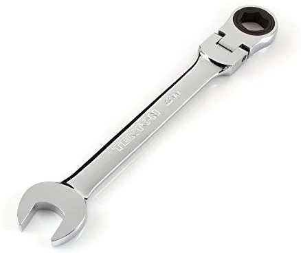

Working on the lift install this weekend. Got part way through one shock and decided that I would have a lot easier time if I had the ratcheting flex head 22mm wrench. I'll get the Trail Tailor diff drop installrd tomorrow then everything else once the wrench gets here.
My little helper even knows where the center caps go!

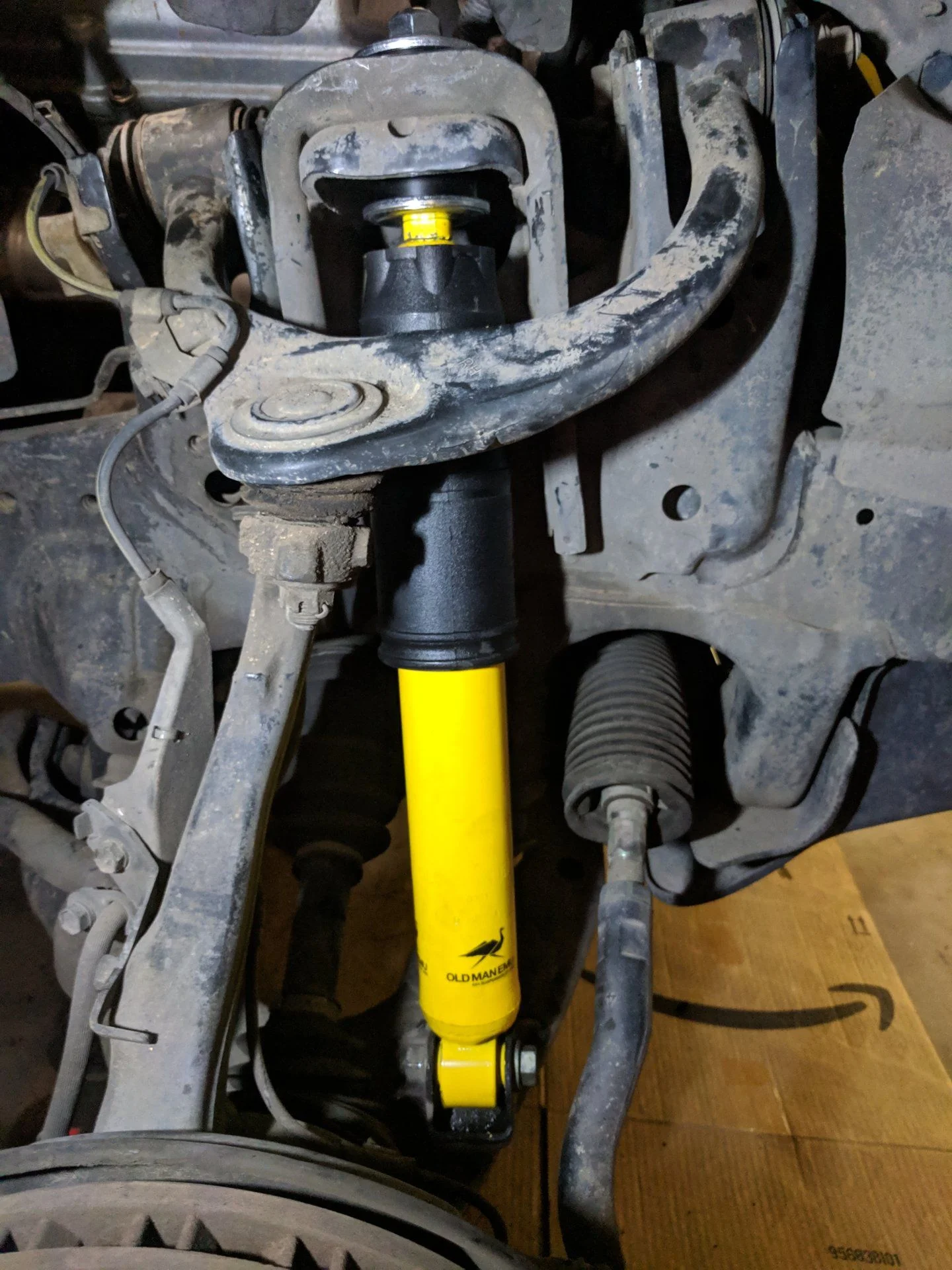

Installed the other front shock and Trail Tailor diff drop tonight. Completion of the lift is approaching!
What a mess... I had to fight with the top nut on both of the shocks. Ended up pulling out the upper bushings piece by piece to release the tension on the nut. Otherwise, my vise grips would just spin free on the shock body when I started trying to turn the nut. This method ended up pretty well vs the alternatives of torching or a nut splitter!
