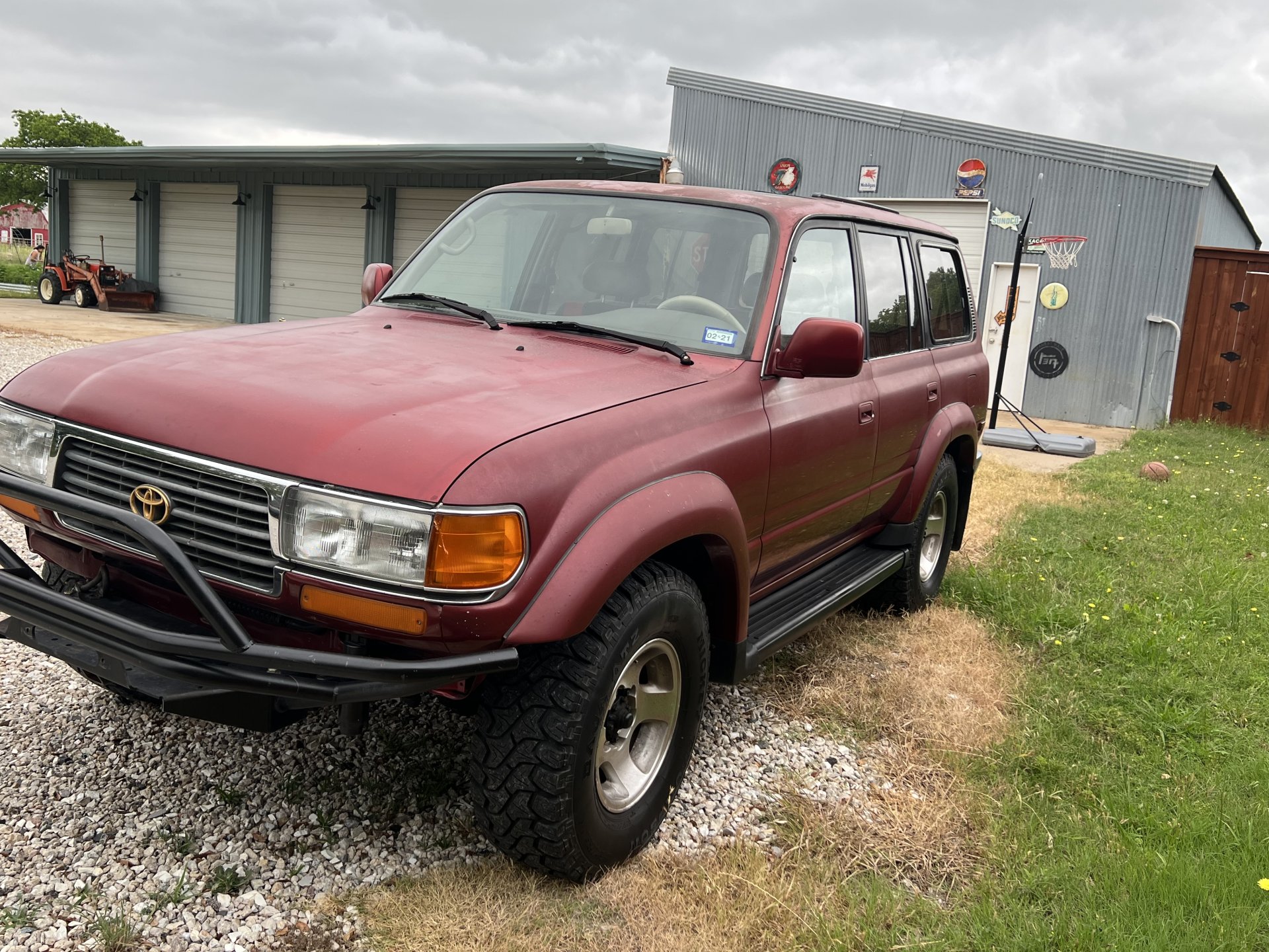

Have not had much time to post on things of my own. Been busy with the boys (@SipLife and @Cowboy45) projects. Thought I would get it started. Rig is a 97 triple locked 80. 177k miles. Bone stock except for front bumper. Everything works. No rust. Clear blue title.
Bought it in San Antonio. Owner had a ton of receipts. Only issue was oil leaks from the common areas (front main seal, power steering pump cover, dizzy oring). Drove it to DFW topping it off every 100 miles🥴. It got me home. Nice rust proofing for sure.It’s a good start.

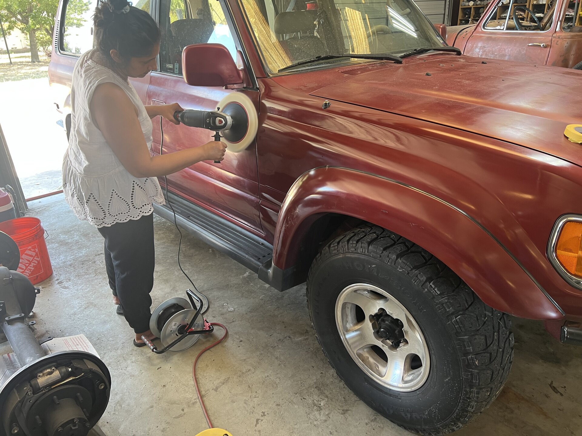

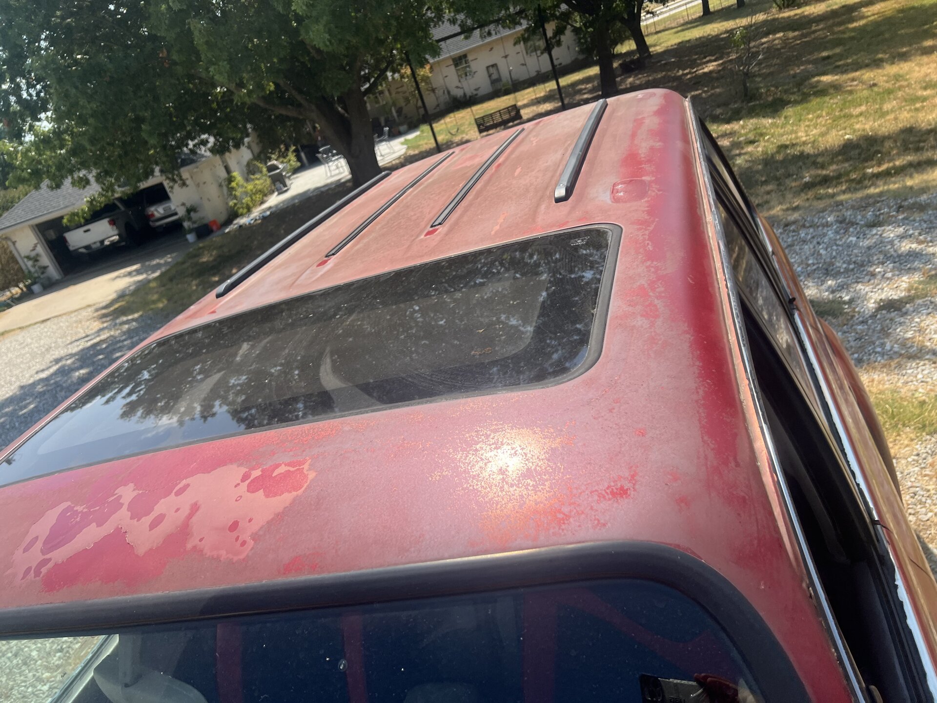

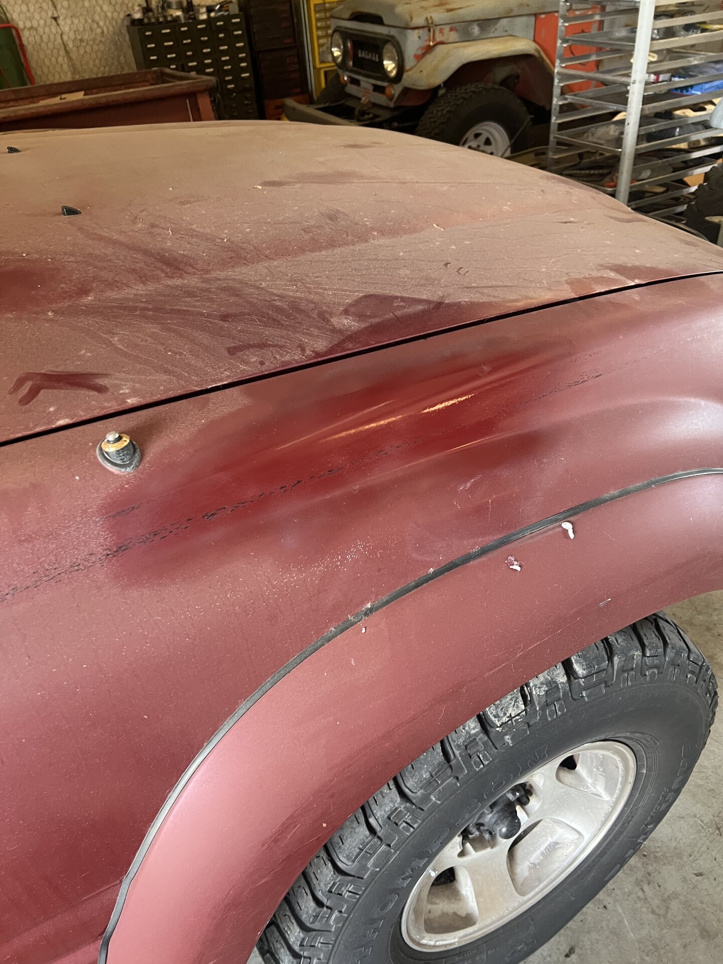

Took a bigger bite at it today. Rubbing compound and wool pad followed by Griots.:princess: Also took to it. Its a good first cut. Going to try Graphene polish tomorrow.
Getting better. Its an art. Tried the maguires cutting compound and finishing polish. Tried various pads (wool, foam). Kept getting bake in of compound and polish. Looked splotchy. Also tried high end graphene infused stuff, no joy. Eventually went back to simple rubbing compound by hand and elbow grease to prevent “bake in” of compound. Then waxed by hand as well. No splotches. Deeper richness.
Good for now. Hood and roof will need to be painted. Rest will work for my needs.

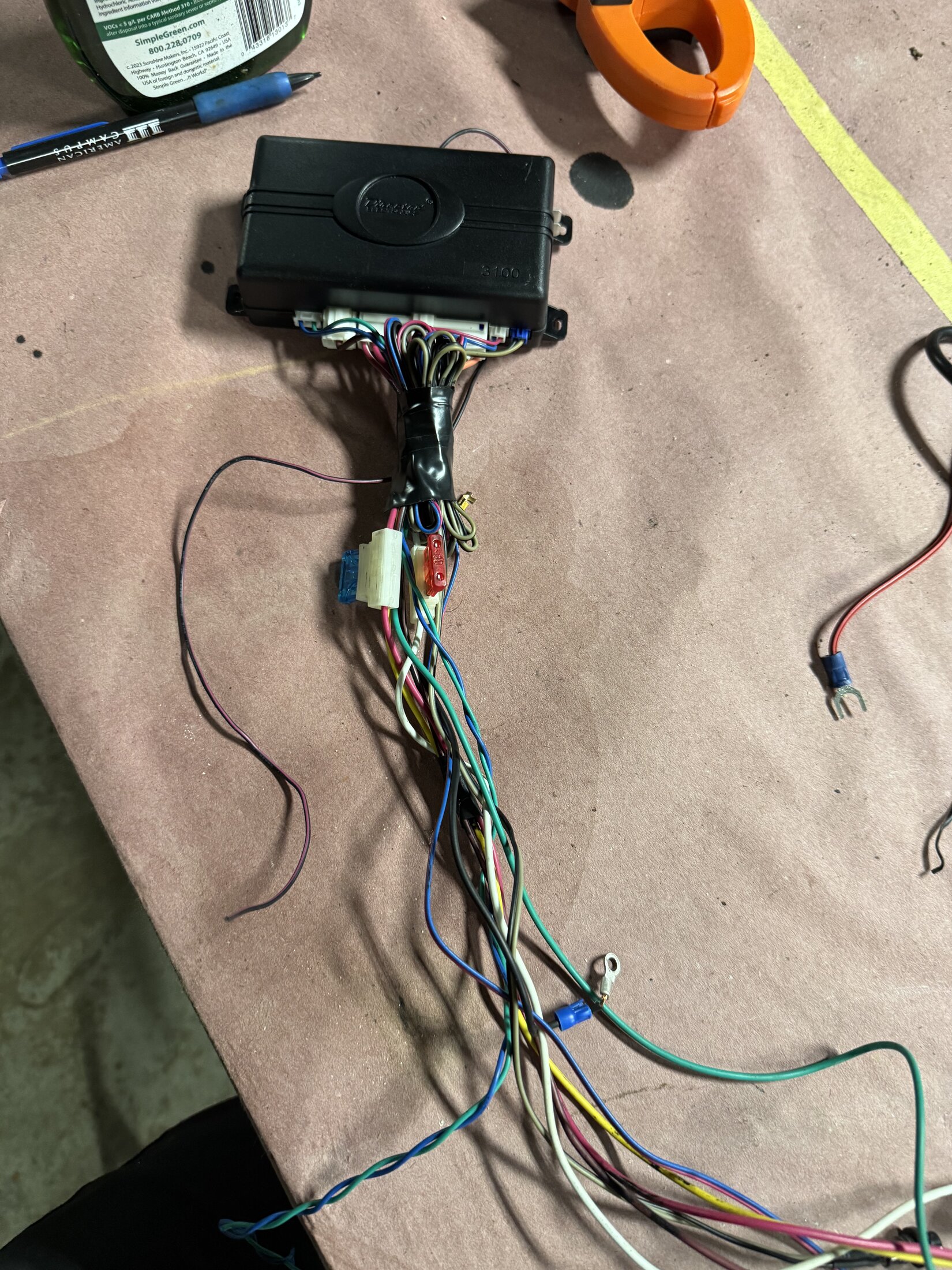

Its been a minute. Trying to work small things in between other projects as I wait for parts. Brutus has had a nasty aftermarket alarm that has been causing havoc. Keeps going off and jacking with the main ign relay and fuel pump relay. Tried to start. No CEL. Found IGN fuse popped while on battery chargw. Restored CEL. Tried to start, crank but no start. Ripped out the alarm system. Still no start. Have spark, it started with starter fluid. Fuel pump relay and main ign relay checked out. So yanked fuel pump. Alarm triggering relays might have burnt it out.It’s toast. Learning as I go about PO. Looks like they replaced fuel pump with after market “Kenzo” pump. New Denso OEM pump and filter en route from Partsouq.

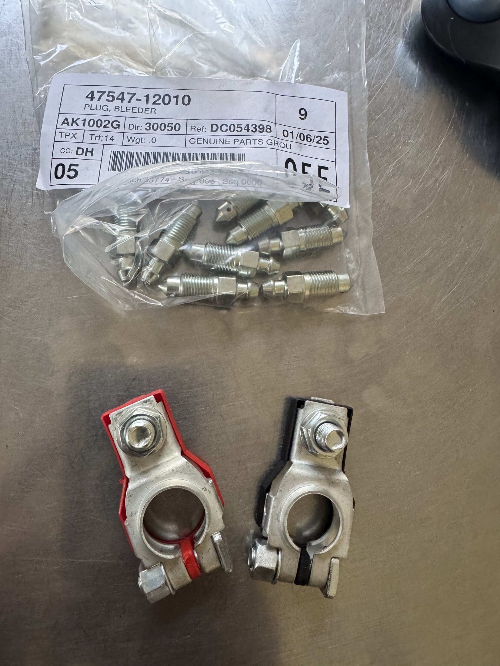

Needed new battery lugs. Brake bleeders were shot. Also got a power bleeder with toyota Master reservoir adapter. Trying to get brakes sorted, then oil leaks (dizzy and oil pump)

Yanked the security system out of the truck. Still no joy.
