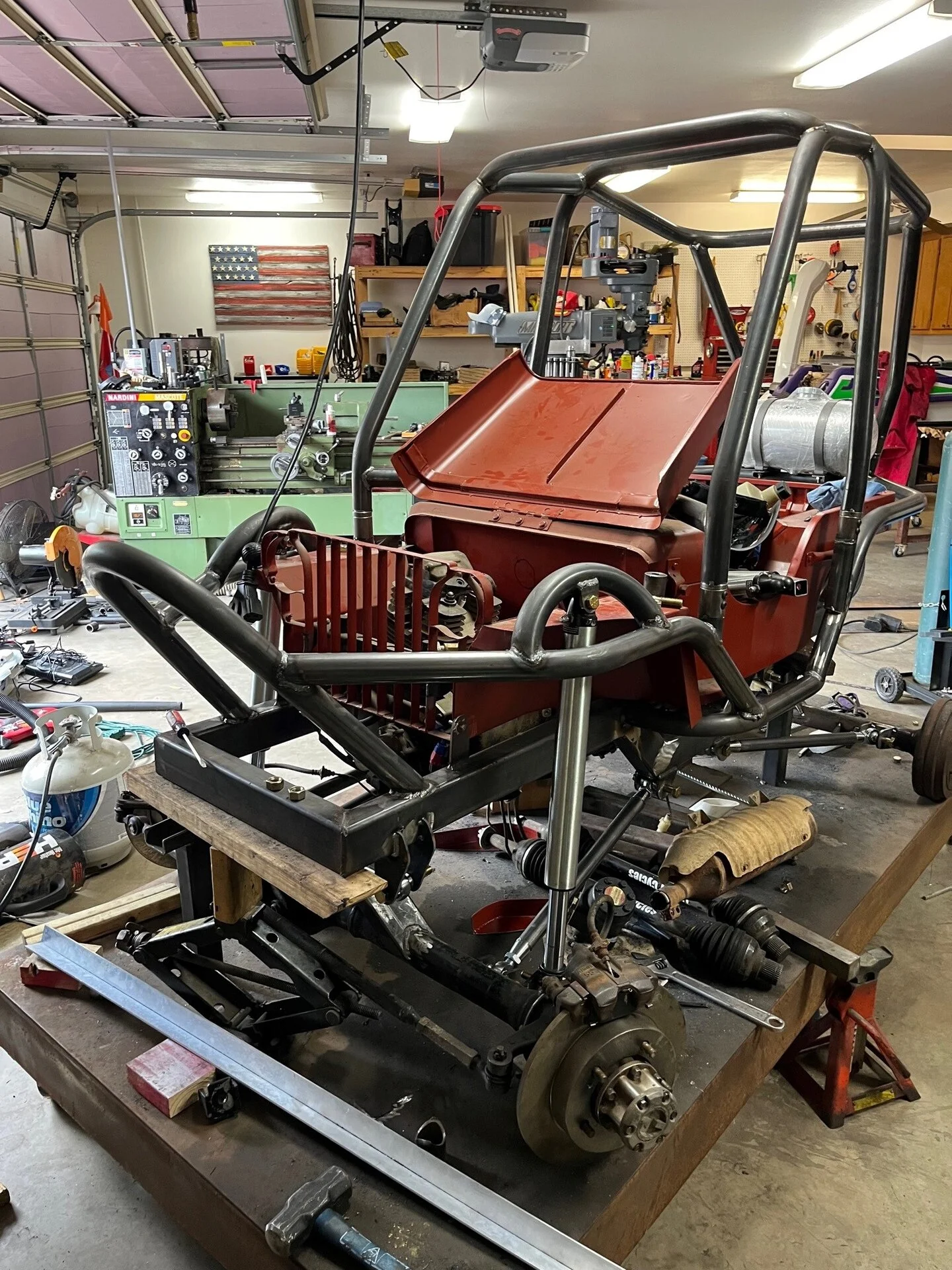

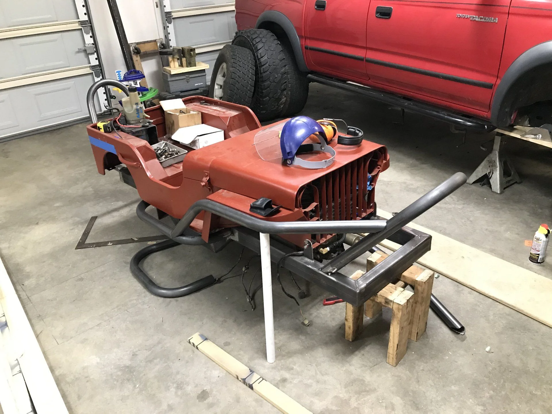

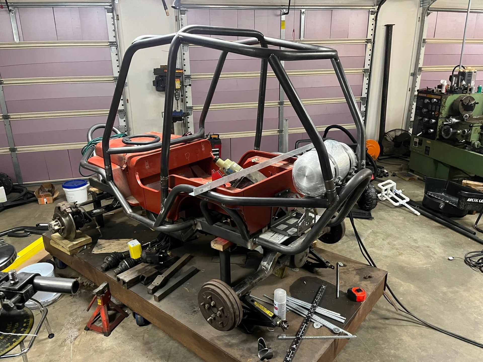

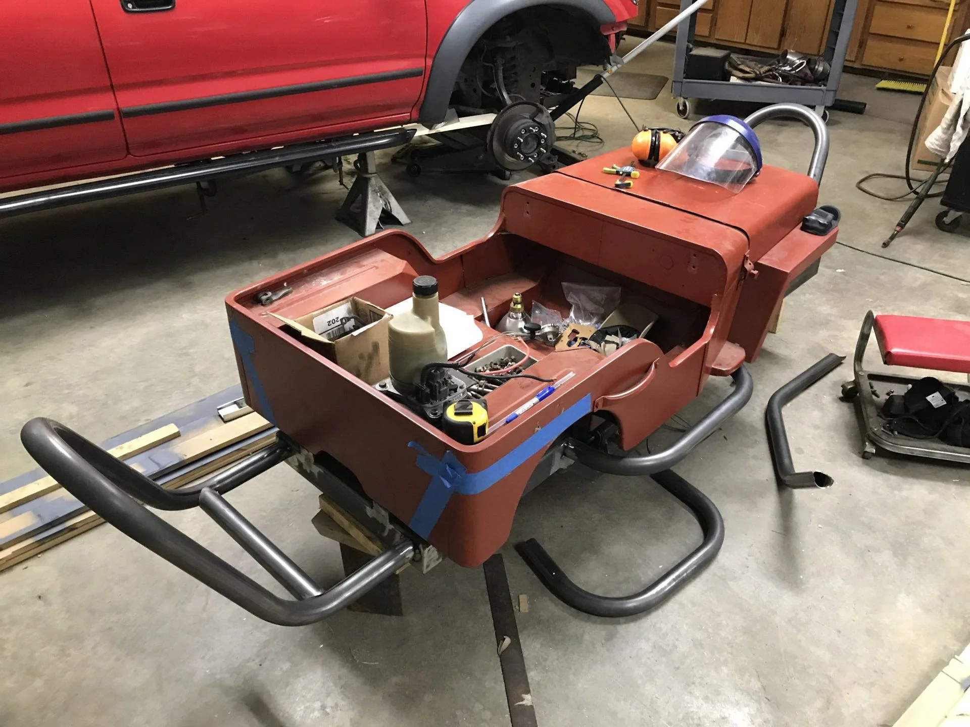

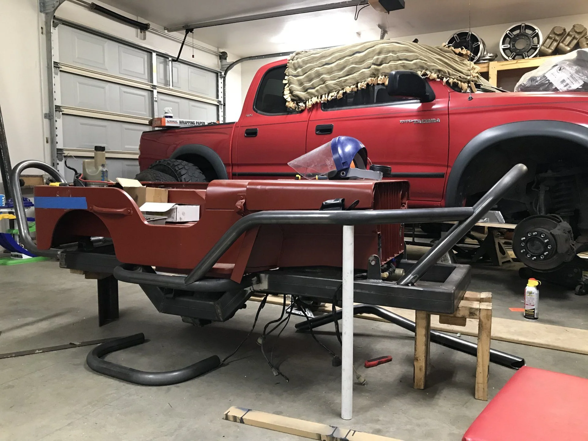

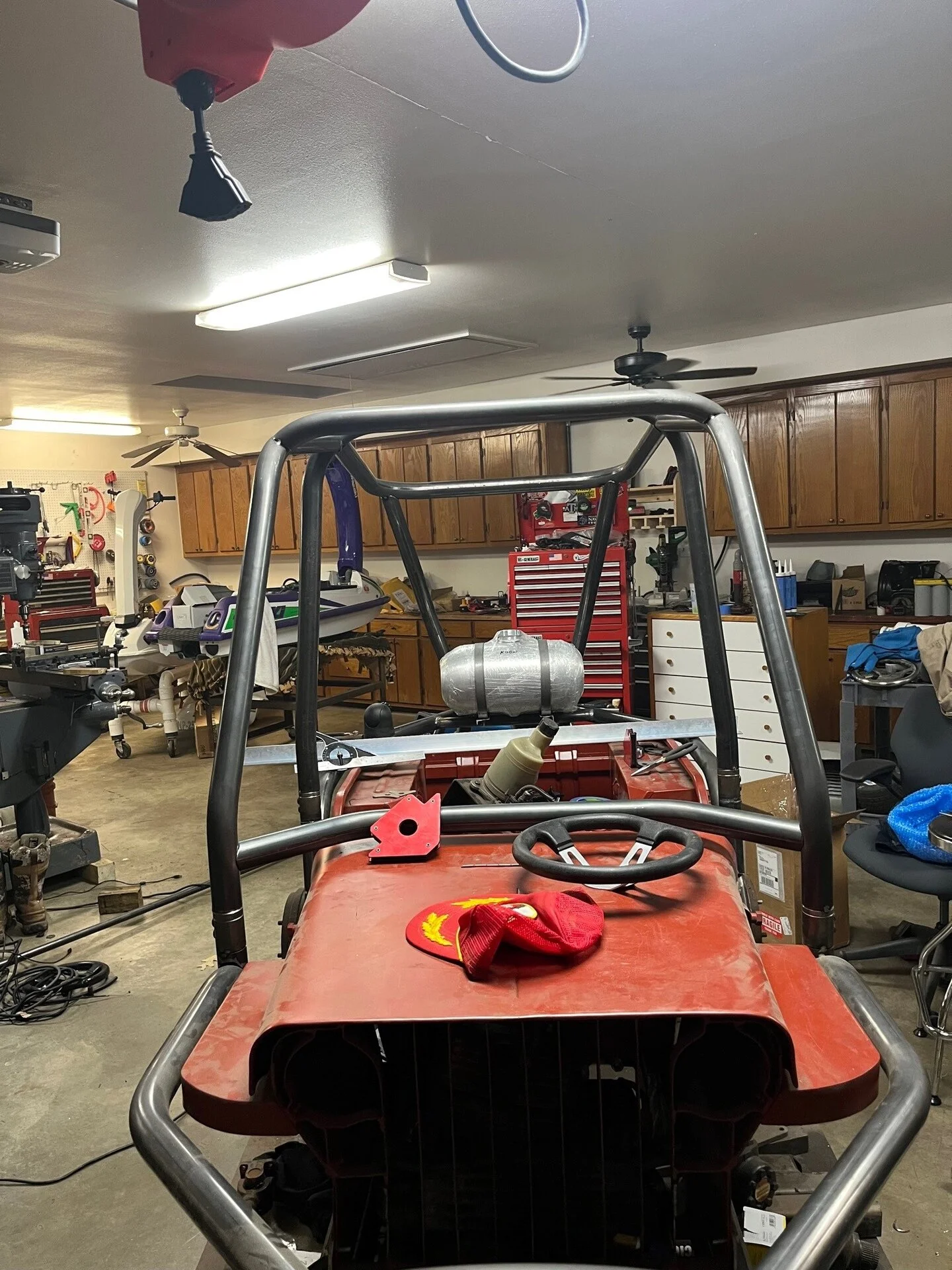

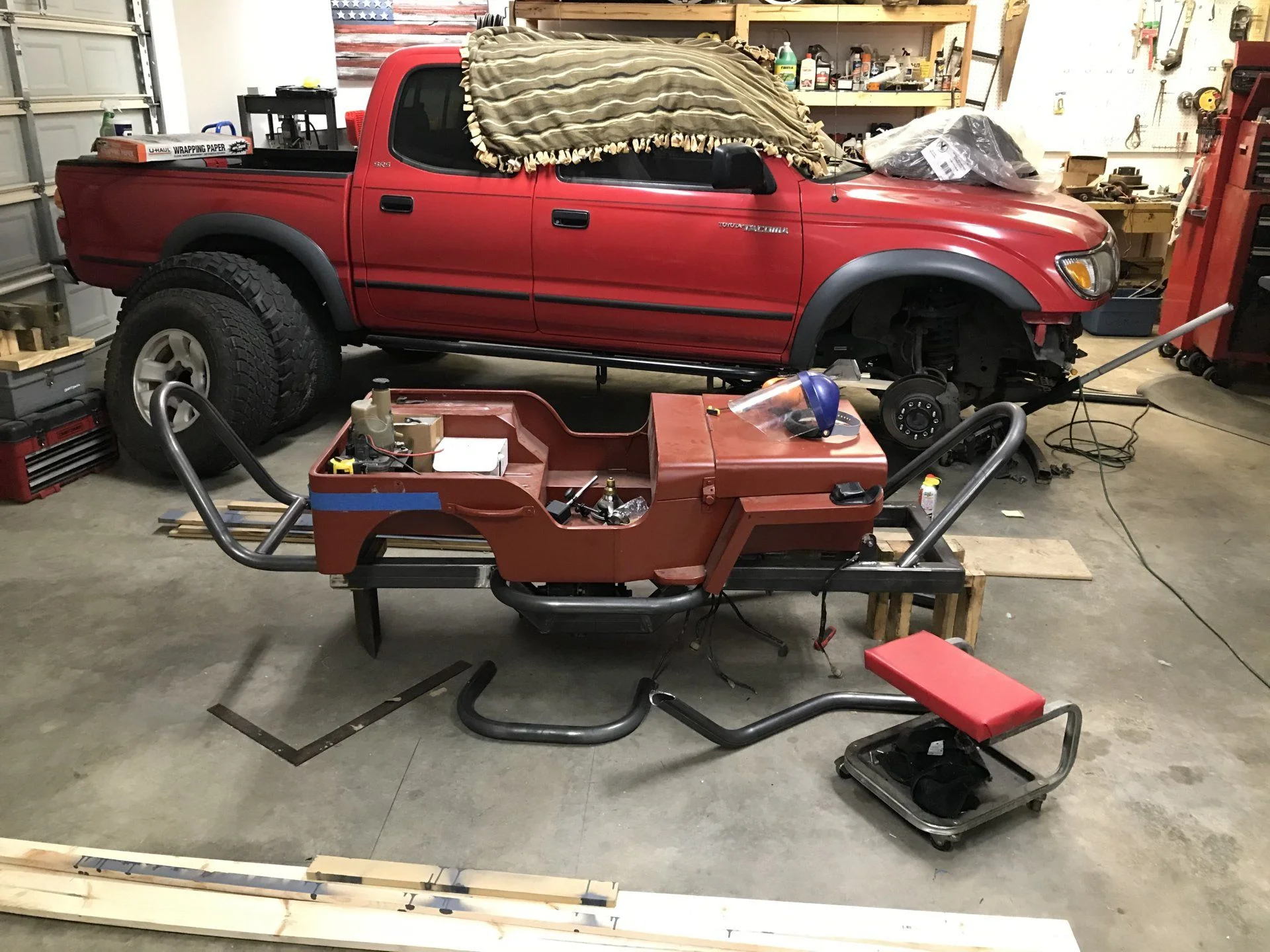

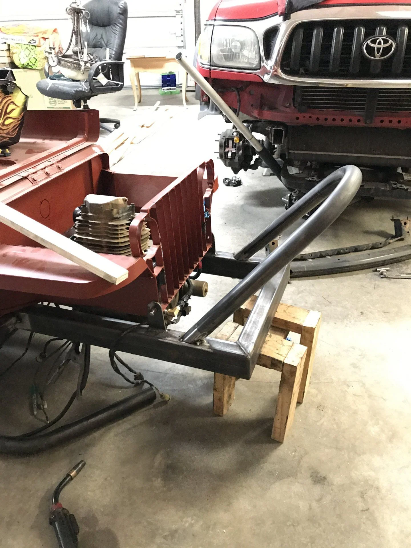

I started building on the exo-cage for the little buggy for my son. 1-3/4" .120 wall tubing for the majority of it. Trying to get 2-3 tubes per week done so I can make slow but steady progress.

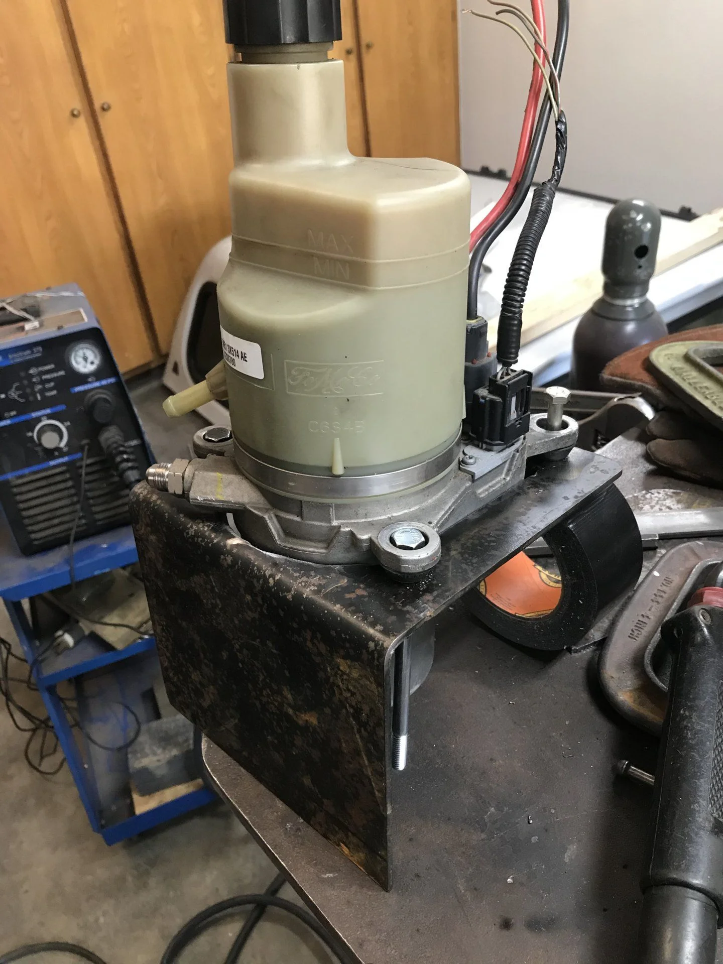

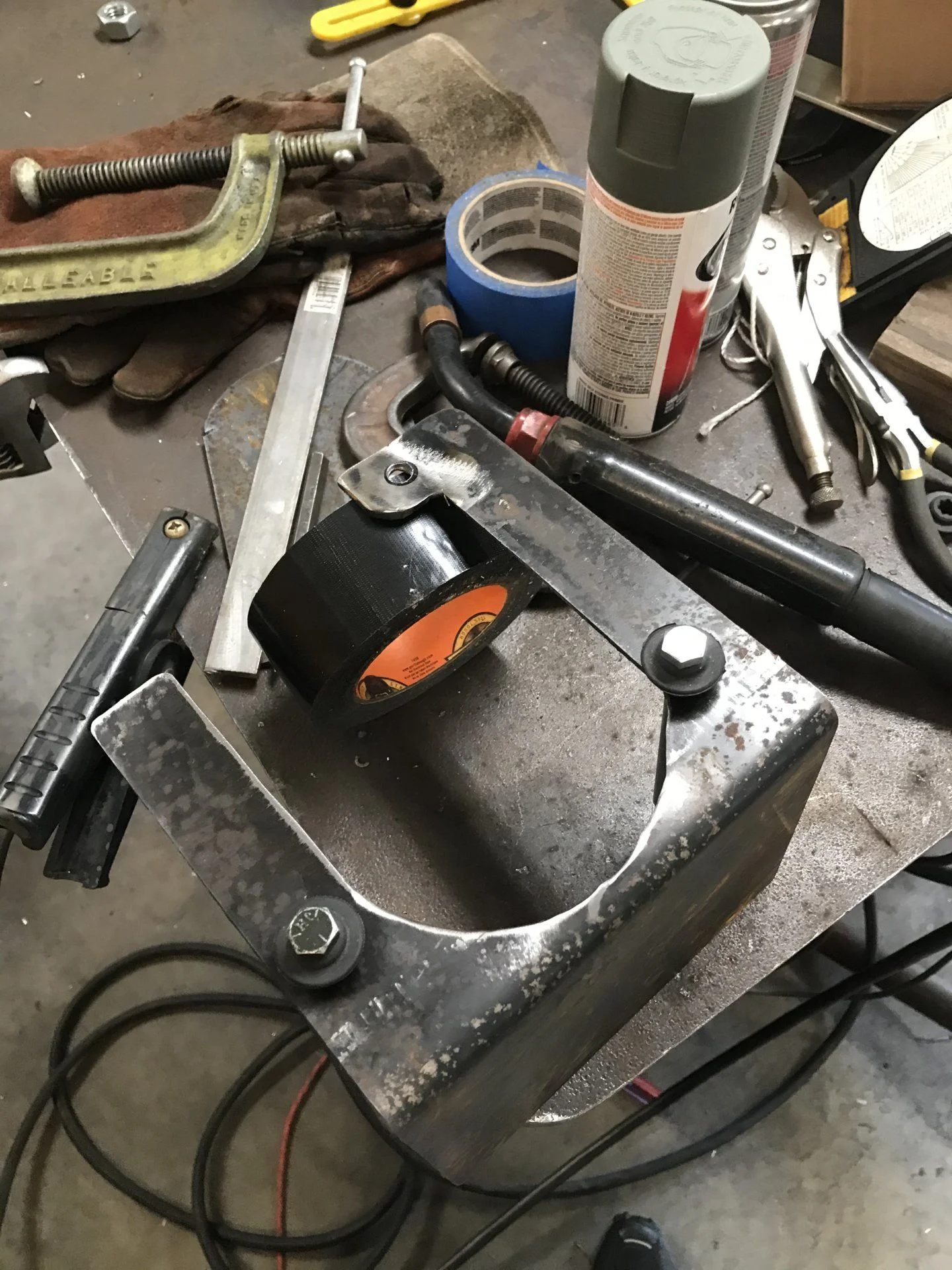

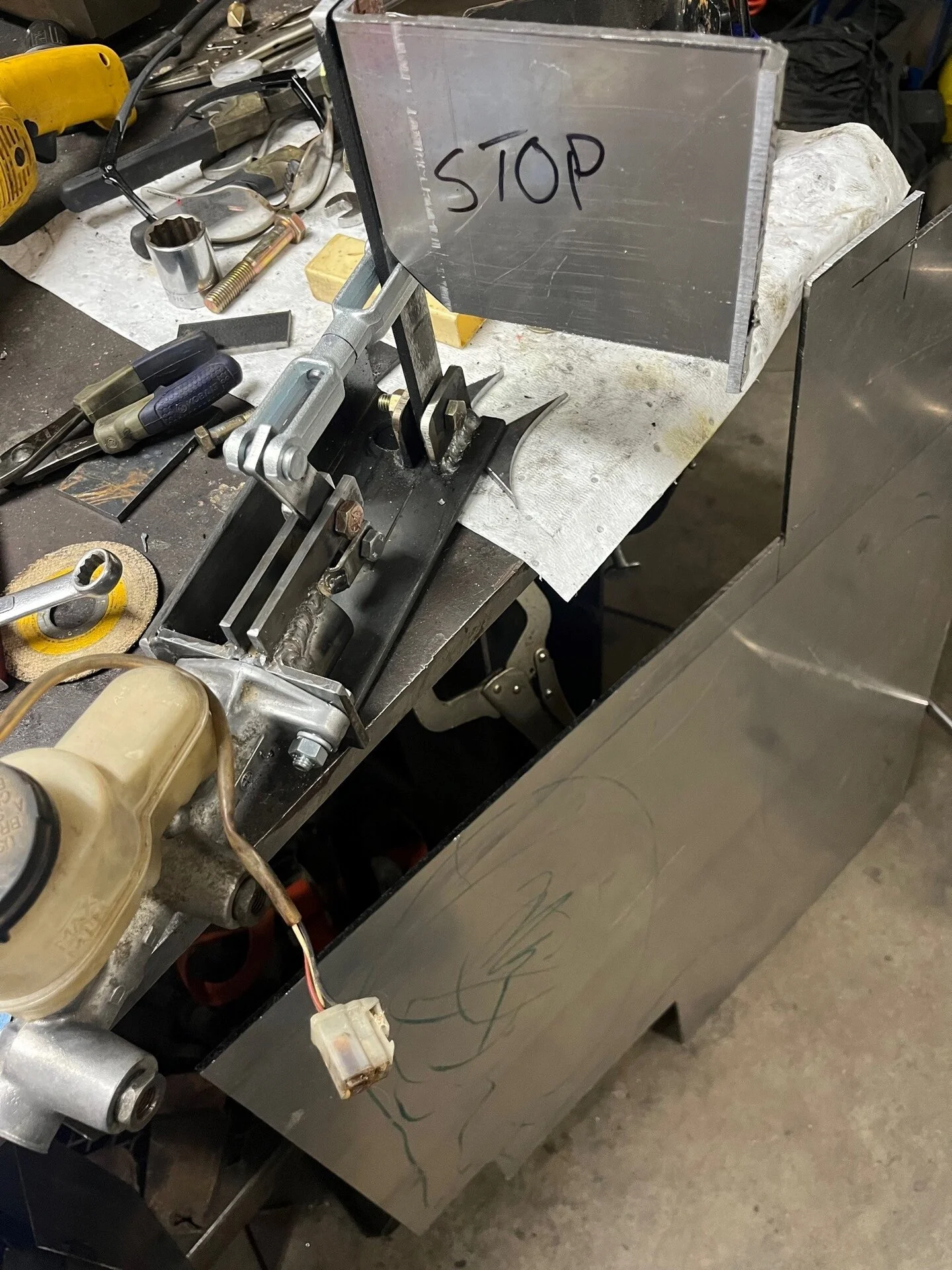

started on the bracket to mount the electric power steering pump. Original plan was to go under the hood somewhere, but I'm having trouble getting it all to fit. May end up having to mount it under the rear frame and have the fill spout come through the flow behind the seat.

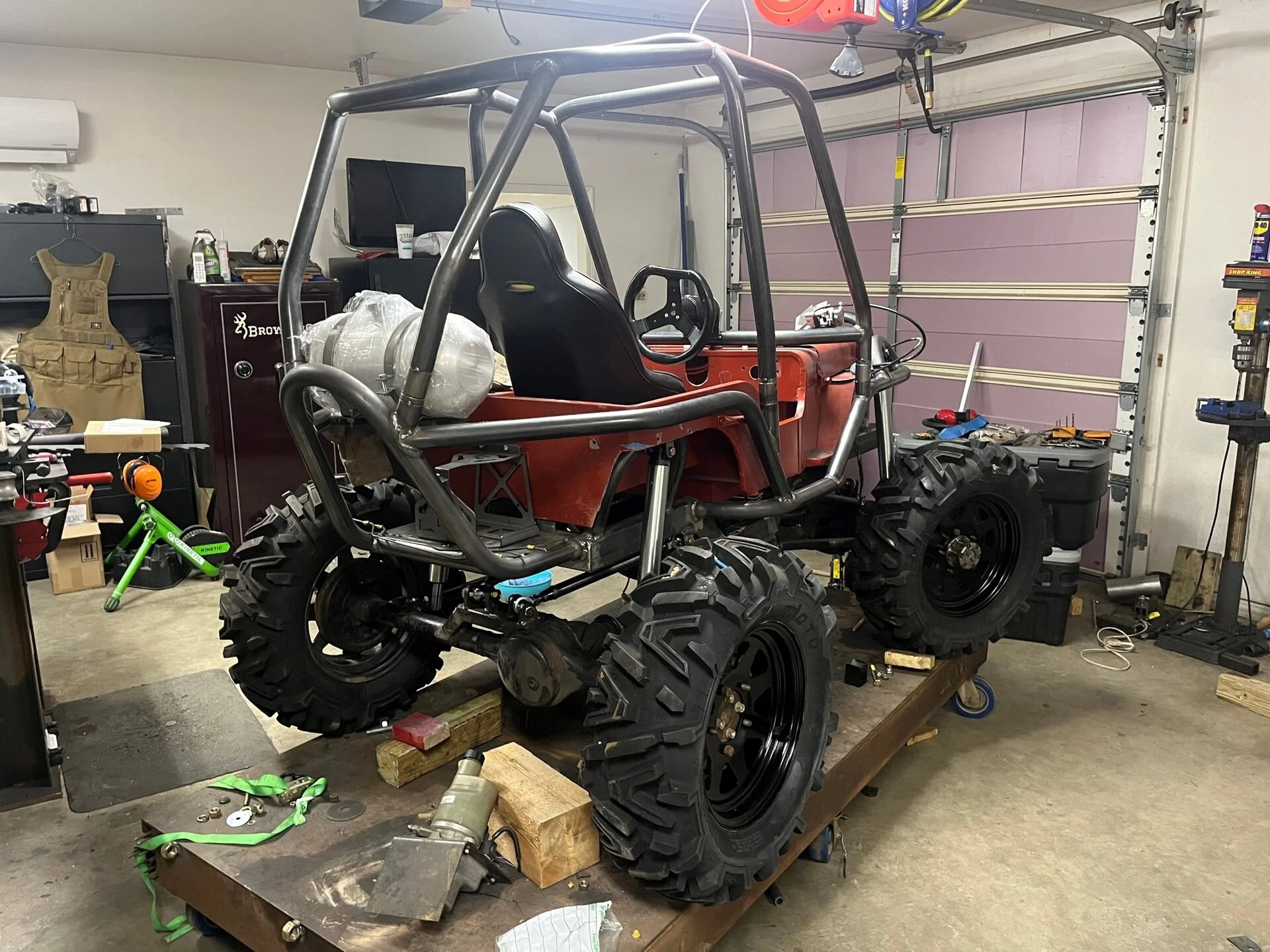

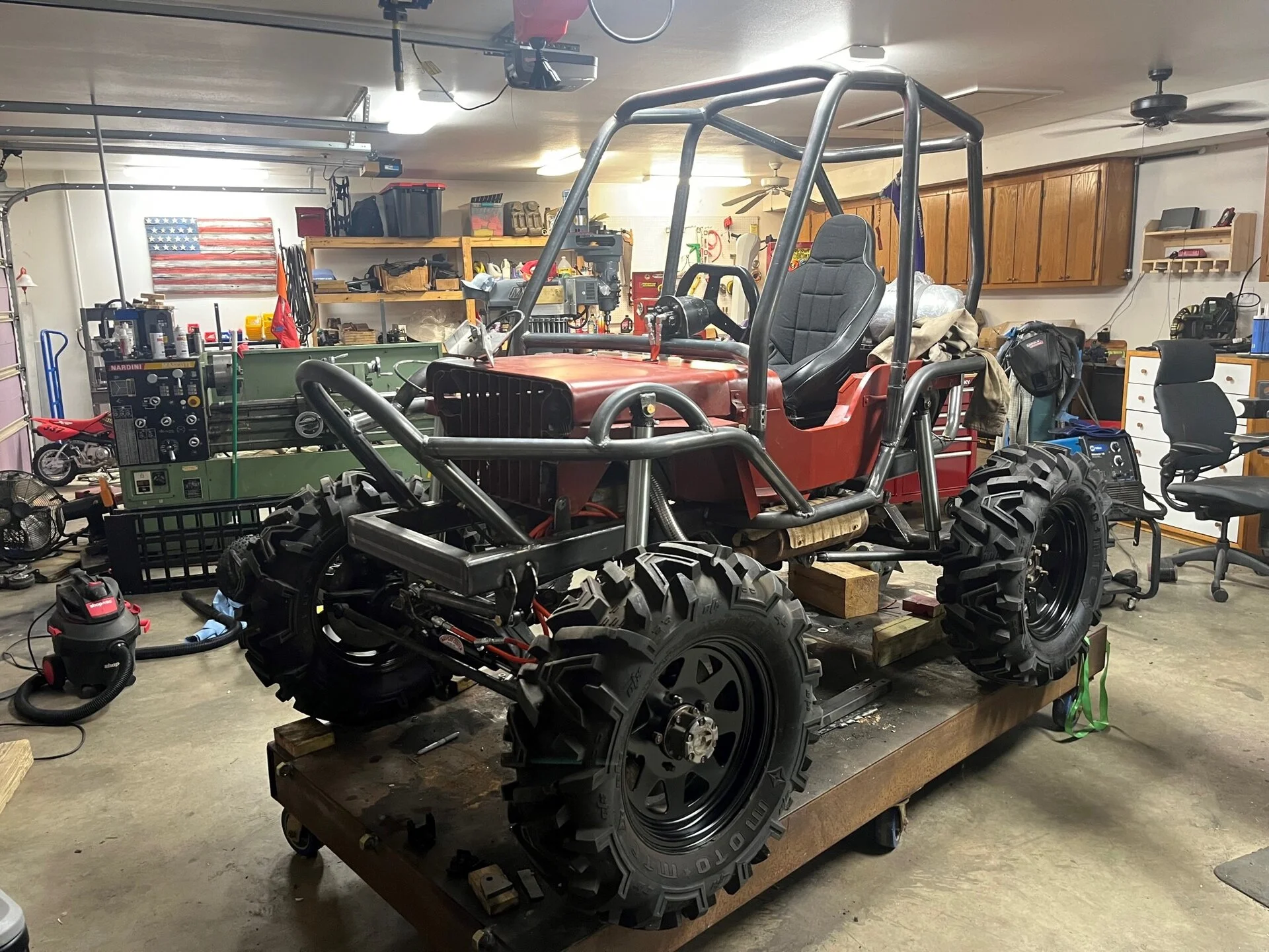

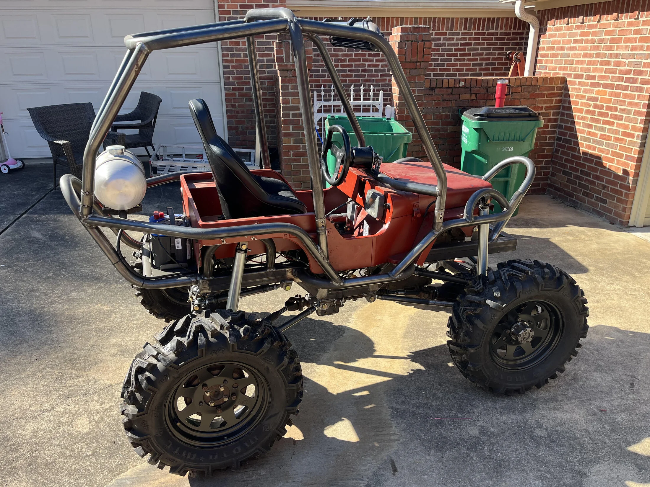

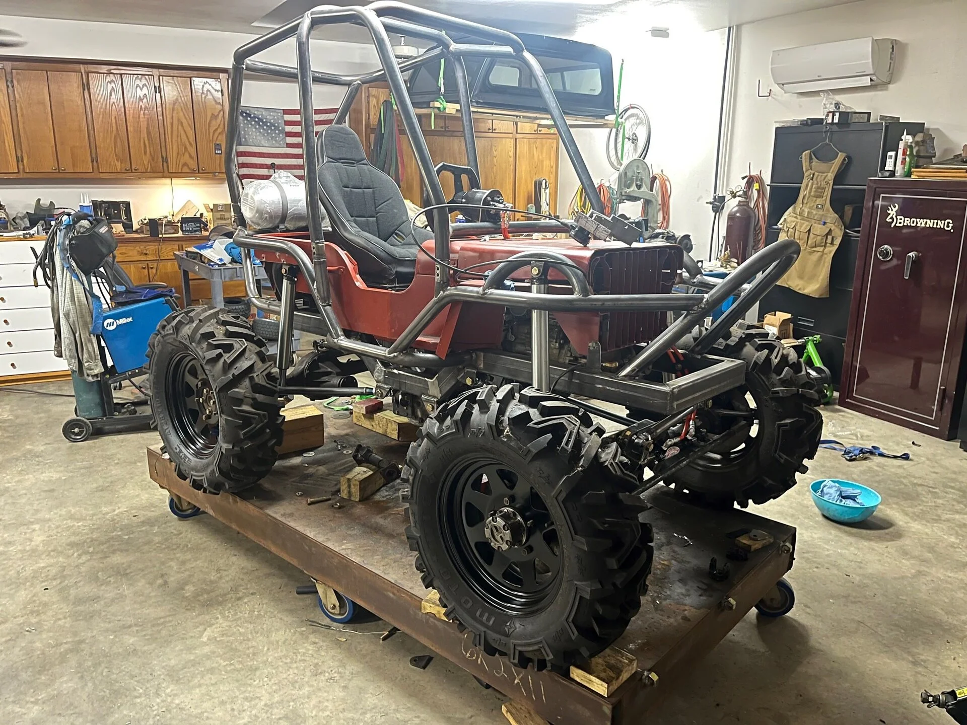

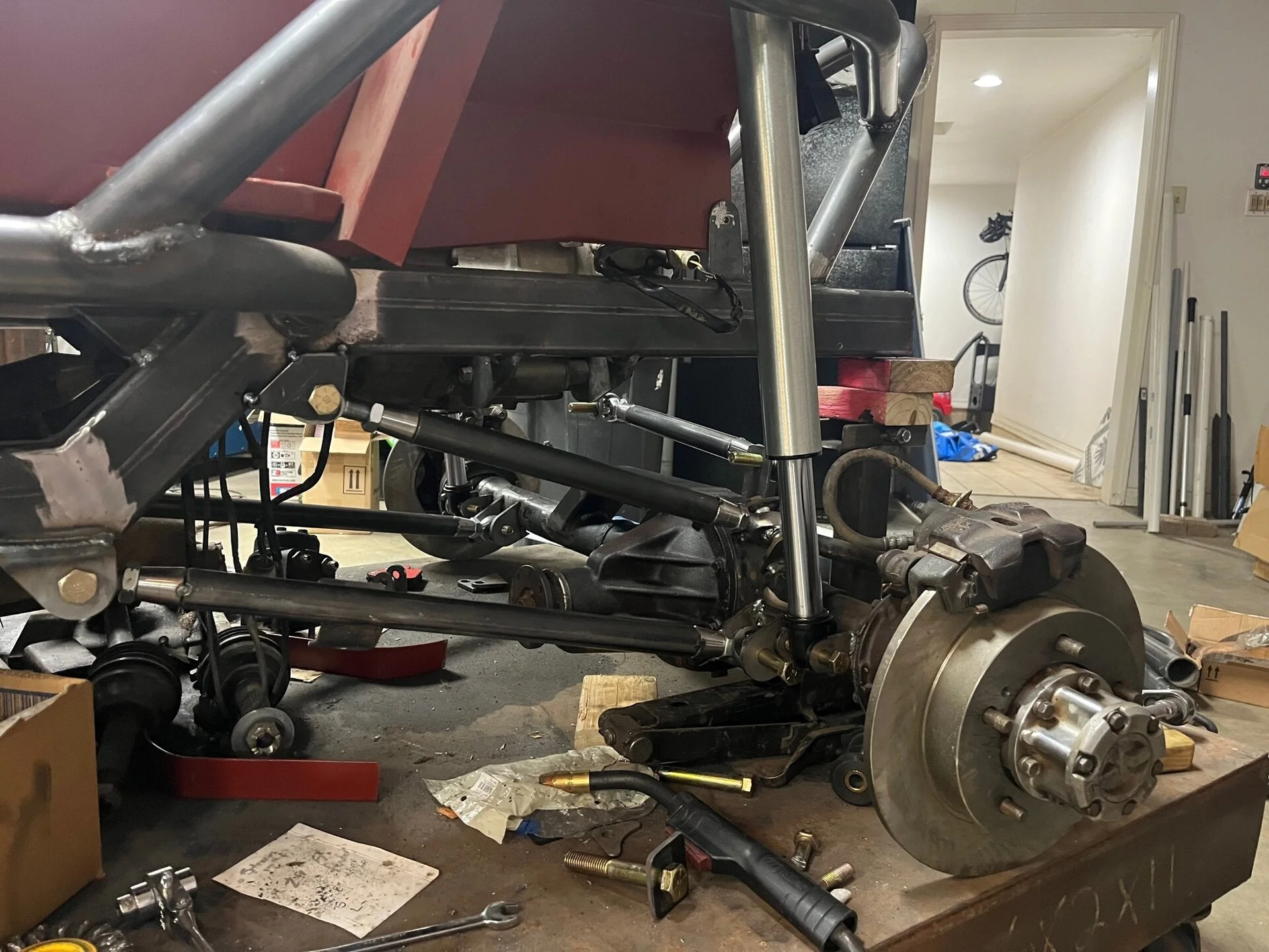

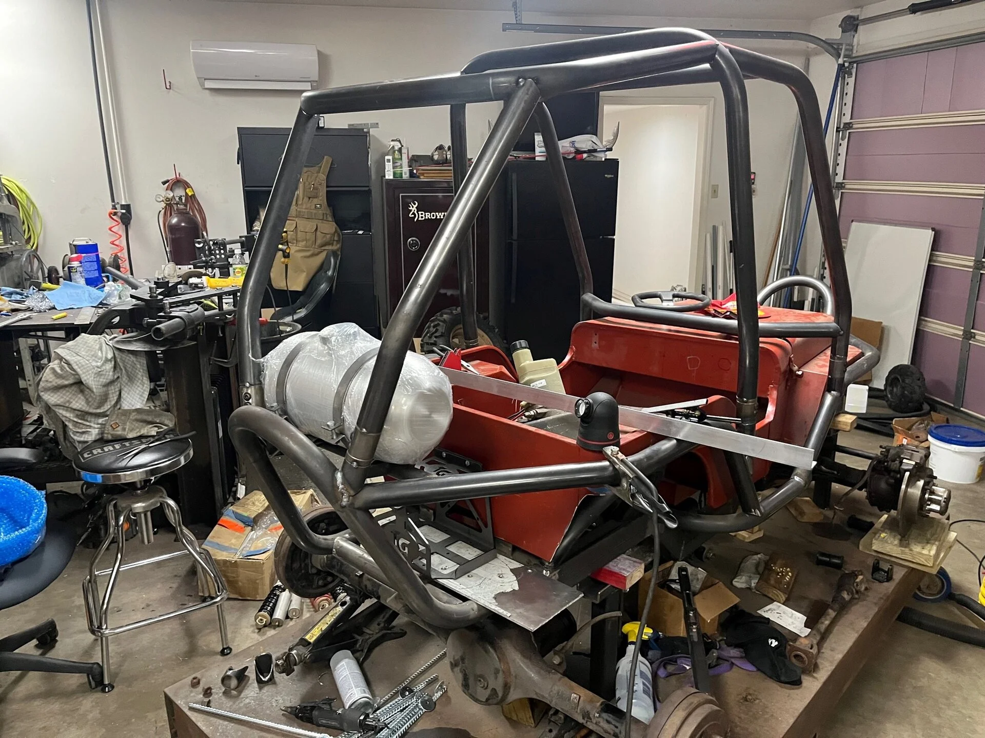

Been a while since the last update - only a few years.... Progress has been made, but slow. Cage is complete. Suspension parts were cut out and the 4 link rear and 3 link front is complete. Working on exhaust.
Updates:
Steering - Used a boat hydraulic steering help (1.7 cu-in/rev) and a 1" x 6" hydraulic ram for steering - works well
Tires/Wheels - 28x10x15 Moto tires from a mule on 15" x 7.5" wheels.
All suspension brackets and links welded up.
Brake lines made and will install this week.

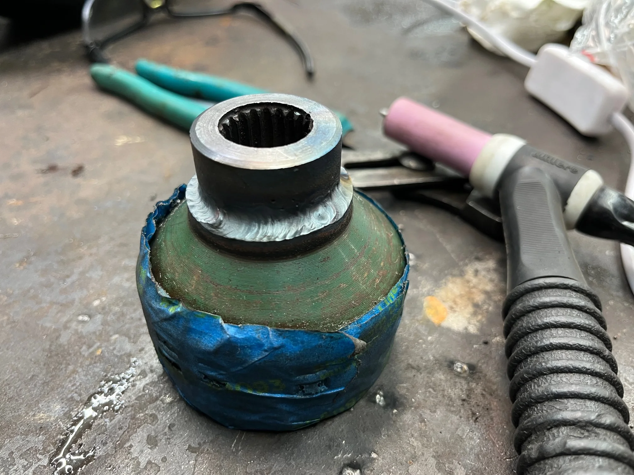

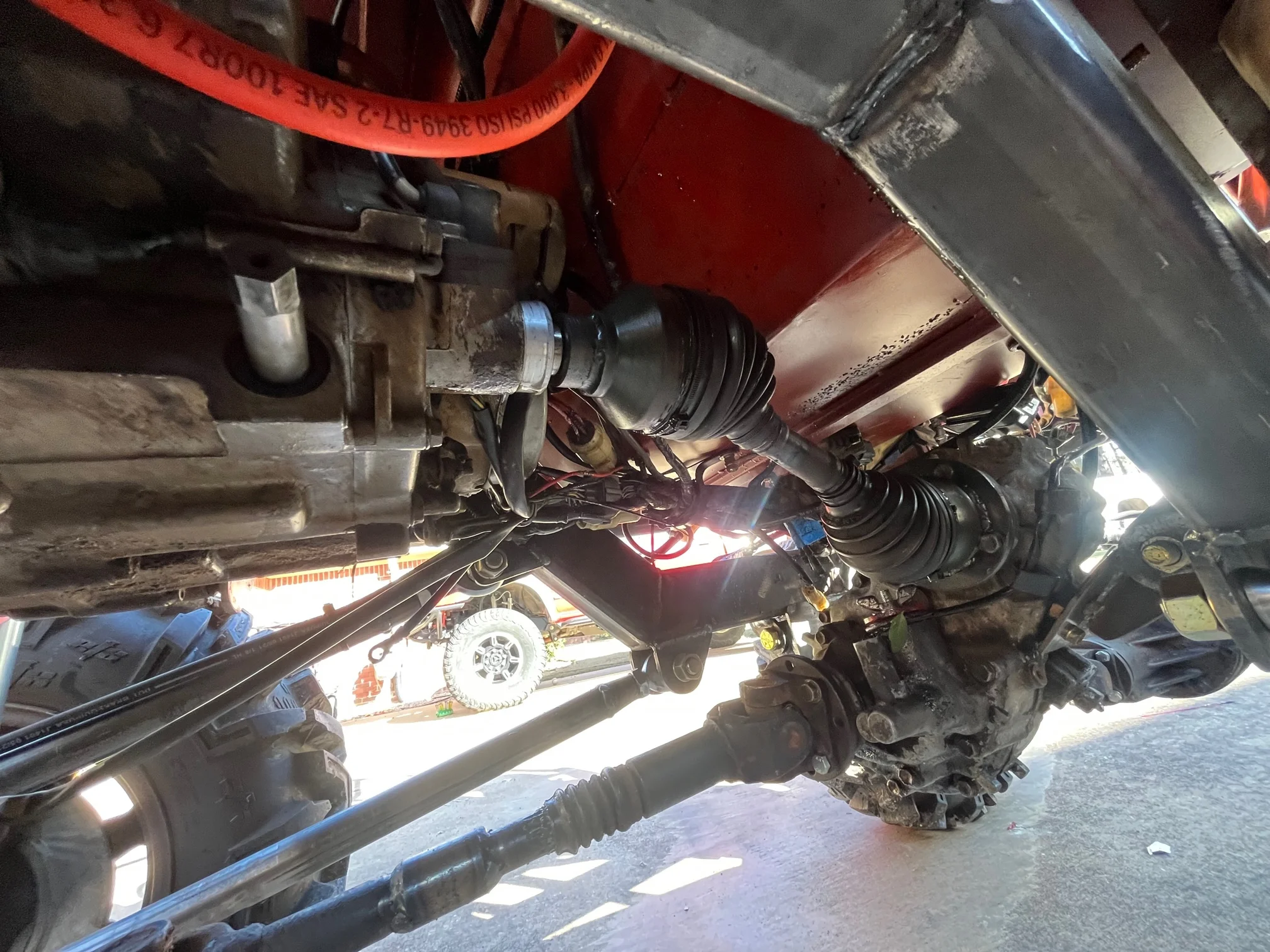

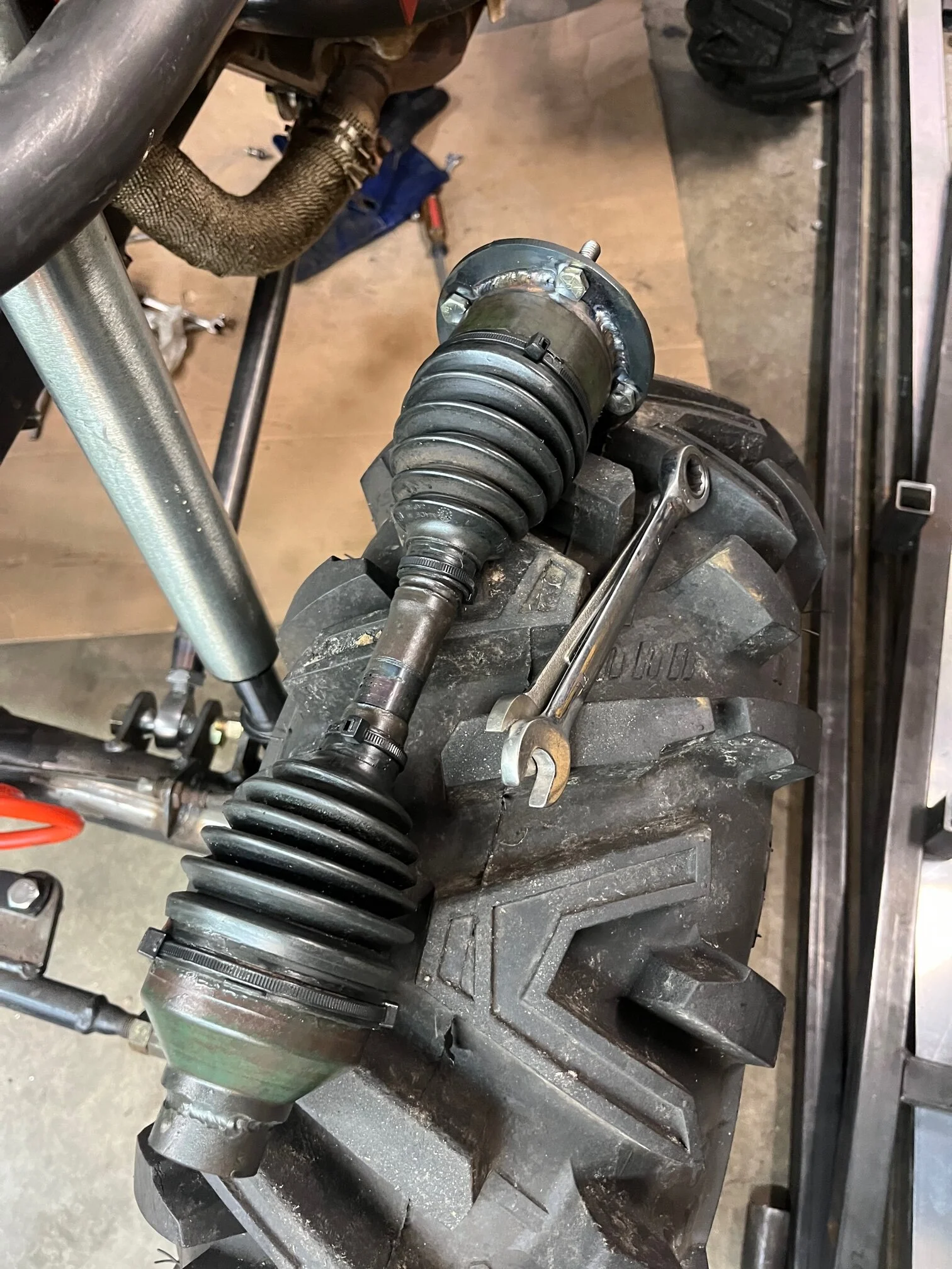

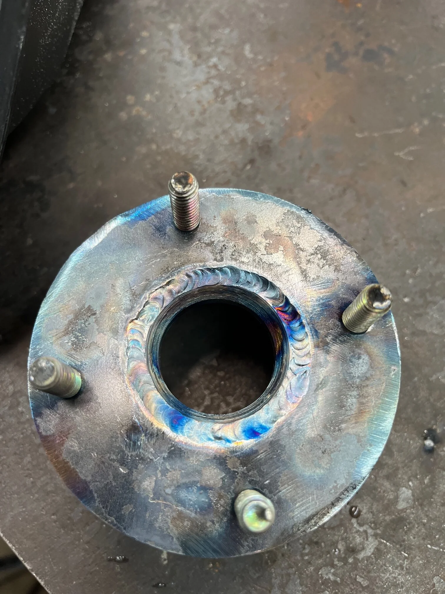

had to remake the drive shaft between the engine and transfer case. I used a front axle from a polaris rzr and had to make custom ends for it.
