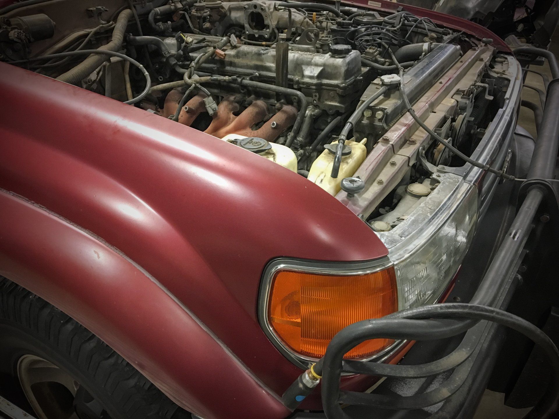

I just picked up @landonridge's FJZ80 with a blown headgasket and have jumped right into the R&R - and am amazed at how convoluted it is to pull this thing.
That said, I'm trying to search/research at night during my vacation next week (limited internet), but I'd appreciate any "while you're in there" wisdom from you guys in the interim - I'd love to not have to repeat this labor for not knowing ahead of time any tangential/opportunistic items that should be considered/addressed while I have access to them.
I'm looking at EGR deletion, for instance.
Thanks in advance for any guidance.
