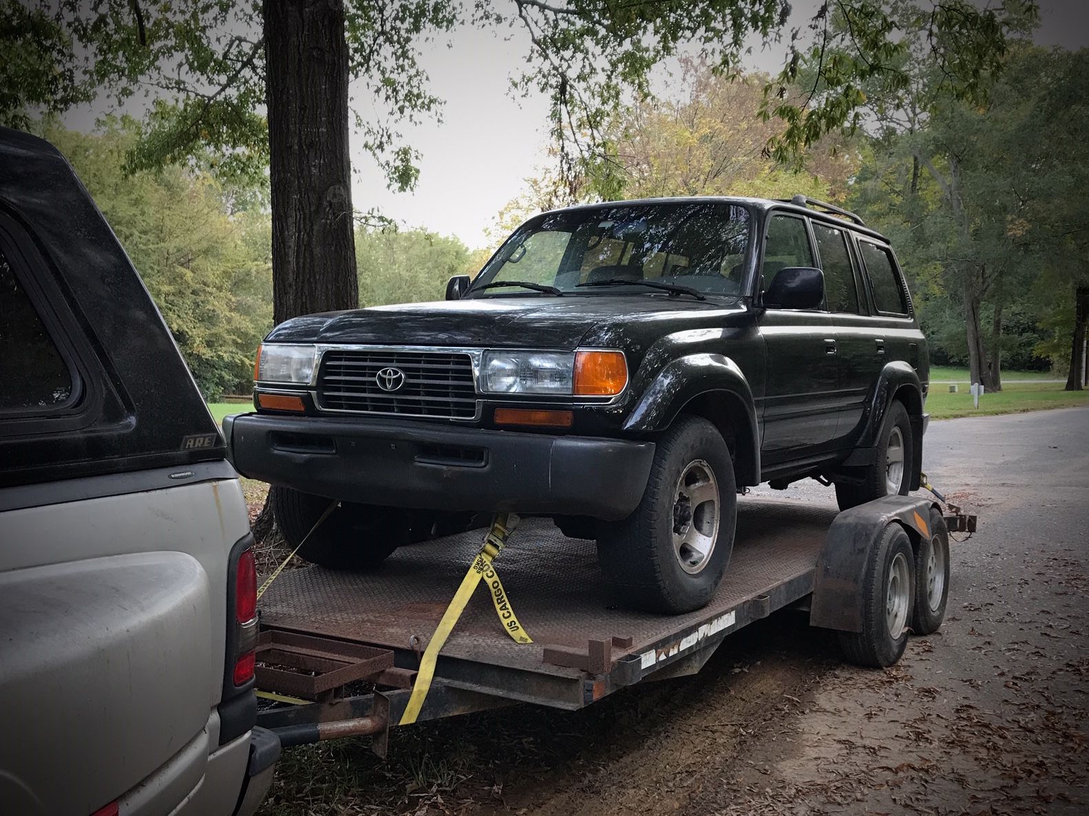

well, since my wife commandeered the red one, a black one followed me home Wednesday. 1996, locked, some rust (was in Minnesota at some point)

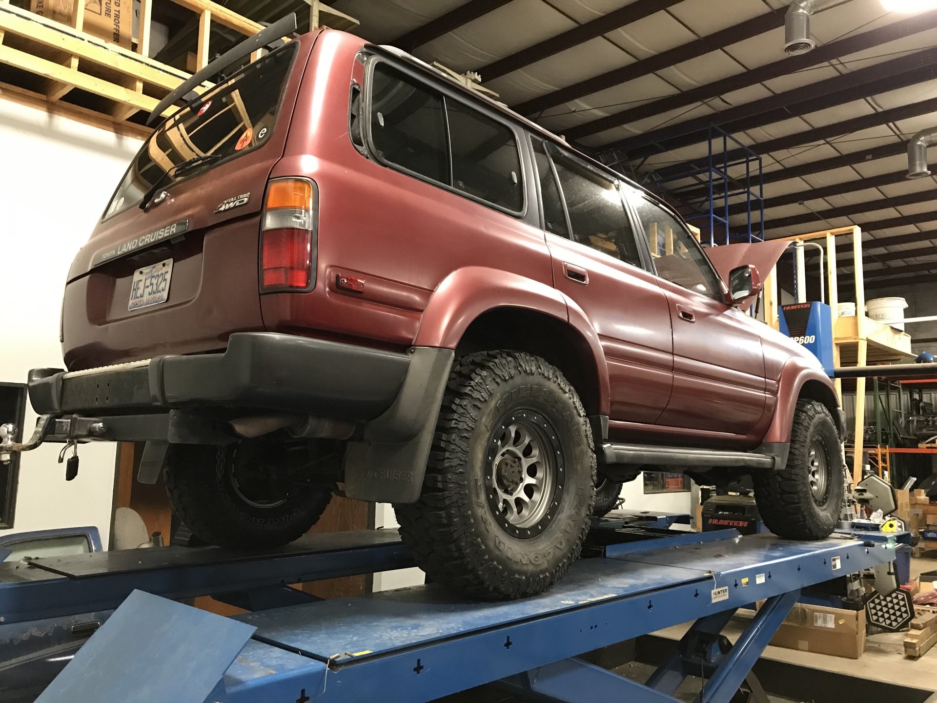

And more work on the Brick (the faded red '95) today, since we are taking it to the mountains for the weekend: finished up the radius arm bushings, replaced the master cylinder and bled 4 cans through the system to get clear, airless fluid at all 5 nipples (still have the s***ty squishy pedal - it HAS to be air trapped in the ABS pump manifold, right?), and pulled both driveshafts to replace the 3 universal joints that were still present. This stuff on top of the seat swap, driver's door panel repair, driver's door handle replacement (apparently I got the last red handle in the US), and visor swap.
Can you believe the Brick is the nicer of the two 80s? (the other one is crusty.) :rolleyes:
I'll button up the driveshafts early tomorrow morning, then we're off for the weekend, brakes be damned.

and today I finished some really deferred maintenance on the Brick.
  • Finally fixed the power steering leak (the supply hose from the reservoir wore a thin spot against another hose and wept under pressure (like most of us). Both were replaced.
  • Changed the oil (finally, after the overheating incident)
  • Tightened VERY loose front wheel bearings (got lucky - looked like everything was more or less recently serviced, but had loosened - hence my bookmarking threads today)
  • Installed Dobinson C59-220v/223v coils and IMS shocks (keeping my slinky kit for the black 80)
  • Panhard correction
  • SCS Ray10s with 315 Patagonias - had to go through 5 Patagonias to get 4 that would balance; looks like quality has gone down between the first set I ordered a couple of years ago and the recent ones I've received. :/
Still need to do the alignment (in the morning) - then off to the mountains again!
I'm going to leave the caster uncorrected for this first trip, to get a sense of driving it before/after. - Then the RAMs get welded on in a week or so.
