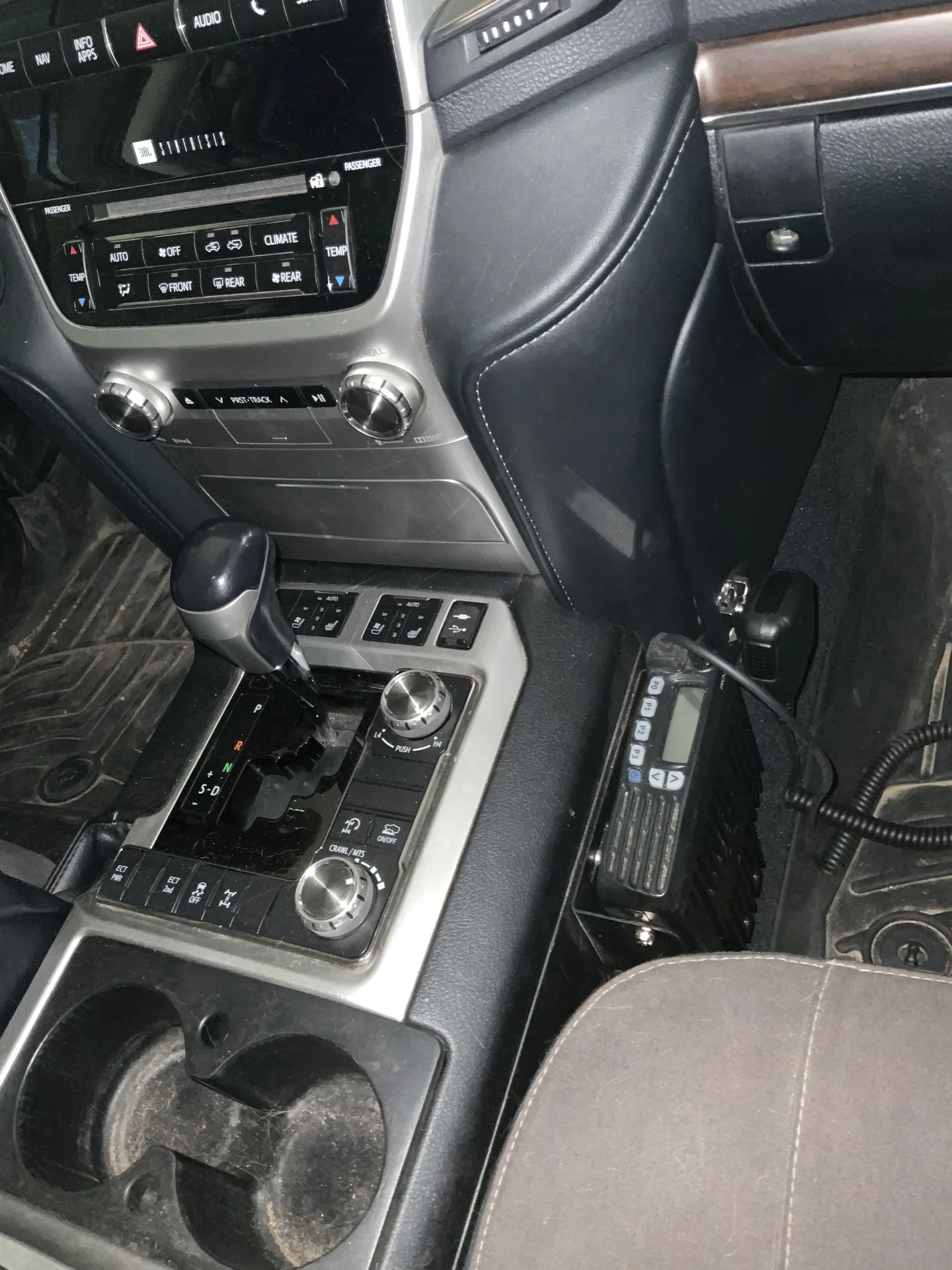

I'm trying to decide where to mount mine. Do you have any close-up pictures of where you attached the mounting bracket?
Sorry, I don’t have any pics that show that. I can take a few but I’m current not with the truck. I keep it at our lake place. Won’t be down there for a couple weeks though.
All I did was bolt the bracket to the plastic panel. There are some things above the panel that would interfere with mounting bolts that you need to avoid.
