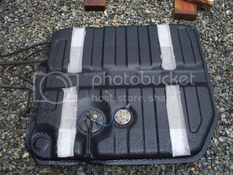

I think there is one with a larger diameter and that is the one to use. This was the case on the FJ62 tank that I used anyway.
I used the line on the right. I don't know if the FJ60 tank is the same as this though.
Thanks Kim, the FJ60 pickup is from the same spot as the BJ60, the FJ60 has two lines both the same size...maybe I should put the diesel pick-up in, though more of a hassle as I have to drop both tanks. Surely someone has used the FJ60 pick-up?
Yeah so they tell me...anyways I bought one 9 years ago so I will swap that over from the 81BJ into the FJ tank at some point.
Cancrusher tells me, he tested both lines and they both seemed to come from the same area, so he just plugged one and has had no issues.
