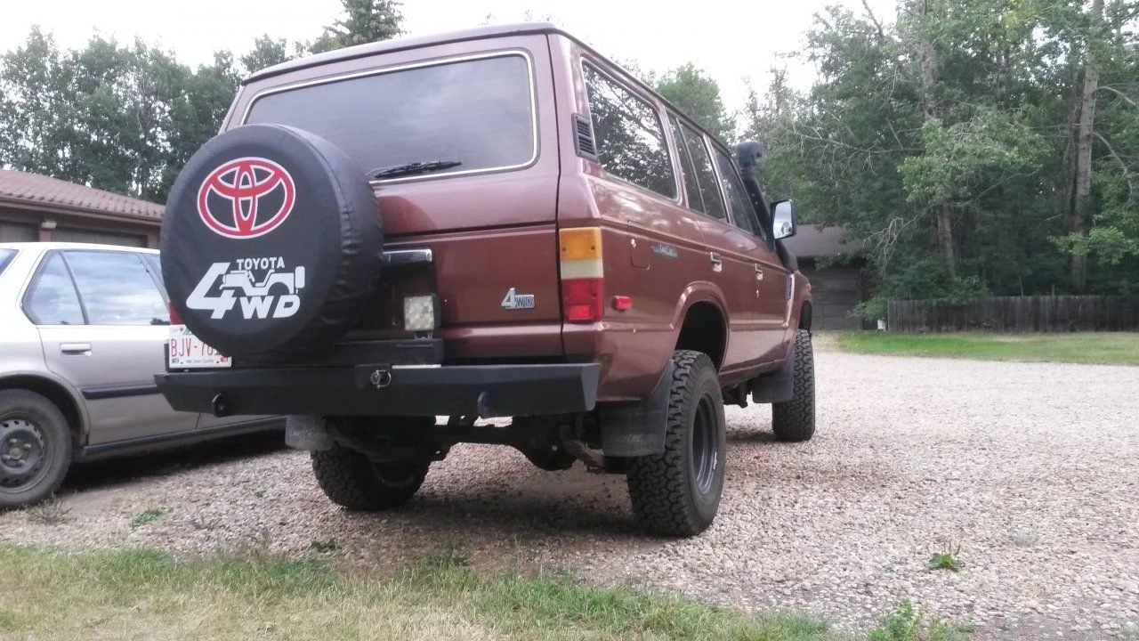

How much of a lift does your truck have?
And what is that turbo intake, and where did you get it
The hose from the air cleaner? It is from Greenline hose, can't remember what it is called, sorry!
The lift? hmmmm let me go check...middle of rocker panel between front and rear tires from ground is 20 inches, right rear corner of rear rocker by bumper is 25.5 inches.
Measured on a gravel driveway so might not be super accurate.
New tire cover. This was not my first choice (I wanted the one that said "LANDCRUISER" straight across the middle for a more stockish look), the one I wanted they could not get.
