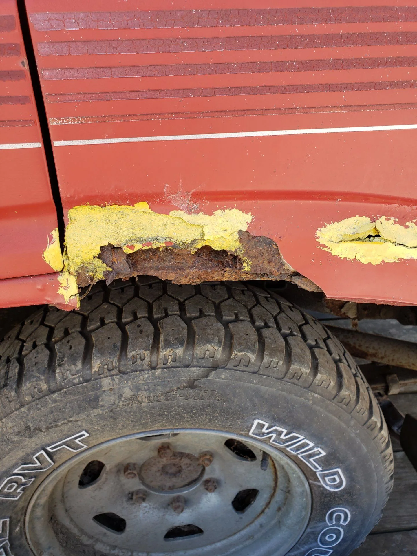

The bad is it doesn't run, previous owner seems to think the fuel pump is bad and pulled the tank so I'll start there. Rear quarter panels have some pretty good rot in the wheel openings. And the windshield and drivers side window is busted.
The good is everything else is fairly solid, interior is in fair shape and everything appears to be there.
Does anyone make patch panels for these rigs or am I stuck making my own?

Unless you need the full lower quarter, make your own patch, it is easy enough with a welder. And even then make your own. It really is not that hard.
I got mine through trail tailor, but he no longer is selling them. it was just shy of the bumper indent in the rear so I had to make my own patch there.
I think there are others, but if you can find a good clean quarter from a member here, that might be a better options.

Nice truck! CCoT had patch panels on their site - not sure if they still do. Very expensive. I'd try to get a cut from a member, or make your own.
