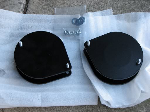

Saturday, I picked up my new MetalTech 2” front coil spacers! These things are beefy…

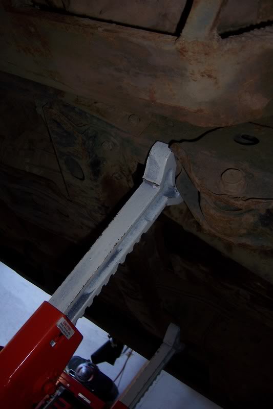

Then I got the truck on jack stands.

Note- At this point, the only thing that is holding up your axle is the friction in the bushings. Make sure that you don’t over-extend your break lines!!! I never had a problem with my 4” longer SS lines, but I did keep my floor jack under the pumpkin just in case.

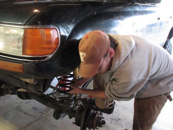

Then you need to get the springs out. I am running OME “J” springs, so I have to step down on the rotor a bit to get enough room to pull the spring out.

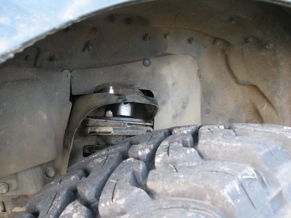

Next you will remove the bump stop at the top spring mount. Just two nuts and it falls.

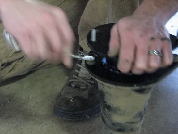

Now attach the bump stop to the spacer. I used the original hardware for that.
Now reattach the bump stop and spacer to the bump stops original location. I used the included nuts and washers.
The springs go back in next. Because I have J springs, I needed a little help on this part. My camera man had to stand on the rotor while I set the spring. It was just a bit to tight for me to do myself. (Or I am a bit too skinny, which is probably the case.)

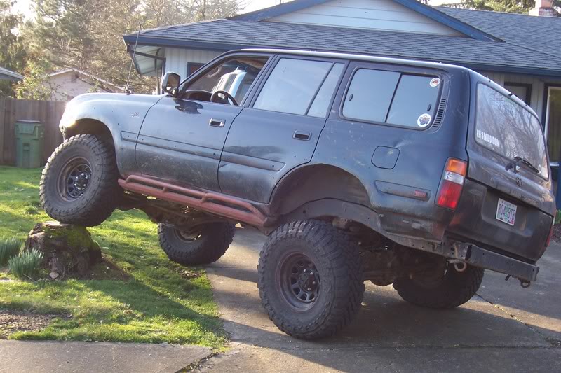

And of course you gotta test it!

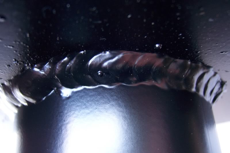

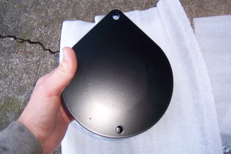

Overall, I am really impressed with the quality an fitment of the MetalTech spacers. These boys know how to do things right. It’s nice that we now have an option of getting a spacer that is taller than 1” (MetalTech sells 1.5” and 2”) and is metal, so it will last the lifetime of the truck. Great job guys!
LOL! That's the good side! These are a new product from MetalTech. The 1" spacer is all the choice that we used to have. Last week MetalTech came out with these and I jumped on them. As stated earlier, these things are extreamly well built and, IMO, the only option in regards to spacers.
Looks good! I find them easier to install if you bolt the spacer to the cone, put the cone in the spring and install them together.
