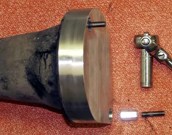

Mine were better-er. Dunno why, they just were. :flipoff2:

I got 2 different pairs so I can alternate for some variety...
steel vs alum
1 piece vs 2 pieces
1.5" vs 2.5"
etc...
Metal, dudes! Metal! Real cruiserheads don't want to deal with floppy rubber... :D
So, I can't get this right in my head. I have a slee 2" bumpstop puck in the front, if I put the MT spring spacers in do I still need the bumpstop spacers for my 35" BFG AT's what about when I run a true 35 like a toyo MT or swamper? With the spacer it would be impossible to bottom out the shock now right?
The advantage of the spacer like MetalTech's is that it both lifts the truck and doesn't change the position of the bump stop in relation to the axle. You can run both the bump stop extension and spring spacer together.
You got it mixed up, the spacer also lowers the bumpstop 1.5 or 2", so with this spacer and 35's you would need no additional bumpstop extension.

No, Cory is correct. If you don't have a MetalTech spacer, the bumpstop sits X" from the axle at rest. With the spacer, it is still X" from the axle at rest...:cheers:
