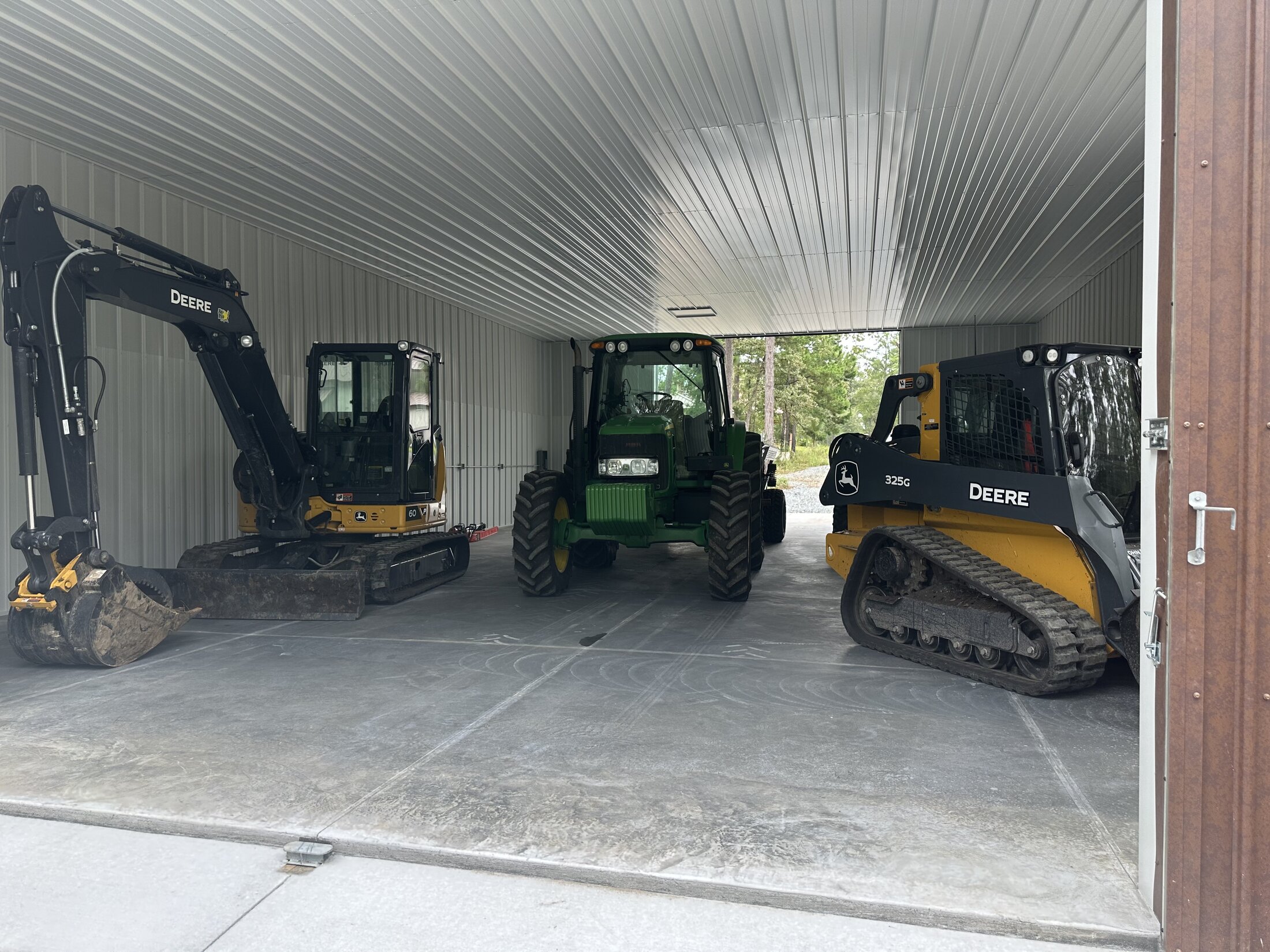

Getting ready to prepare the site in the next two weeks. I decided to insulate the barn but I don’t think I’m going to add AC.
Will have a double sliding door on each end. Plus a 16 foot sliding door on one side.
The colors match my other building.

I guess I can ask Morton about it. I actually got this idea a few weeks back when I took a day trip to Iowa to shop for a new tractor. My Morton rep got me to tour a number of Morton ag buildings and almost every one had a big sliding side door like this one. Will be super useful for getting the skid steer in and out.
I’ve also decided to add an extra 12 feet to the length. Total size now 36’ x 60’.
How thick of concrete did you use? Looks good! I’d love to have something like this to park the skid steer and tractors. Mind me asking how much you have in it?

6” slab. I think I have around $140k in building, site prep and concrete. Electrical, plumbing, HVAC and landscaping in the next few weeks.
I would also add that I could have absolutely built this cheaper with one of the many online building kits. I did that for a barn at my last property. Based on that experience, I would take Morton every day of the week.

I would never pour less than 6" Jon. Also would never use less than 4000 psi and would always insist on a machine troweled "slick" finish on interior floors.

These are actually the specs on this particular slab. 4000 psi and 6” with a slick finish.
Dimensions are 36’ wide and 56’ long. The trusses are spaced on 8’.
