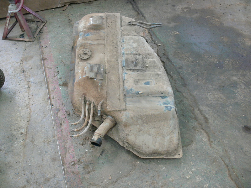

Got the fuel tank out. This tank looks pretty good, it was completely dry, not a drop of any sort of liquid in it. I haven't pulled the sender unit out yet, but there's no rust dust sliding around in there, so I'm guessing it's pretty clean inside. Almost a shame I'm not planning to use it:

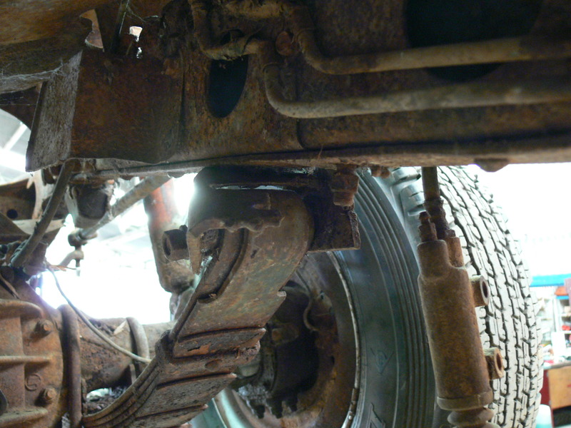

Not sure what happened here!! Looks like the rear spring hanger split wide open somehow. There are no bushings in the front springs--not just worn out, but actually completely not there. I'm wondering if maybe there were "borrowed" for another truck? It's becoming more and more apparent that this was a bush truck and may even have spent its final years before being parked relegated to back roads where no policemen were around to ask difficult questions about registration and insurance.

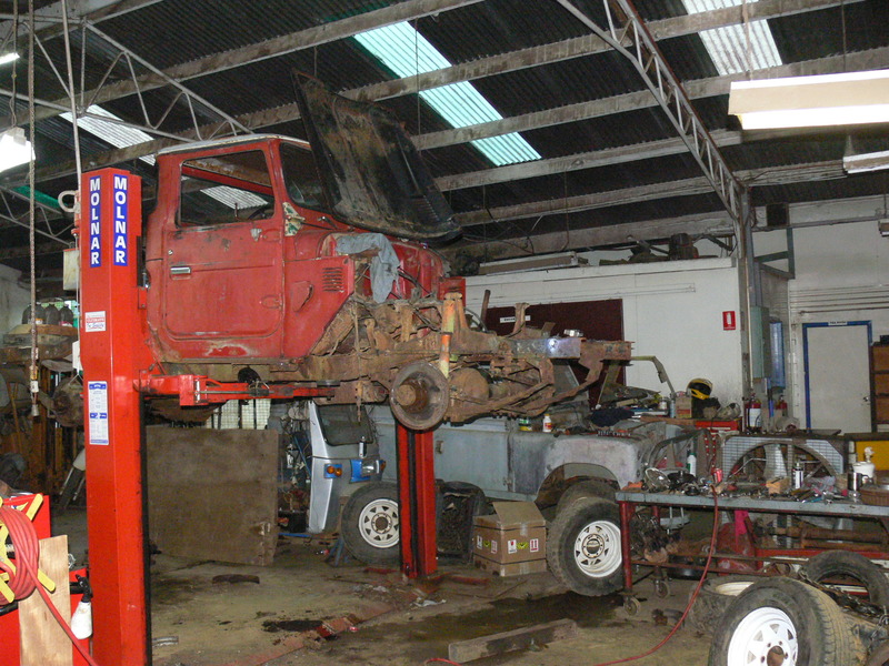

The way I left it tonight:

Pulled the engine and transmission/transfer case out. I had not originally intended to pull the trans mission out, but since it was only held on by 4 bolts and since there was no crossmember to unbolt it from, I decided to just pull it out. I think this was a good idea, as it was leaking oil all over the place.
Once all of that was out and once the various fasteners had been loosened, it was a simple matter to remove the engine.
I admit that this frame is a bit worse than I was expecting. Tomorrow I'll focus on getting the steering sorted out (looks like somebody has maybe fitted a tie rod that is too long!! Maybe off of a later model LC?), and the front suspension. If I have time, I may also try to clean up some of the "repair" work that has been done over the years. I need to do something about the spring hangars.

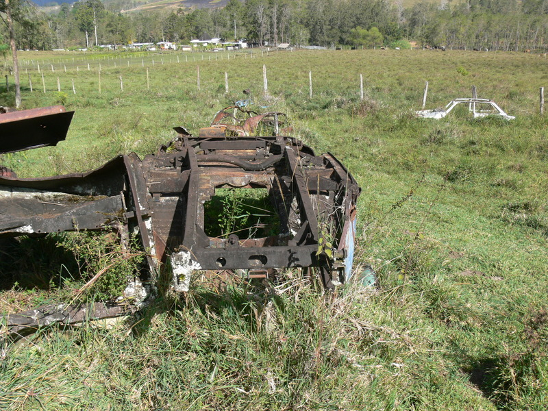

FJ45LV #1, this is just the bottom of a FJ45LV body, but what you see here is incredibky solid, no holes, only surface rust:

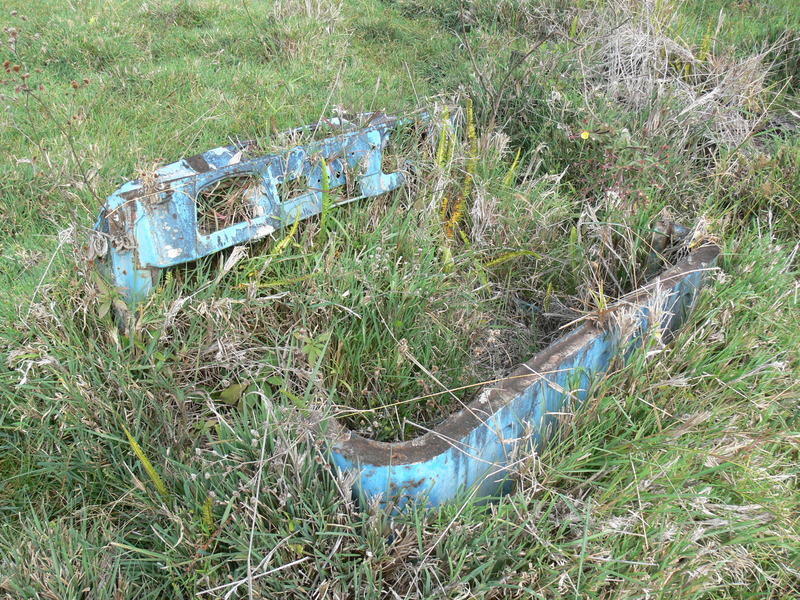

FJ45LV #2, a little bit more left of this one, again what you see here is really really solid. I would love to know why these two LV's were cut up the way that they were:
FJ45LV #3, the most complete one. I toyed with the idea of trying to resurrect this one, but it's pretty rough--the rust isn't bad, but the dents are pretty bad, both sides are caved in for some reason, almost looks like somebody tried to lift it with a chain passing through where the rear windows were.

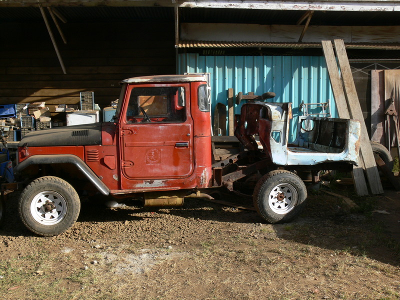

But the next best find (after the nice LV frame) was this FJ45 tub with a very nice floor:
Yeah, I'll have that. Loaded up on the faithful mule (this Land Rover is my daily driver, btw):
Now I have a new problem--that light blue tub is nicer than my red one in a lot of ways, but both need body work. I think ultimately it's going to come down to which one needs less work; that'll probably be the one I'll use.
