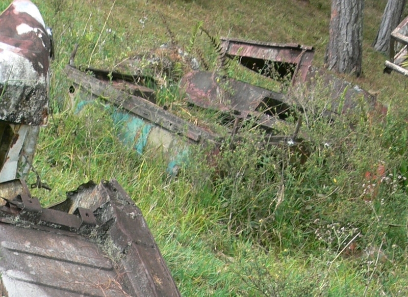

In photo 4 is that a 45 series style side ute tub. :)

Photo 4, do you mean this?
That's actually a WWII Jeep tub and frame--the bulkhead has been pushed back into the passenger compartment. One of my co-workers here has a burning desire to resurrect that one. I'd say his chances are pretty good, he's still single!!
good parts trove ... if those frames/tubs were laying on the ground here, they'd be piles of rust by now ... looking forward to your next steps ...

Yep that's what I was talking about.
Most original beds/trays/cargo tubs here get bashed and overloaded to death pretty quickly. In my first photos in this thread you can see the sort of tray they all end up with sooner or later, locally fabricated "coffee trays", so called because the trucks that are used to haul coffee beans out of the bush to market are usually equipped with them.
Since it looks like I will be building mine into a swb pick-up, I'm kicking around ideas for what I want to do for the cargo area--I did find, out in the junk pile, a WWII era .25 ton Jeep trailer tub--I need to go unearth it and see if it can be made into anything useful.

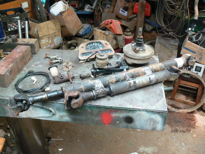

Treasure trove of parts from fellow MUD member Ozcruiser arrived today (finally!):
I'm very happy with this stuff, mate! Not pictured is the steering column bracket, that floppy steering wheel was really irritating me and I couldn't wait, I had it bolted in about 10 minutes after I got it!
Thanks again.

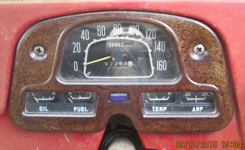

Installed the instrument cluster today, just to get a look at it. It had quite a bit of surface rust on it and at first I was going to replace the face with a nicer one that I have, but before I did that I decided to brush some rust converter on the rusty one and see what it looked like. I actually like the way it turned out:

No worries mate glad it arrived in one piece I was worried about the cluster surviving the trip.
Don't forget to pull the master down as it was a bit sticky before I give it a blast off WD40. I did rebuild it with a hone and seals but it's been sitting for a year or two. :)
