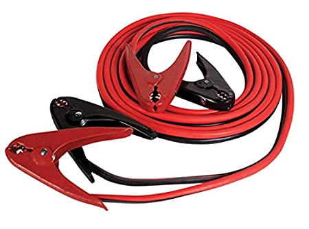

I'm considering replacing them with these 2ga CCA parrothead clamp cables:
http://www.amazon.com/FJC-45245-Parrot-Professional-Booster/dp/B004BGXNGW/?tag=ihco-20
The price of solid copper cables is through the roof, and not worth the money to me for occasional use.

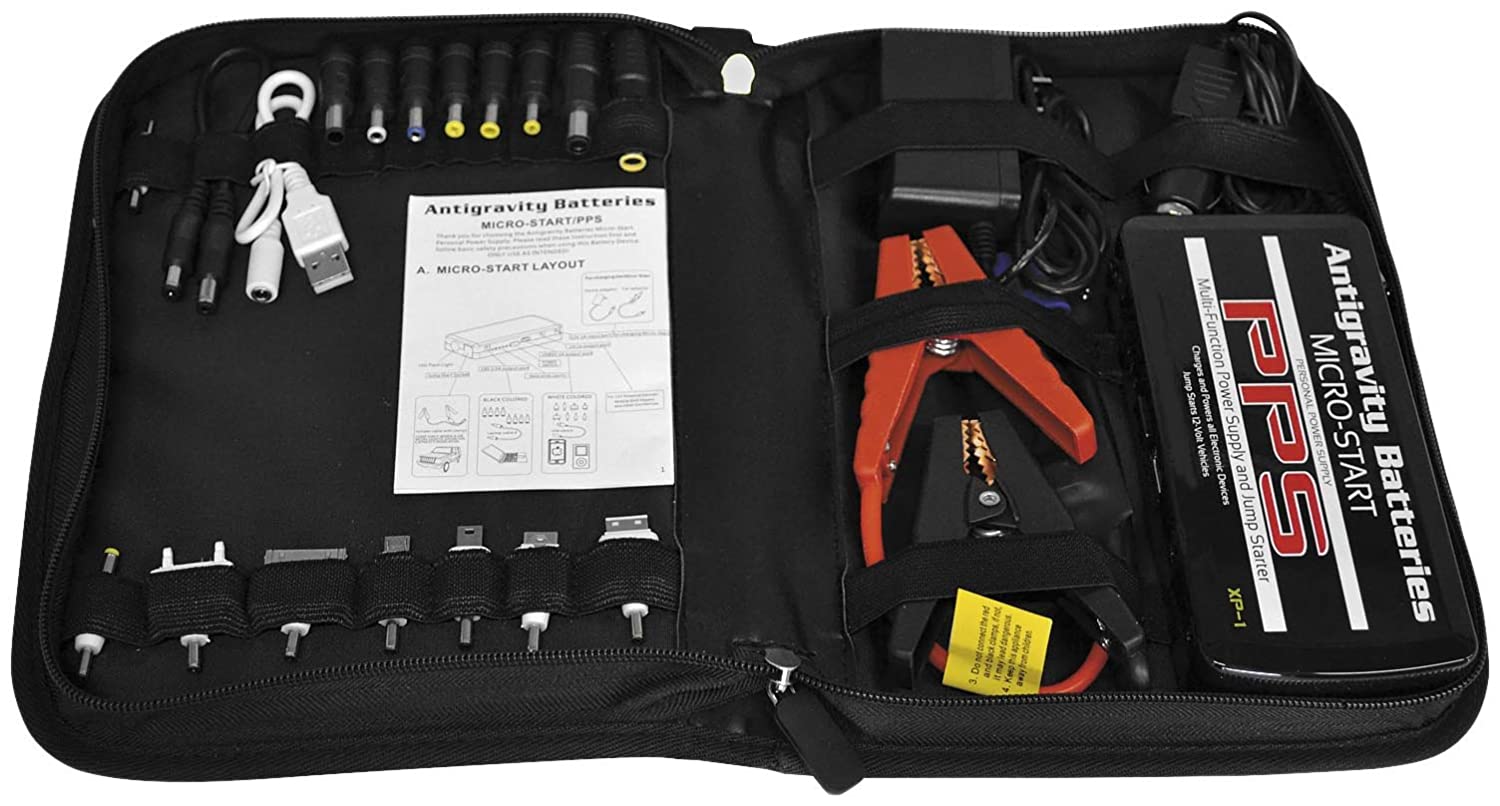

A couple of us got the Micro Start in late summer and have been really pleased. It's started my 350 with the battery removed and didn't even blink. I wish it had a provision for a male cigarette plug, but that should be easy enough to make. It'll power/recharge your other devices while you sleep when camping and can then be recharged itself via the cig outlet in your vehicle while driving the next day. There is also a larger model than the one you pictured.

I have a set of those large gauge jumper cables, they do what they are supposed to do. The clamps are somewhat cheap, but the price was hard to beat considering how large those copper cables are. I bought a set to cut up to use a winch power cable since the price was less than purchasing bulk 2AWG automotive cable!

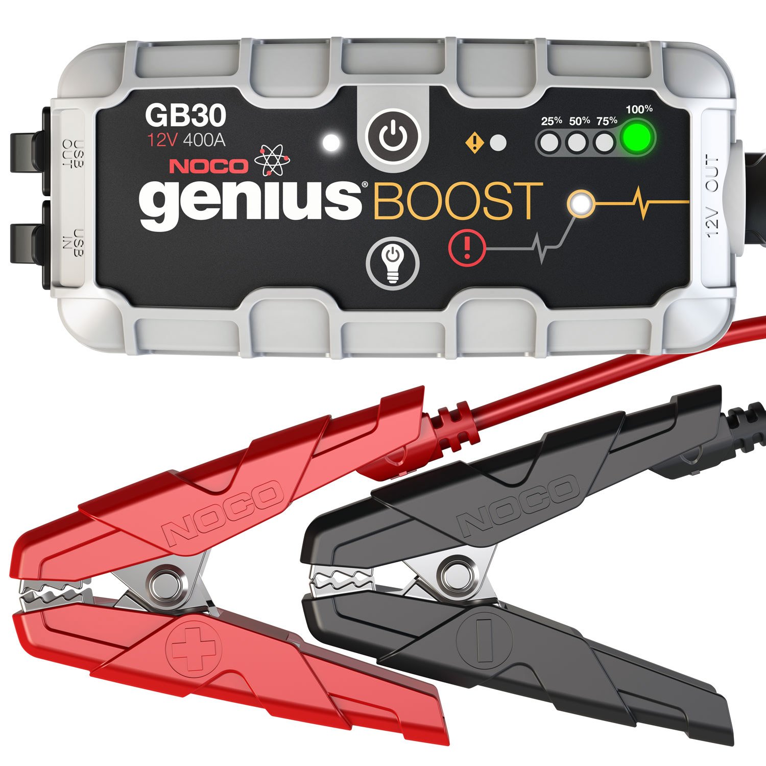

I just bought one of the noco GB30s yesterday. For $120 I couldn't go wrong. I have several other noco products and lover them they all work great and would highly recommend them to anyone.
If I recall they were called xp1 or something. As they were not a snap on product we didn't bother with warranting them. We just refunded customers and trashed them. Not worth the time to try and get them warrantied or repaired. I have seen a few different brands and they all looked the same with different colors all from china
I speak with Noco customer service today .. very helpfull and very kind ..
I decide in the 2 bank mini .. by her recommendation ..
I purchased the Antigravity last year. They saved my bacon while doing a desert trip north of Phoenix.
My battery pooped on me, and I used them 3 or 4 times to get me back to the freeway. I will never leave without them in the truck.

One of the popular uses of my ANtigravity set is when your friends forget there phone charger.
From Friday nite camping - Did you bring that charger thing with you......
HA! Exactly! It won't charge a laptop, but it does a heck of a job with small devices. I used it a few times to power the electric pump for my air-mattress while camping. The Antigravity is a great little gadget. Because it is so small, there is no reason not to have it with you.
Used my Antigravity again today to start a dead vehicle. It was in a crowded parking lot that was way too small to block off for a few minutes doing it the traditional way. Also, none of the uppity hausfraus who frequent the area would have ever stopped to help the guy out.
But, I do admit that it gets used mostly to charge mobile devices in the woods.
I disconnected all my batteries and started my 80 series 3 times back to back with an Antigravity set up.
Again I used the Antigravity ONLY to start it!
The XP1 or XP10 Antigravity? Thanks.
Mine is the XP1. Several were purchased by a Toyota dealer for the mechanic and lot attendant along with mine. After hearing mixed review on reliability the dealership claim no problem so far:meh: I find mine has been used a lot not so much for jumping but to help my friends that forget there device chargers when we are out.:doh:
