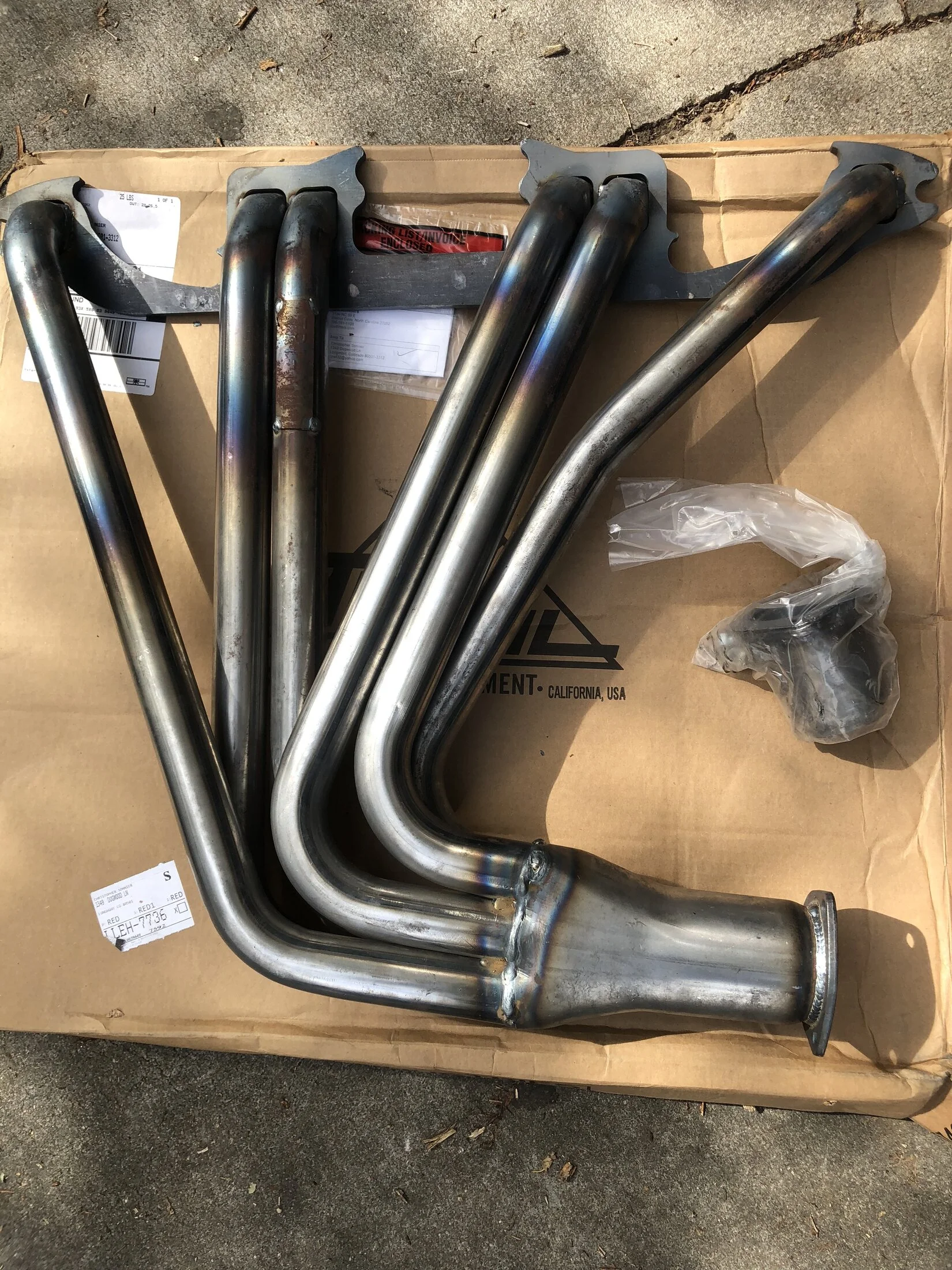

This is a series of technical notes and words of caution on the Tri-mill JTOUTFITTER headers for everyone. -----First of all if you haven't ordered em yet, I woudln't.------ They're a bitch to get on and retrofit compared to other headers, but wanted to give you some additional info and let you know of wrong turns when installing in case you already have em or on some insanely tight budget and have patience. I made it work, but If I had to do it again I would go with a two piece header. BUT, you probably can do it the "redneck" way with barstock, and copper paste like the guy in this video. Getting em machined is too expensive to even mess with IMO. So Since you have it already though, It might still be doable with massive time and money waste. Keep these tips in mind when proceeding:
Tips and rabbit holes:
The thickness of the flange is sometimes different and the headers often warped and don't flex much at all, hence why I had a machinist mill them (but it cost me $300!). It might be worth one go and see if you can get it to level out and seal, if not I would throw em away.
Since you already have em, save your money and try to redneck it like this guy in this video and see if you get lucky. you very well might. The barstock under the bolts isn't even angled straight but somehow he has enough clamping force. He is also using a stock gasket, so this means HIGHER torque spec on the bolts, which may be why it seals. He used some of the copper paste to get it to seal, and proabbly a toyota gasket. dont use remflex iwth copper paste. I went the long and hard way of getting it machined...and also went the dry remflex gasket route since it was mostly straight. but if you go this route make sure you get the intake machined simualtneously with it. (since i didnt do this I had to cut up feeler gauges to slde underneath the flange to get the thicknesses to even out.. NOT FUN!)I dont think guys who buy the two peice headders have to deal with this....

Dan
Yeah, those headers really are hot garbage. I was truly shocked when I saw the mating surface was nothing but unground welds. There was zero finishing work put into those headers.
If the mating surface was flat it wouldn’t be such an issue. Just a pain trying to wrestle everything while mounting it, but those welds make it unusable unless you’re able to machine the thing.
When I had mine machined I had to have the machinist tig weld the the welds.... insane!
Was not time or money efficient.
That has been my concern with having these headers machined flat. I took a flap wheel disc with an angle grinder to it and cleaned it up some and then flattened it mostly with sandpaper and a marble slab. It’s okay and it sealed well enough for the remflex gasket to temporarily hold. It didn’t last a full year though.
I think it sounds like they are luck of the draw? I got lucky with mine, about three years now and still holding well. Had them JetHot coated. Used remflex gasket not over torqued. Marked the bolt heads for reference.
knocking on wood.......
For the price what can you really say? I wasn’t expecting them to be outstanding quality, but mine were garbage.
Mine looked the same, literally tig welding with a beer in the other hand hahaha....
I think it just depends on the amount of WARP too.
Those welds look like MIG to me. Regardless, the whole execution is pretty shoddy, a beer might actually help😀
And here is reminder to AVOID these headers! What is worse is that JToutfitters knows about the problem and continues to sell them. In fact, the set we bought requires machining. JTO told us if we sent them back, they would just be restocked to be sold to someone else! JT outfitters has ZERO interest in providing quality nor customer service. Discusting.
