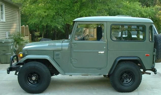

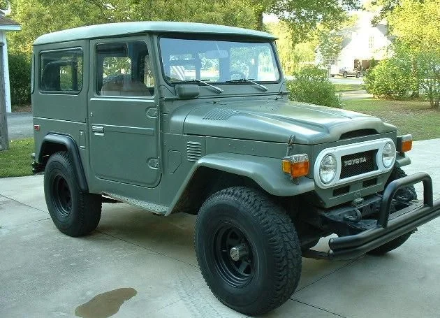

When/if I ever build my trailer, it will be OD green with a flat camo tan top. IMO flat tan would be a good contrast for the top and bezel of a 40.

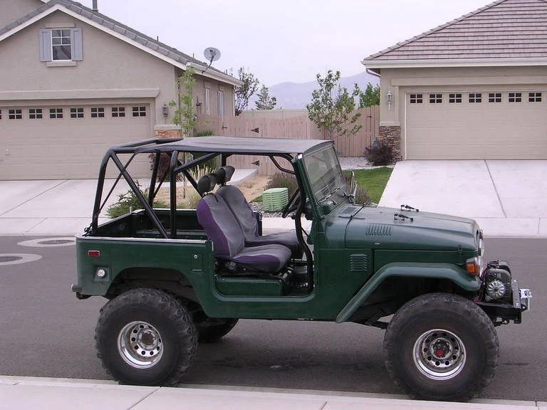

You may also want to try Krylon Hunter Green. Pic from MUD:
Nice....I like both....just put some rustoleum rustic green under the hood.....way to bright....I will check into the OD green...i like it more than the krylon.
