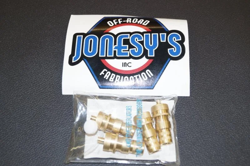

This was recently posted up someplace. These are Staun copies for a third of the price, $25, $33 to my door. I ordered a set and right off the bat I can't tell the difference. They come in a plastic pouch instead of the nice leather. Not a big deal.
Off to the garage to set them.

Same ones as sold by 4wheelparts.... I have a set in my 80.
They are cheap chinese, but work ok.
I tried them last night. They don't shut down completely and leak.
I have a set from 4wheelparts that leaked from the seal between the valve stem and the deflator. I picked up some metal valve stem caps from an autoparts store that had orings in them and transplanted them in the deflators and now they work as they should, not like Stauns but the work.
Mine are leaking at the internal o-ring. If I push down on the plunger the leaking stops.
