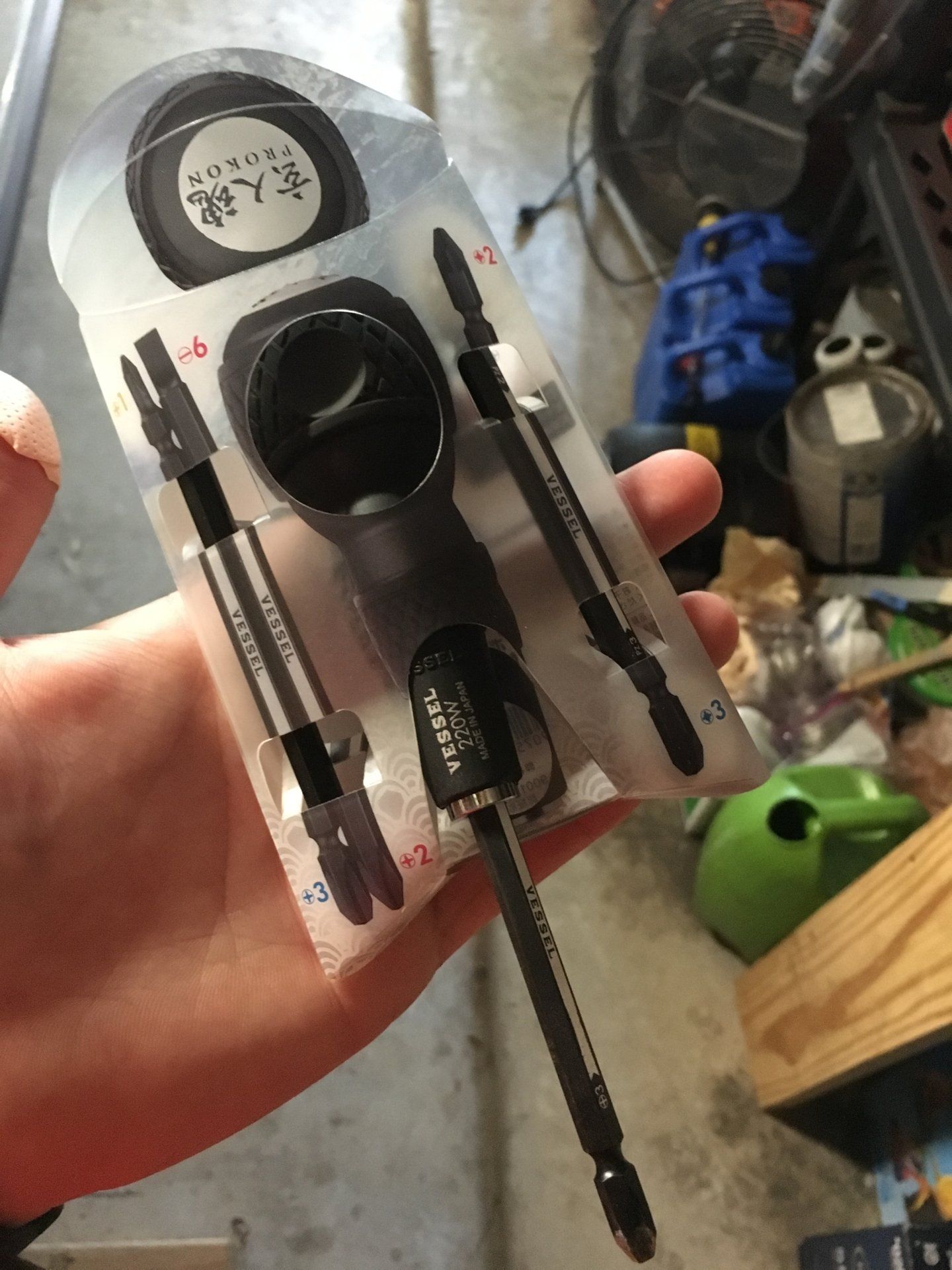

Nice start! I could’ve missed it, but if it hasn’t been said, the windshield hinge screws are not a normal Phillips bit, they are a JIS spec screw head. A JIS bit will get a better/deeper grab & help keep from stripping the heads.
Mine were stuck solid but after a coulple days soaking with PB Blaster, some heat from a map gas torch and a JIS bit (got off Amazon) in an impact drill, they all came right out without breaking or stripping.
Another trick I found that worked well was to bump the bolt tighter first, then back it out, just one more trick to help loosen the rust bond.
Good luck and have fun!
Yep, bringing this home from work tonight, along with a torch for the PTO drive-line. Yours looks fancier...
Nice! Hey, if it gets the job done doesn’t matter how it looks!
I didn’t have access to one locally, so had to go the new purchase route.

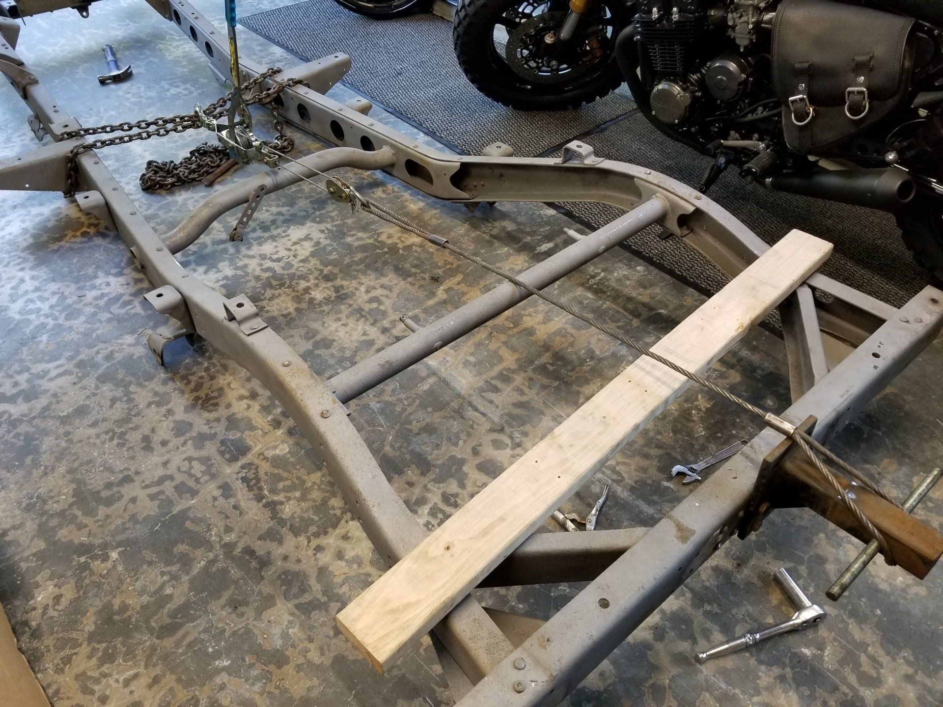

Frame is cleaned up and ready to get sand blasted. The inside of the box frame was very solid and smooth when I scraped but I did get some big chunks of rust in places. Not sure where they came from when all the walls were smooth and solid. I figure I will spray a bunch of rust converter in there.
