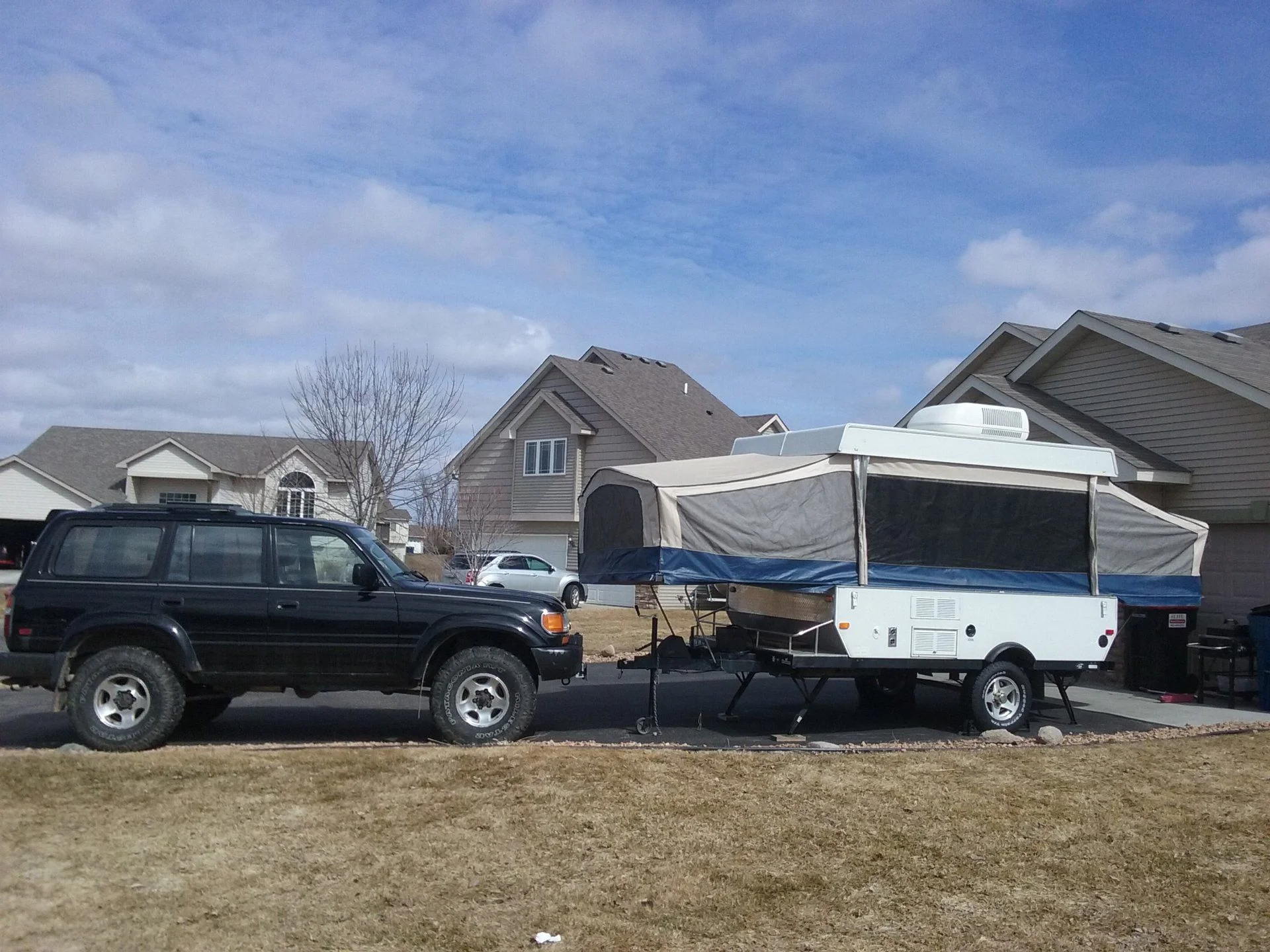

I pulled a big pop-up for years all over the place with my 80. My family absolutely loved it. I really appreciated the low profile when pulling it back into the woods.
You have a good platform to make yours.

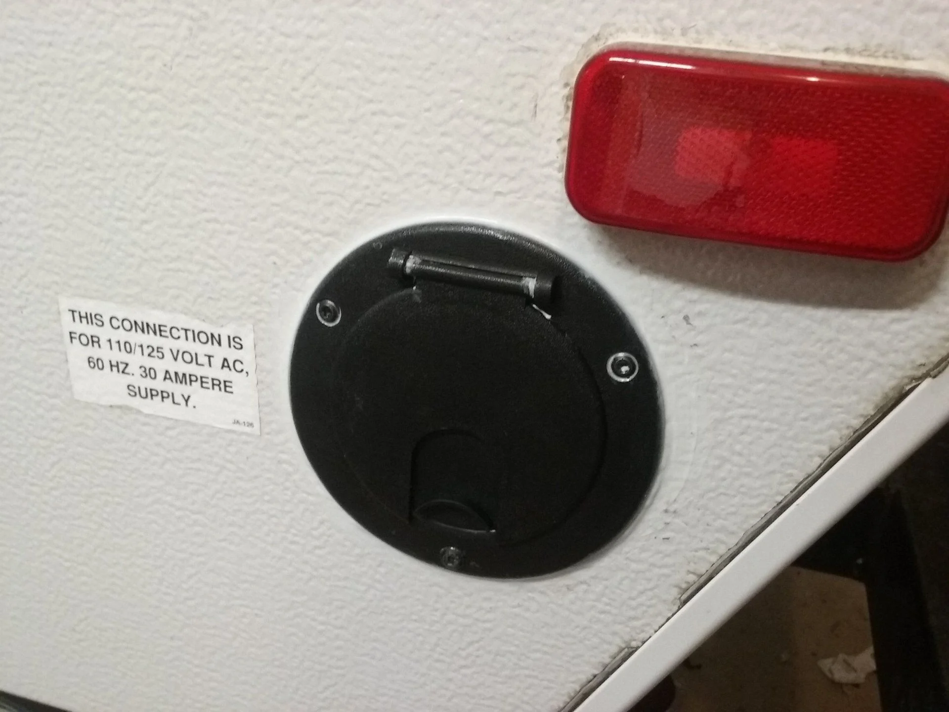

Removed all of the nasty electrical and water access port / covers, new ones on order.

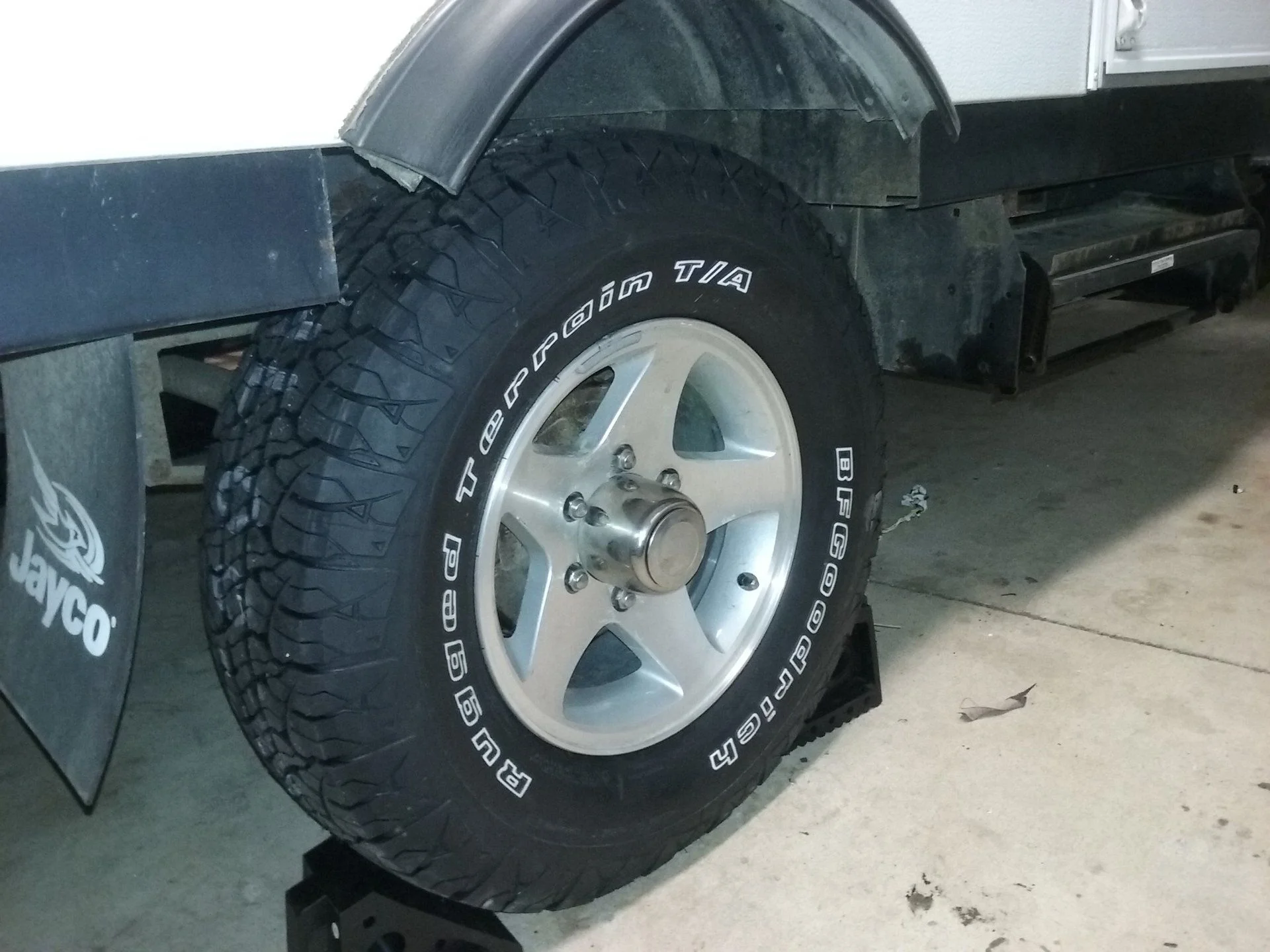

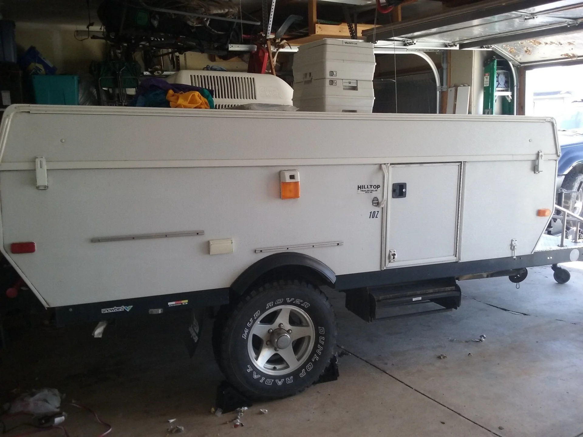

Got the 2004 Dunlop tires replaced with some 2019 BFGs.
Brakes, grease, bearings all looked great. Just needed bearing adjustment, brake adjustment, and a few pumps of grease.
Electrical cover, water in / water out ports all replaced.

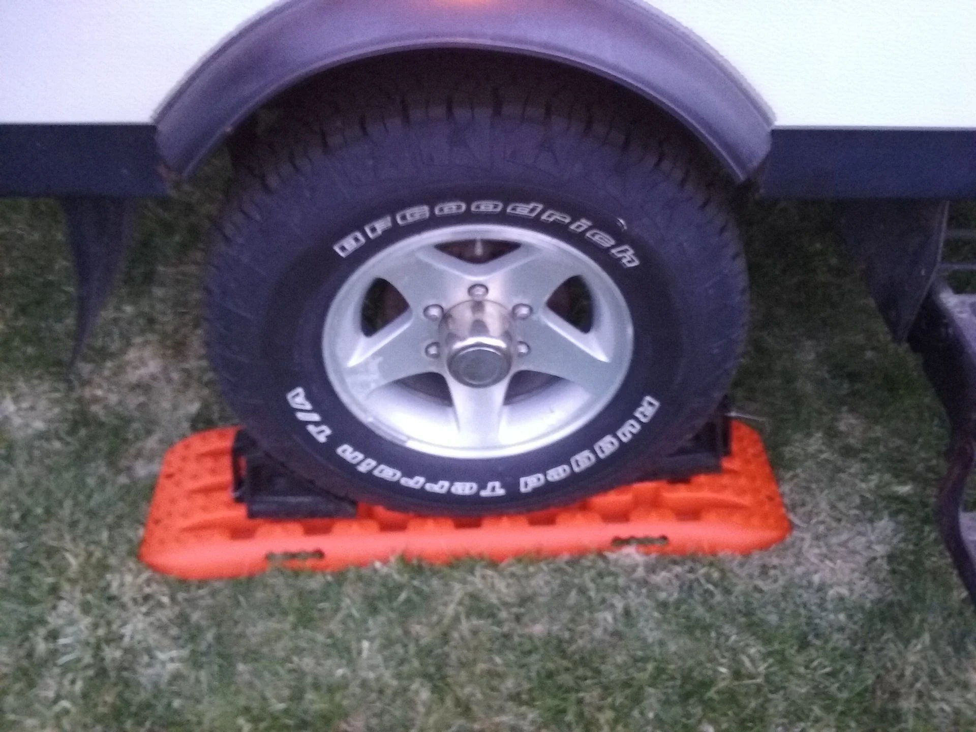

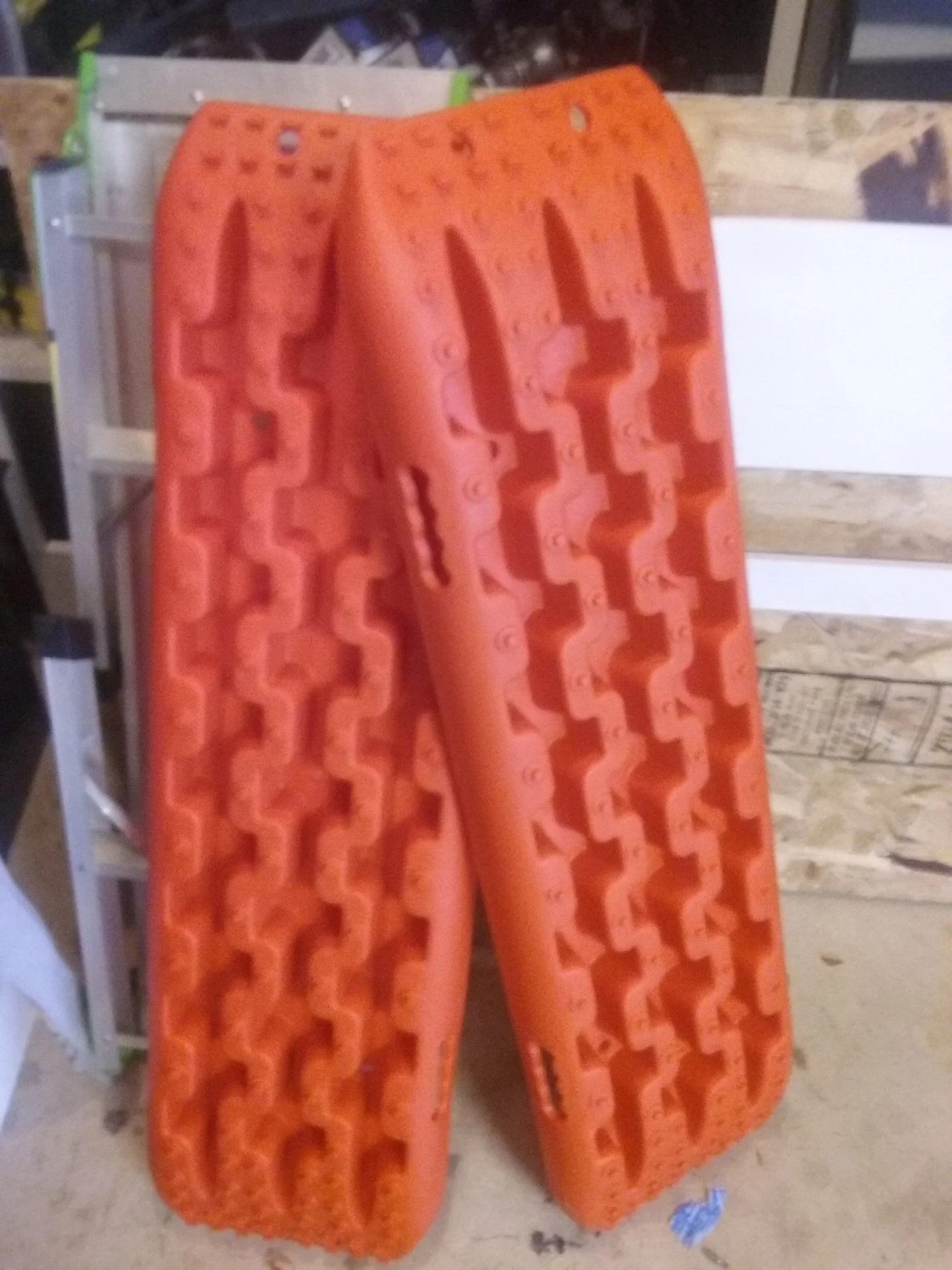

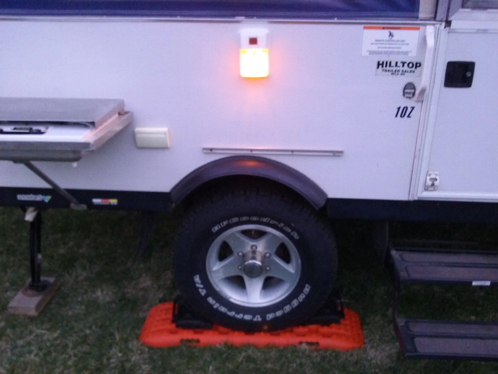

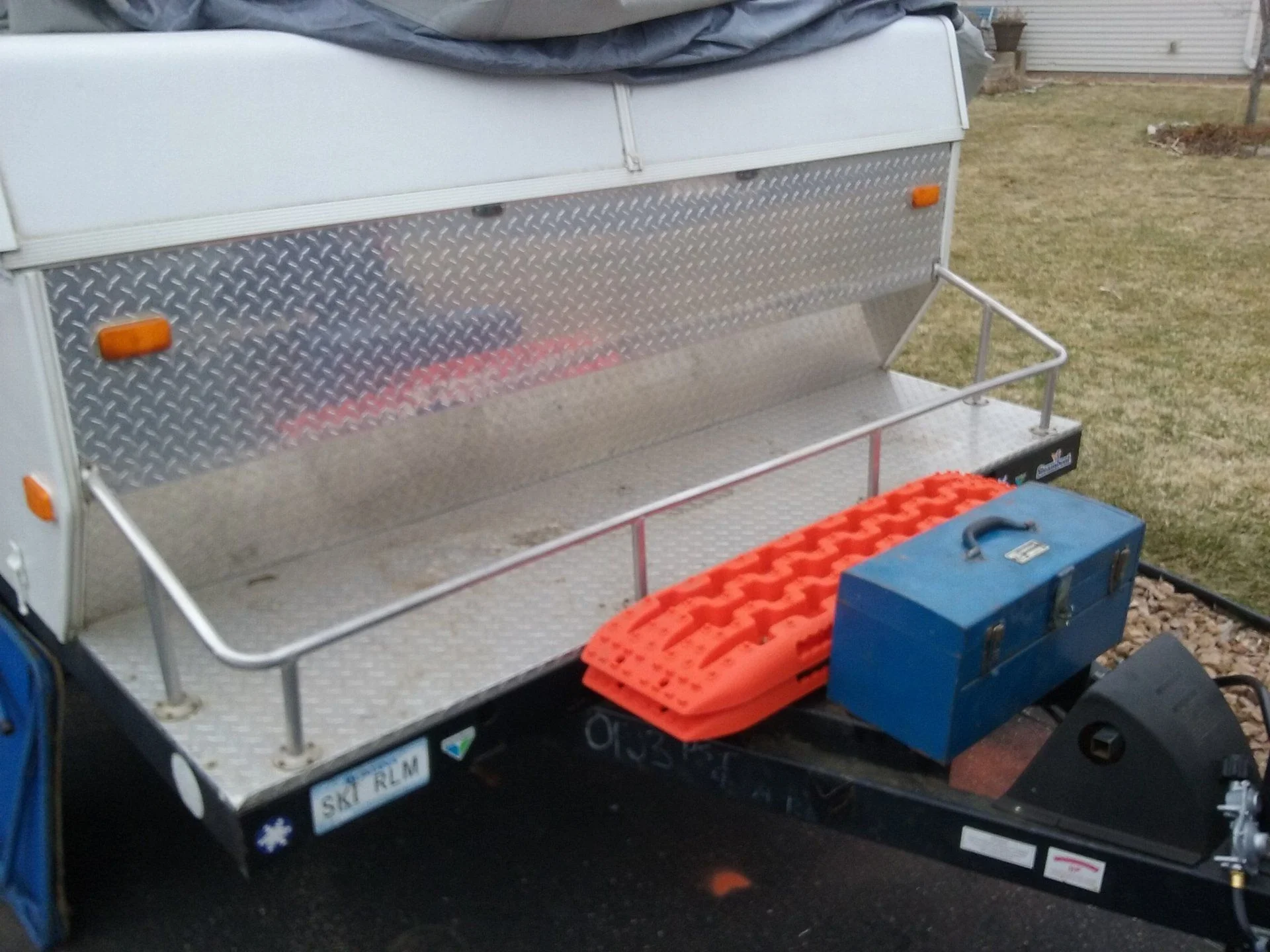

Picked up some cheap traction boards (generic MaxTrax).
I'm thinking double function here:
1 - Use as traction boards when needed for the Land Cruiser
2- Use to level camper (under the camper tires) at the camp site. These are stack-able and way lighter than wood boards.
They will be mounted to rear bumper of the camper this spring and also double as a gear shelf (boots etc...)
For $45, a guy can't go wrong.
I'll update when they break :).

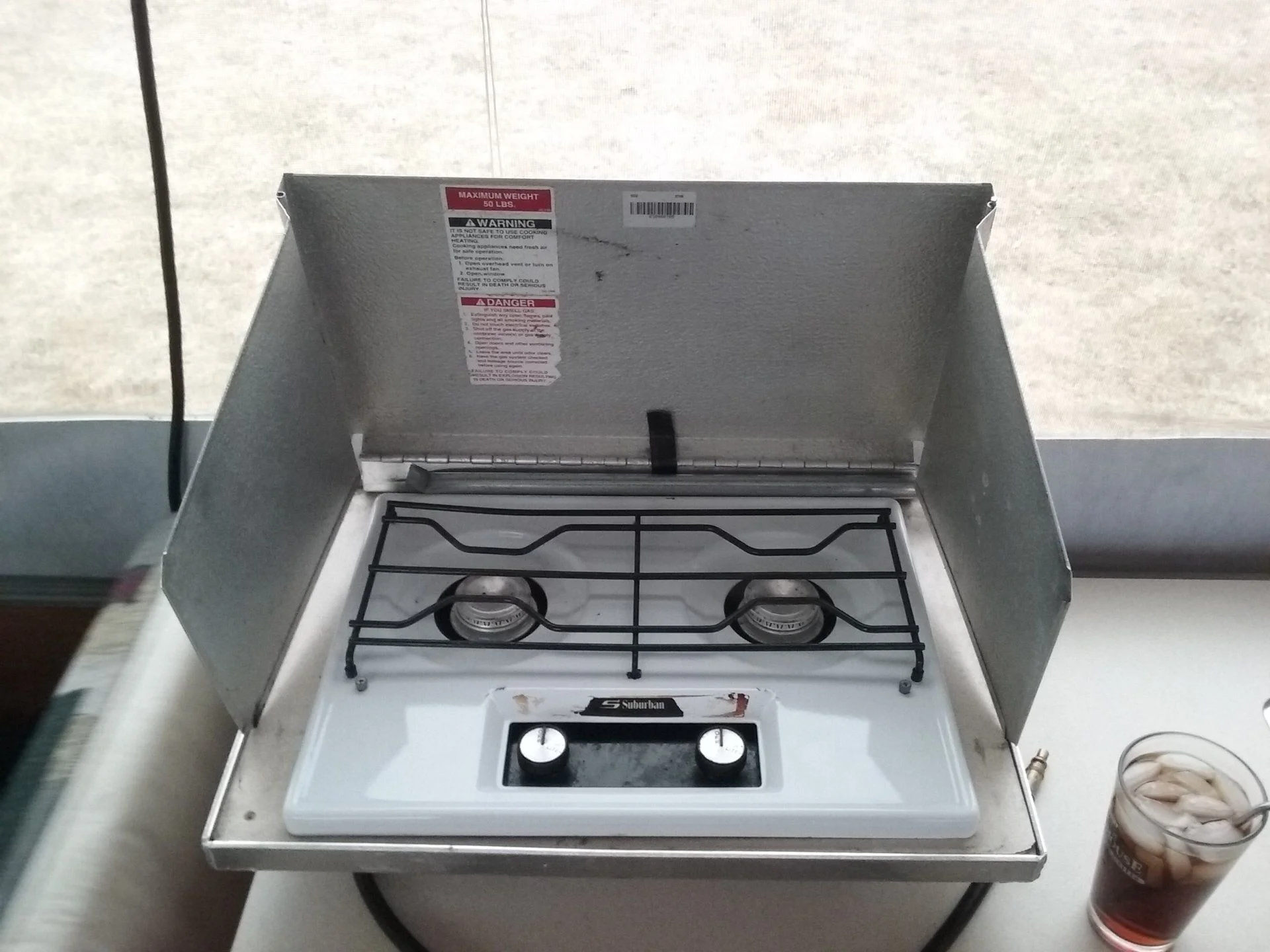

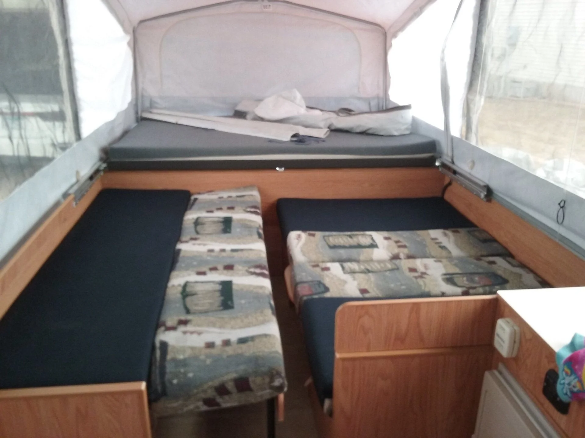

Finally, winter gave us a break. Popped it up today and got a few hours of work done (tightened every screw, tested heater and cook top - LUBE!). Confidence level with it went up 25%.
Take a look at all this sleeping area! The little cook top looks brand new and works like a champ.

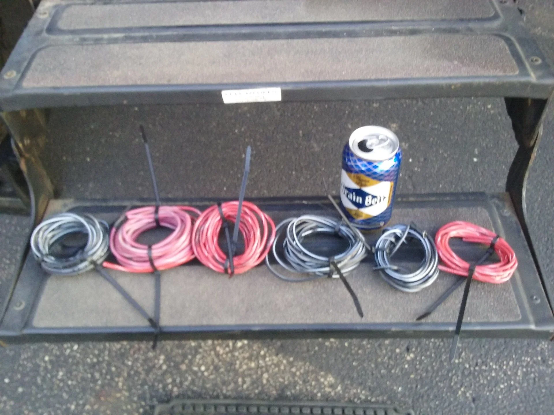

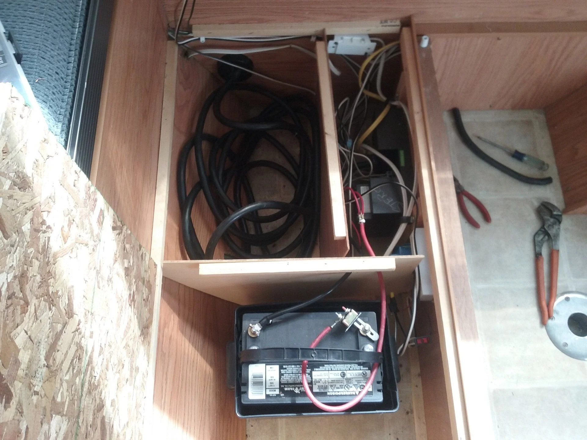

Relocating battery inside the camper, under one of the dinette seats - removed 30' of wire for that - nice.

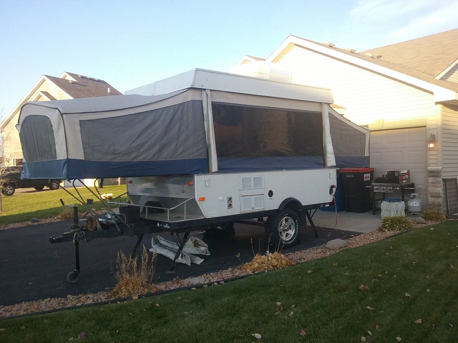

Found a good spot for mounting the traction boards (I am using for camper, under the tires if unlevel @ campsite) and a small tool box for pieces of wood for the stabilizer jacks.
The traction boards give me a little more area for strapping stuff down. If it doesn't work out - easily moved. Also trying to keep tounge weight down by removing the dual propane tanks, mount and battery. Now a single tank system and battery mounted elsewhere.

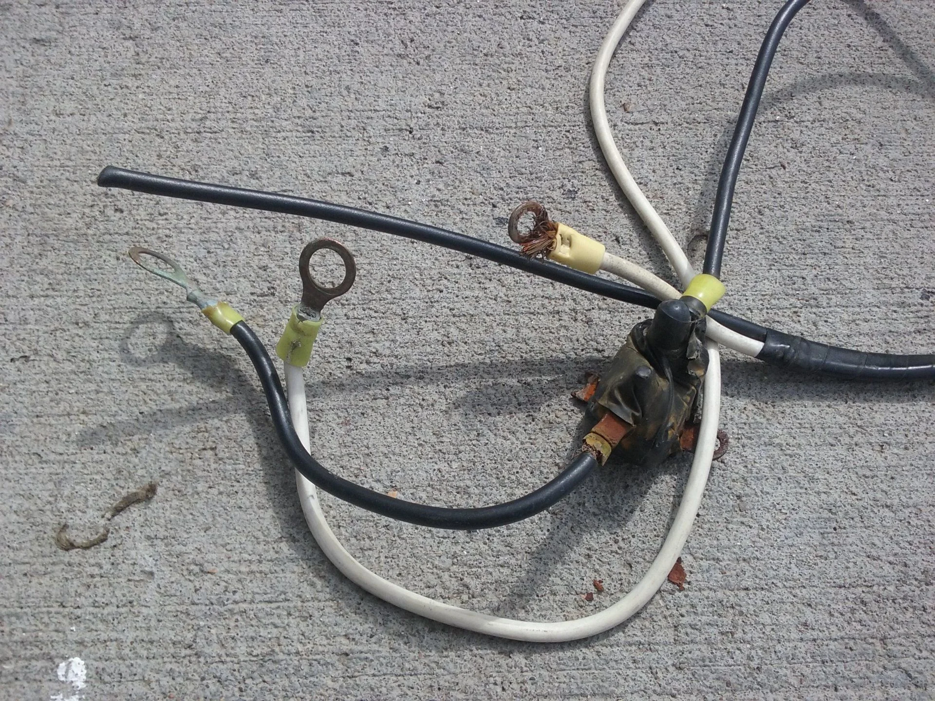

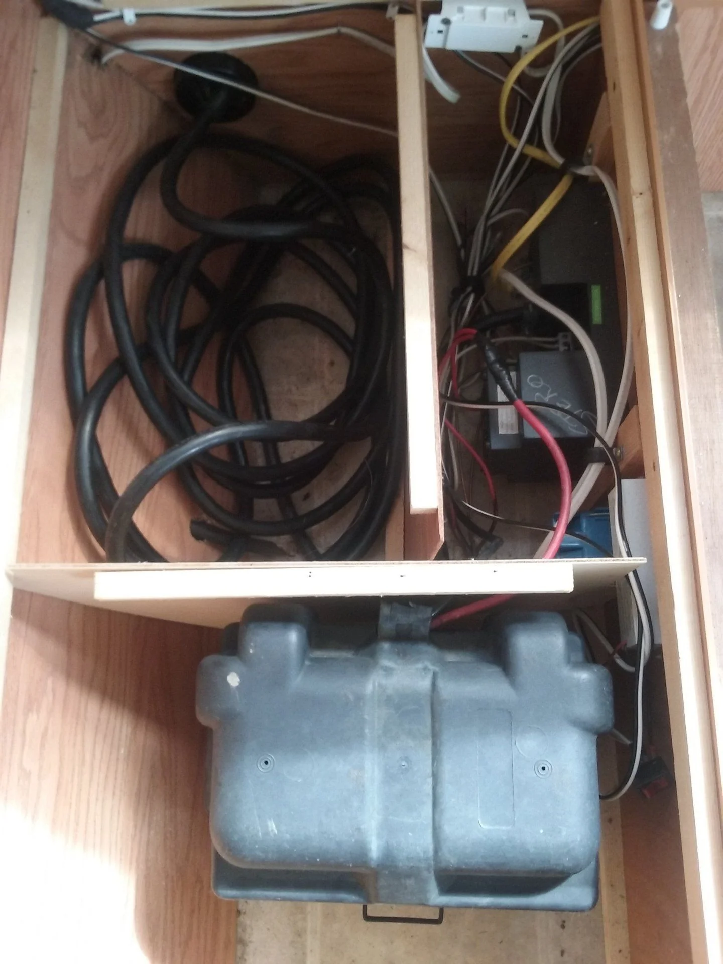

Alright! Moved the battery inside the camper, cleaned up and fixed wiring (my way) and removed about 100' of un-needed wiring.
Put in large automotive size battery cables and a nice big one bolted directly to the frame.
Replaced the RUSTED circuit breaker - what a mess that was.

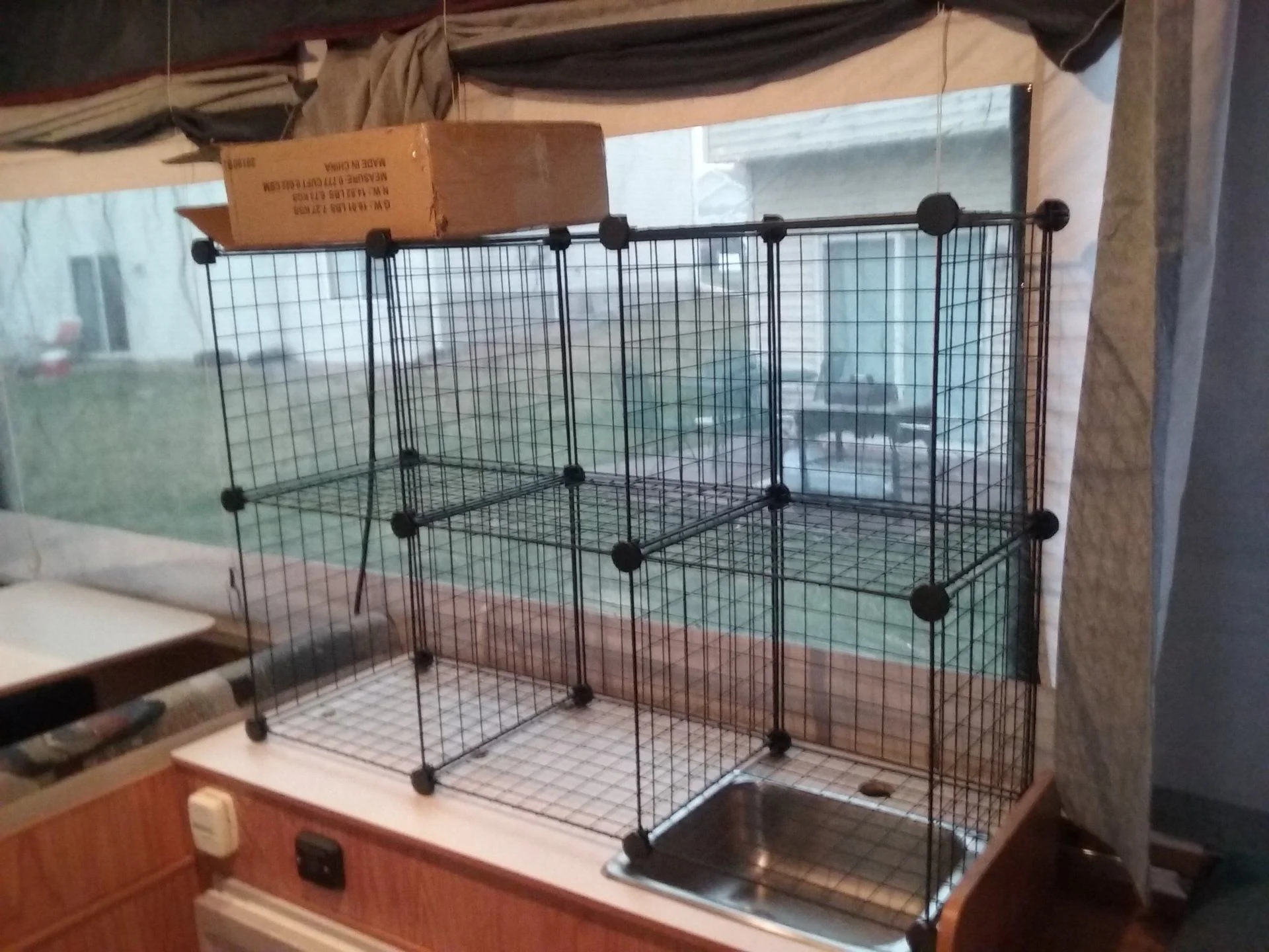

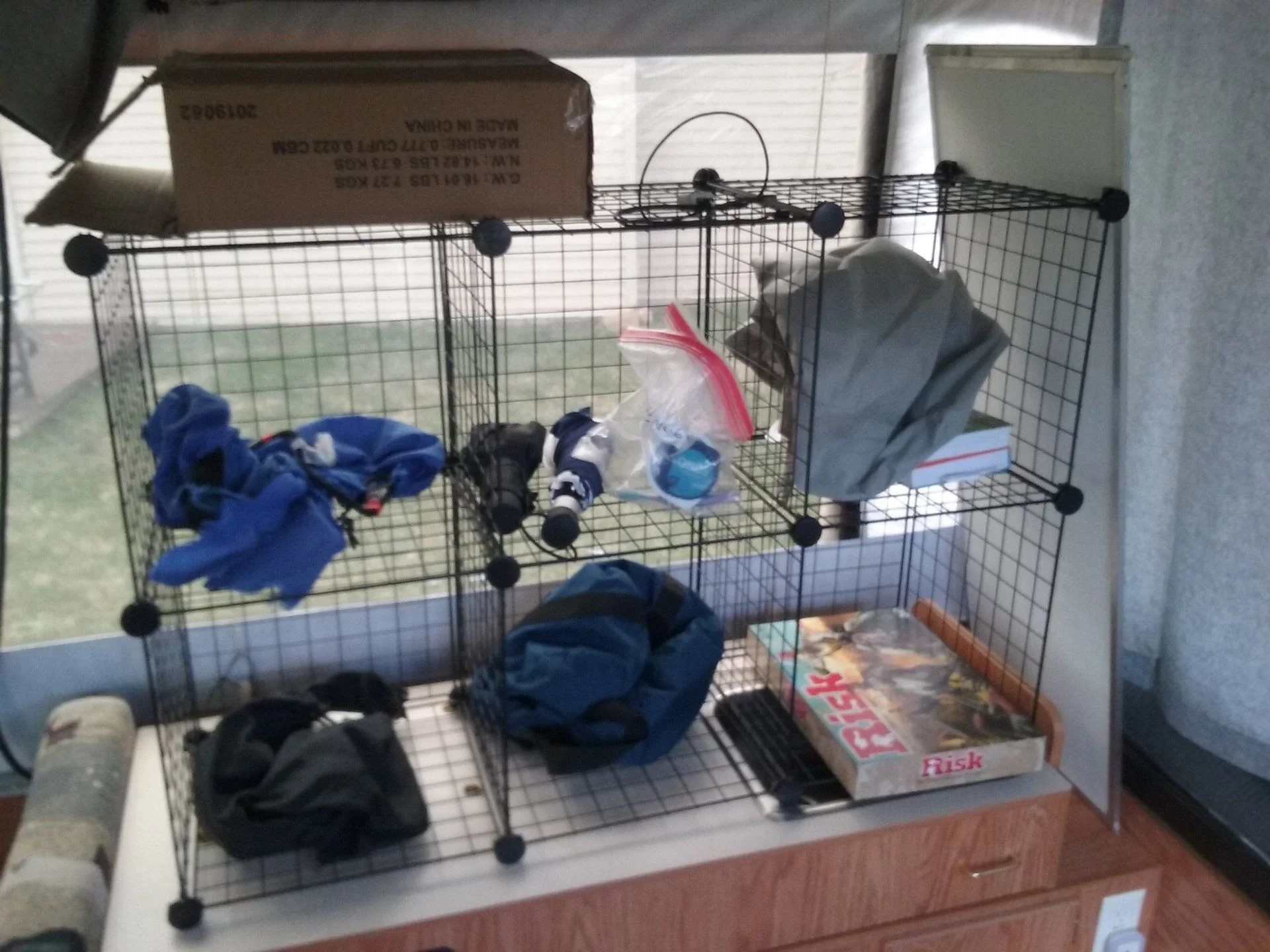

This cheap amazon racking is a life saver with 4 kids. Just a place to put stuff - problem solved. Takes 10 min to set up....easy.

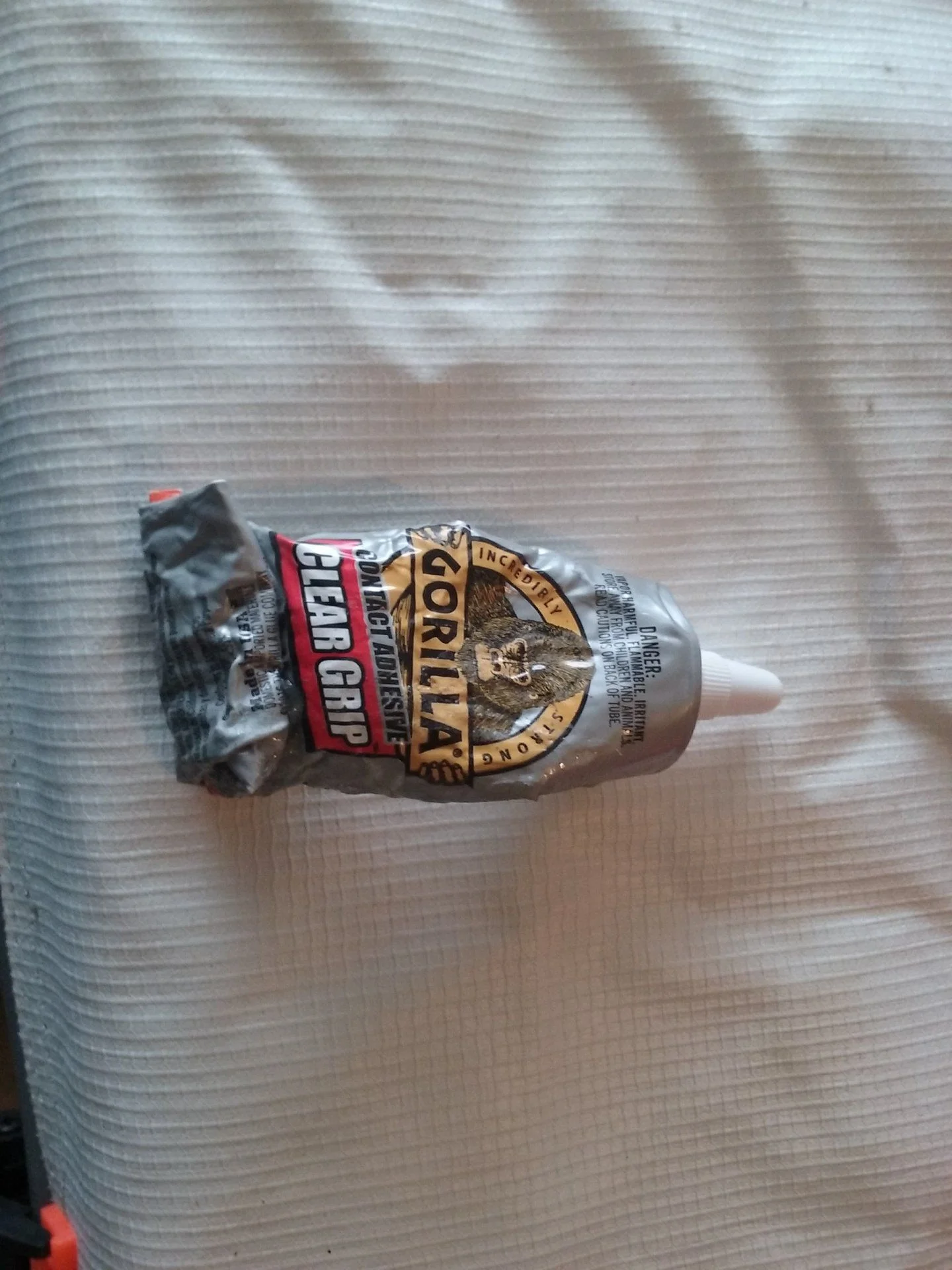

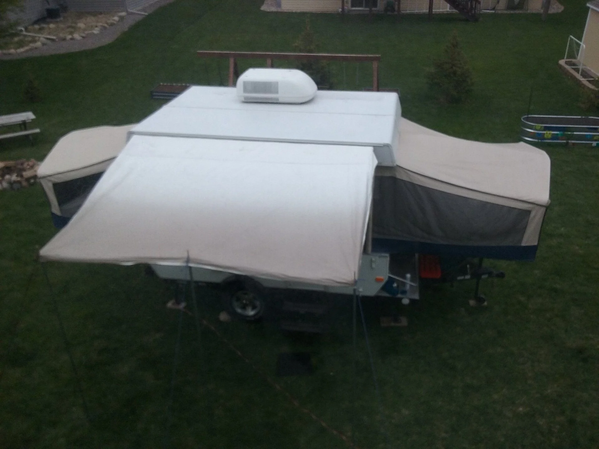

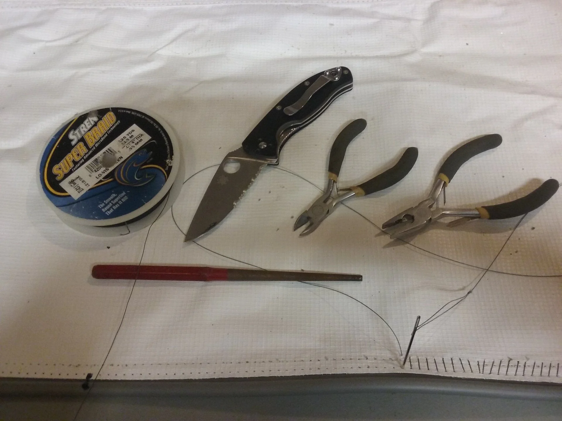

Fixed the awning. Glued and sewed the attachment head bead back on... 10 feet of stiching. Used 50lb braided fishing line and that fancy gorilla glue. My hands hurt.
Not pretty, but strong and cheap...just then way I like it! :)

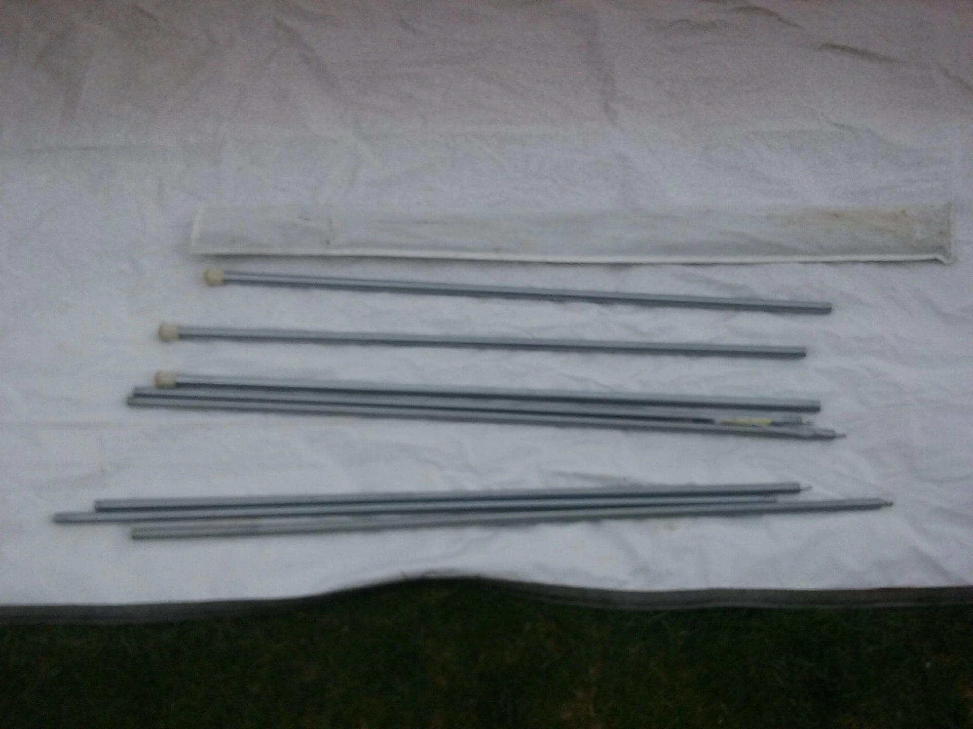

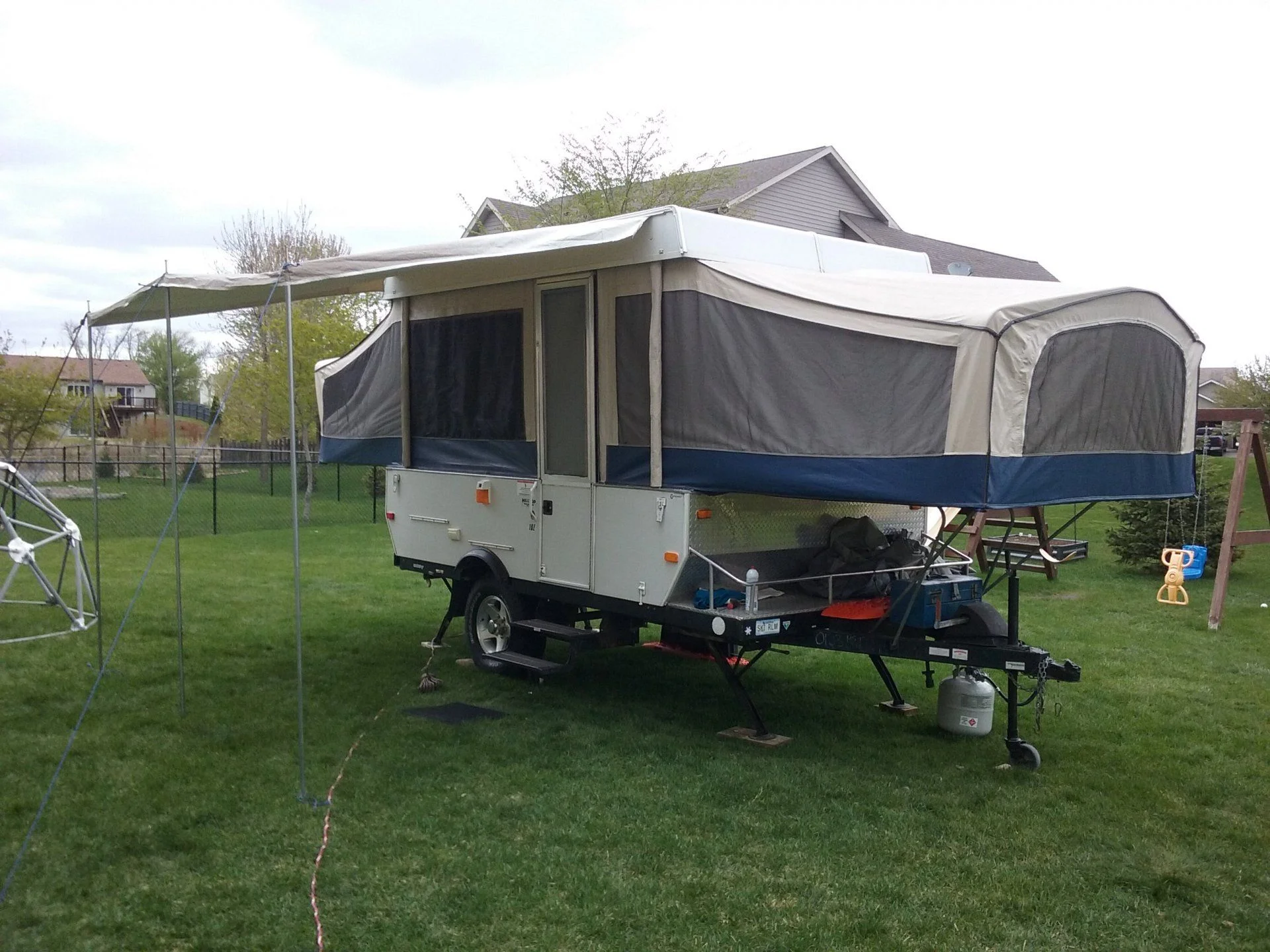

Custom Awning Fun. The original awing set up was a crazy mess of poles and missing parts. DONE.
Simplified the entire awning down to 3 poles, 6 stakes, and 3 guy lines. Simple, light, and fast now.

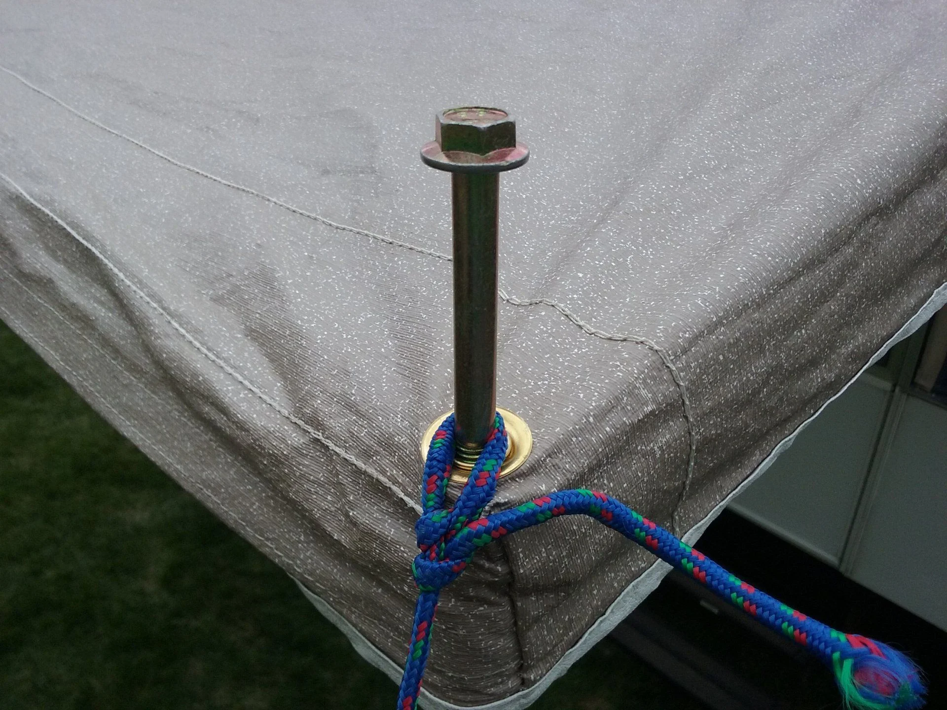

Added 3 grommets to the awning. Pressed 10mm nuts into the poles and locked them in with JB weld. Using a long 10mm bolts to connect the awning to the pole and proved an attachment point for the guy wires.
Look how many poles the original set up used:
All these are not longer used - crazy
