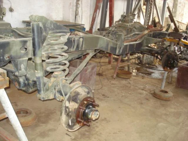

well lets start at the very beginning....I have always loved off road wheeling...here in Kenya we have awesome landscape and sometimes even the paved roads need something strong to get through them...
For off roading events, there are 4 or 5 minor ones a year and 1 major event called the RHINO CHARGE...its an event unique in many ways. Having entered as a spotter 7 years now in team Ole Choda's Green 80 series LAND CRUISER ...and had enough of spectating the off road events:popcorn: i had been looking for a rig of my own.
So I heard of this UNIMOG 404 Chassis with the portals, stock suspension and gearbox intact (Thank you JOHN!!!:cheers:)
and to be honest I was just looking for a donor car to rip out the engine from to build up a buggy type rig with pipes and seats and get it going.
SO then i heard about this FJ55 Land Cruiser with a good 2F engine in it, and since I had no real budget, and the price was right - i went for it without even seeing the rig...(again thank you JOHN!!!)
Having no idea what this car was about - I searched the net for 'IRON PIG' and then had an idea what I was about to buy!!!!!:lol:
The Pig was off course rusted out badly....the roof, the panels....pretty much everywhere....as was the UNIMOG 404....(ok ok...i know this forum is about PIGS and preservation....so I will limit talking about the MOG!!!)
having read up more and more and come to realize what a cult status this iconic Land Cruiser enjoyed....and then having seen the thing finally myself...i was smitten...and dropped the buggy plan altogether!!!
Besides the interior was really well done up, and the engine obviously kept in immaculate condition....having been rebuilt lovingly (no oil leaks!!) and a HOLLEY CARB installed with K&N Filters..... There was only one owner from new 1976!!!! an American Missionary who set up a mission in the wilds up north...this was his rig!!!! SO it felt WRONG to be untrue to the form and function of the original FJ55...and to the history of this particular PIG!!

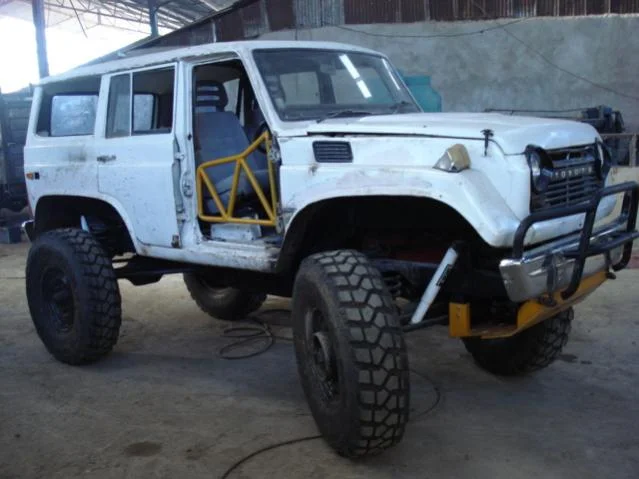

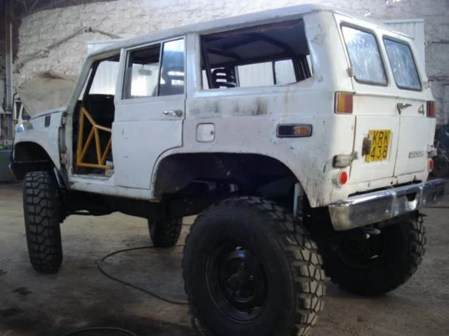

took her out for a drive last weekend......:bounce:HAPPY DAYS!!!!

these are the latest....I am not sure if I will get to do much more before january with the festive season being here and all that:cheers:...so please find the POTM January.
its an honour.
LANDMAWE.
The warthog
1976 toyota land cruiser fj 55
2f engine
holley carburettor
k&n filters
unimog 404 portal axles gear box stock springs
road train (australia) 806/403 oil shocks
monroe steering damper

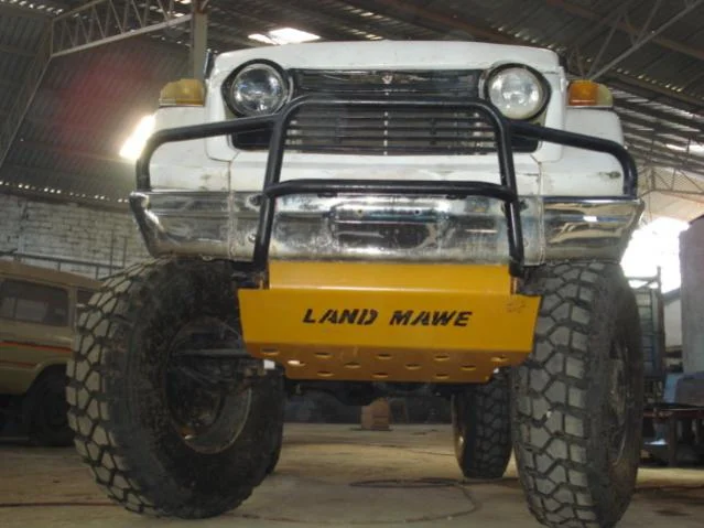

toyota hzj 80 power steering box
mazda power steering pump
chrome bumpers (dodge ram charger donor)
land mawe skid plate pipe doors and roll cage
pirelli 44" 365/80 r20 'pista 22' tyres
