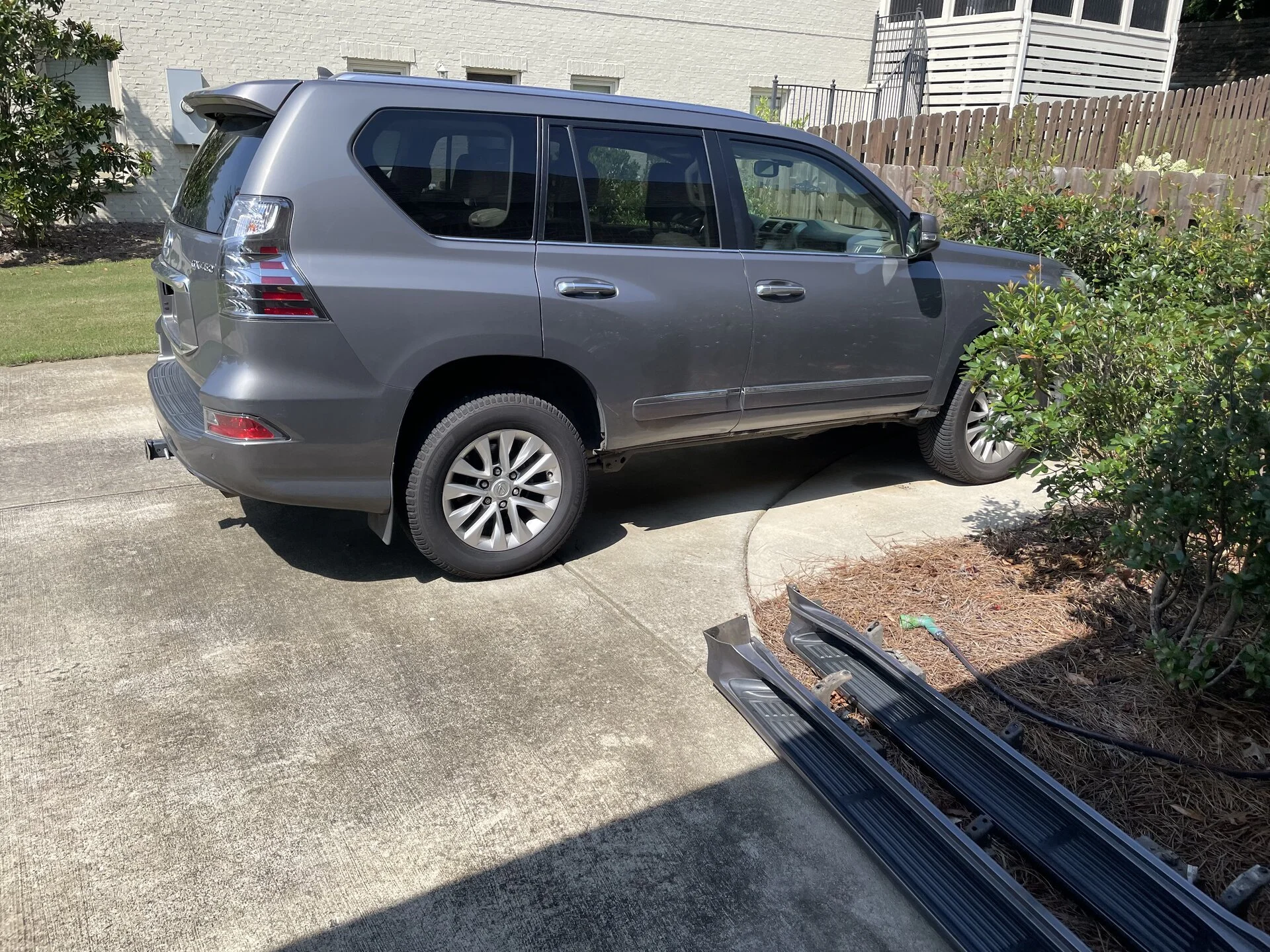

-Last weekend I did the running board removal/trim (pics attached)

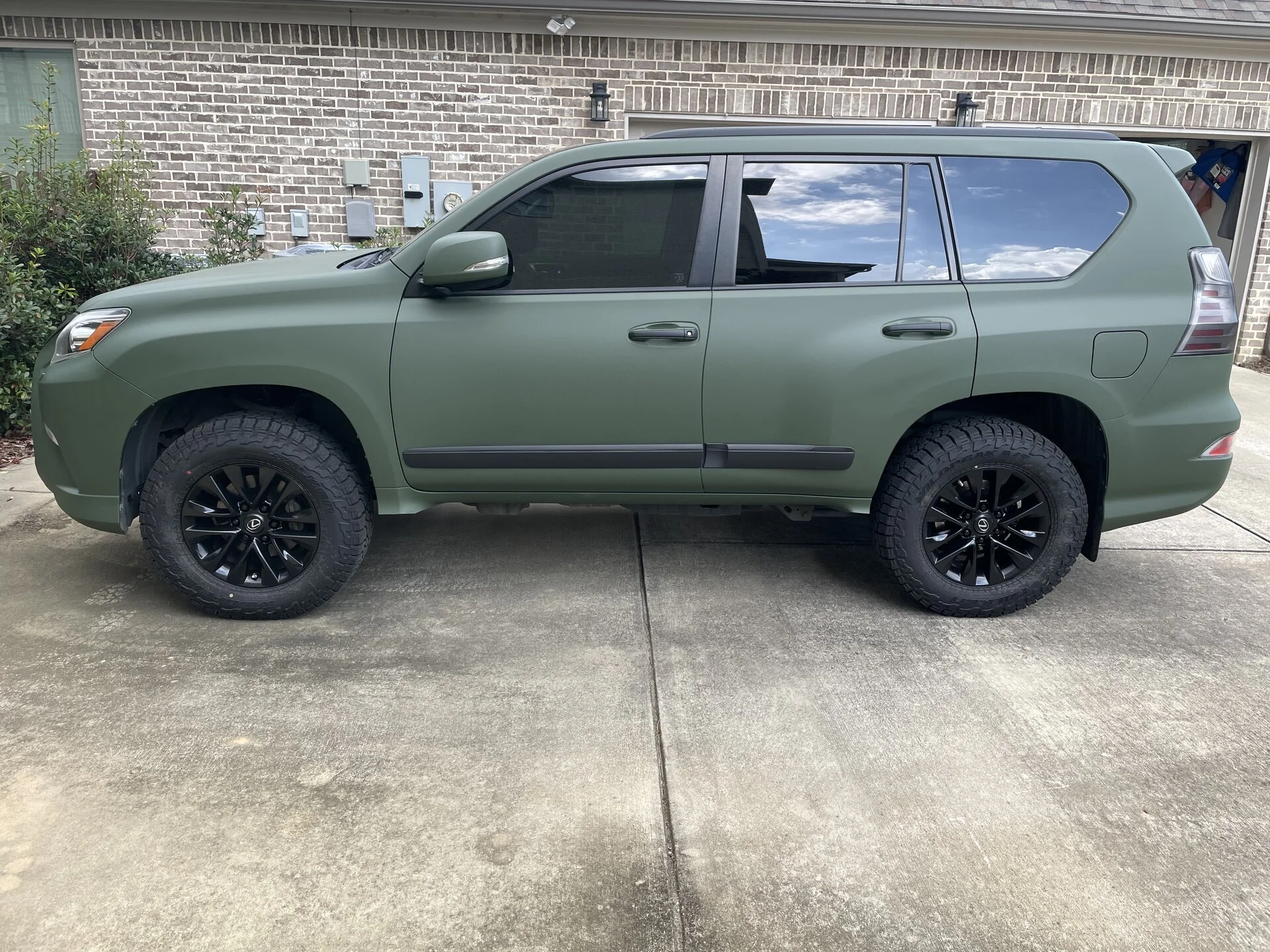

Alright guys. I ended up making a few mods over the last month. It’s coming along nicely.
-Went with new Bilstein struts on the front to bring it up 2”.
-275/65/18 Falken Wildpeak AT3W Tires
-Magnaflow Overland Exhaust
- Wrapped it Matte Military Green with Matte Black Chrome Delete.
- Blacked out the wheels. Went Plasti Dip to make sure I liked it as a short term solution. Will be powder coating or buying new Lexus Black rims/ New Black rims in general in the future.

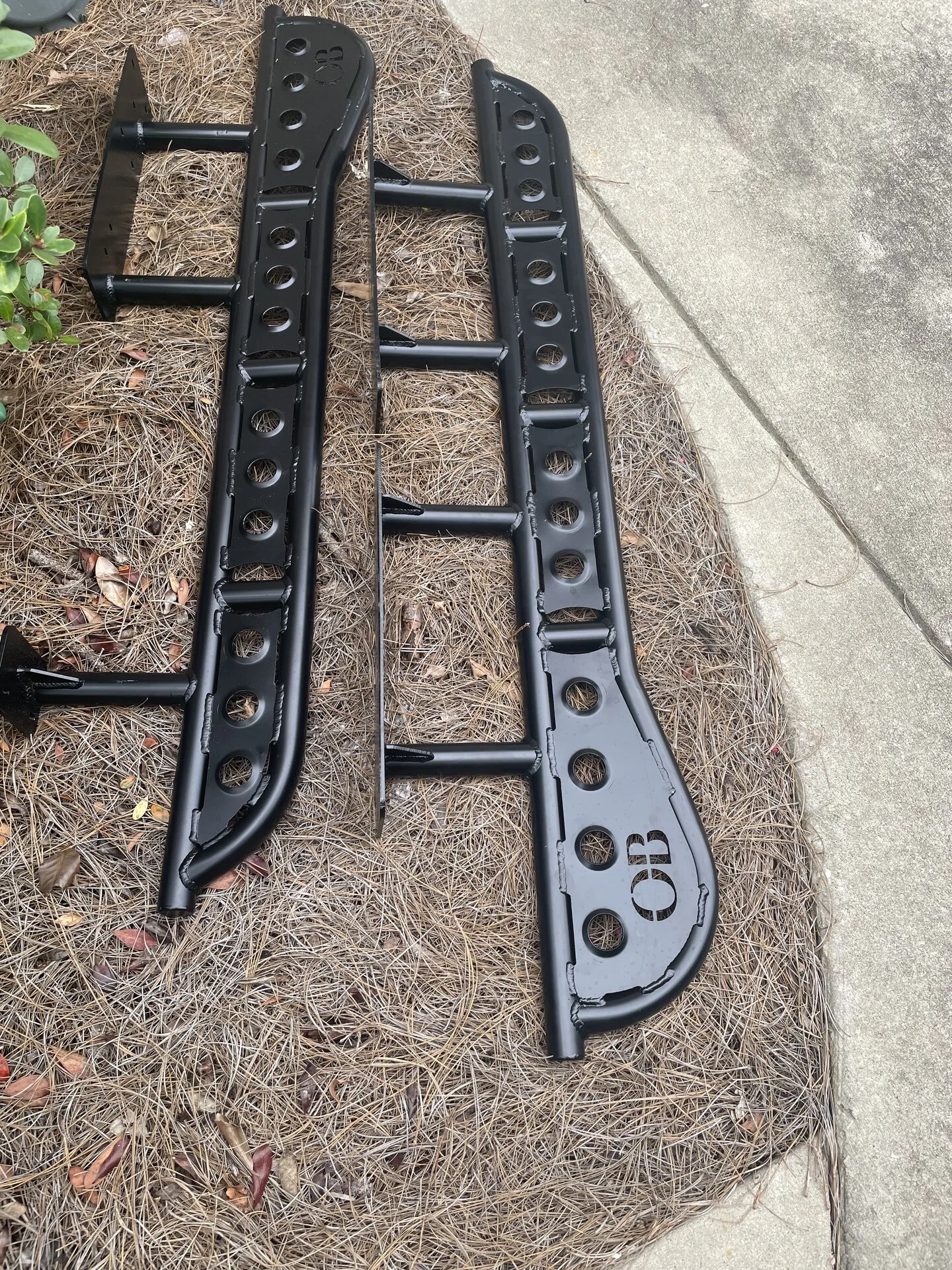

- Custom Rock Sliders are here. Bolt holes didn’t line up perfectly so I’ve been grinding them out to make them fit. Hopefully installing today.

Unique style, I like it.
Totally dig the OD green!
