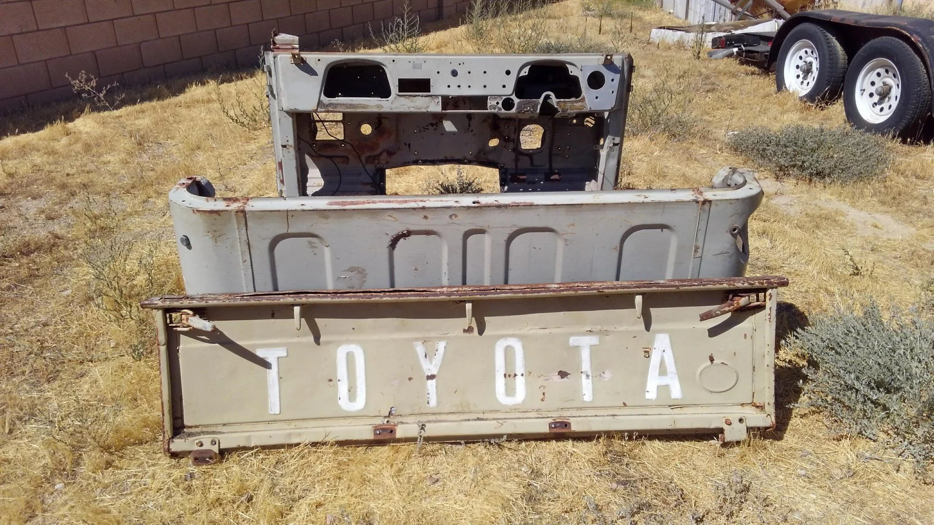

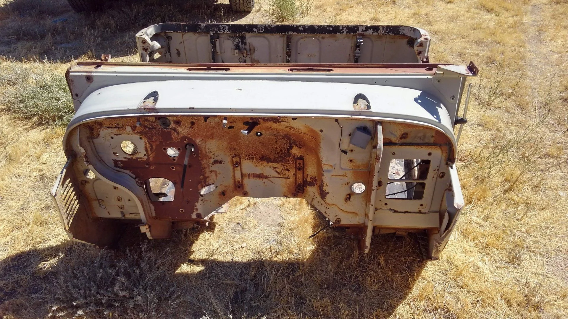

Snagged an Aussie lower 1/2 of a cab and tailgate. Pretty bare, but a start on parts. It'll be a few years, decades, millennia before I really get to doing anything with it, but every puzzle starts somewhere. The pictures make it all look better than it actually is. Rockers are in need of replacement, the tailgate...well I'll snap a few pics of it when I start peeling that onion. Couple of questions on parts interchange. Is the steering column the same RHD vs LHD? What about the under hood blower motor? I never paid too much attention to 45series trucks as I always thought I would never have one. Do they not have a cowl vent? Yep I jumped off in the deep end with this one. I don't even have a frame. Like I said this won't be quick, there are a couple other non Land Cruiser projects ahead of this one. Still it gets me enthused to get my 40 back on the road.

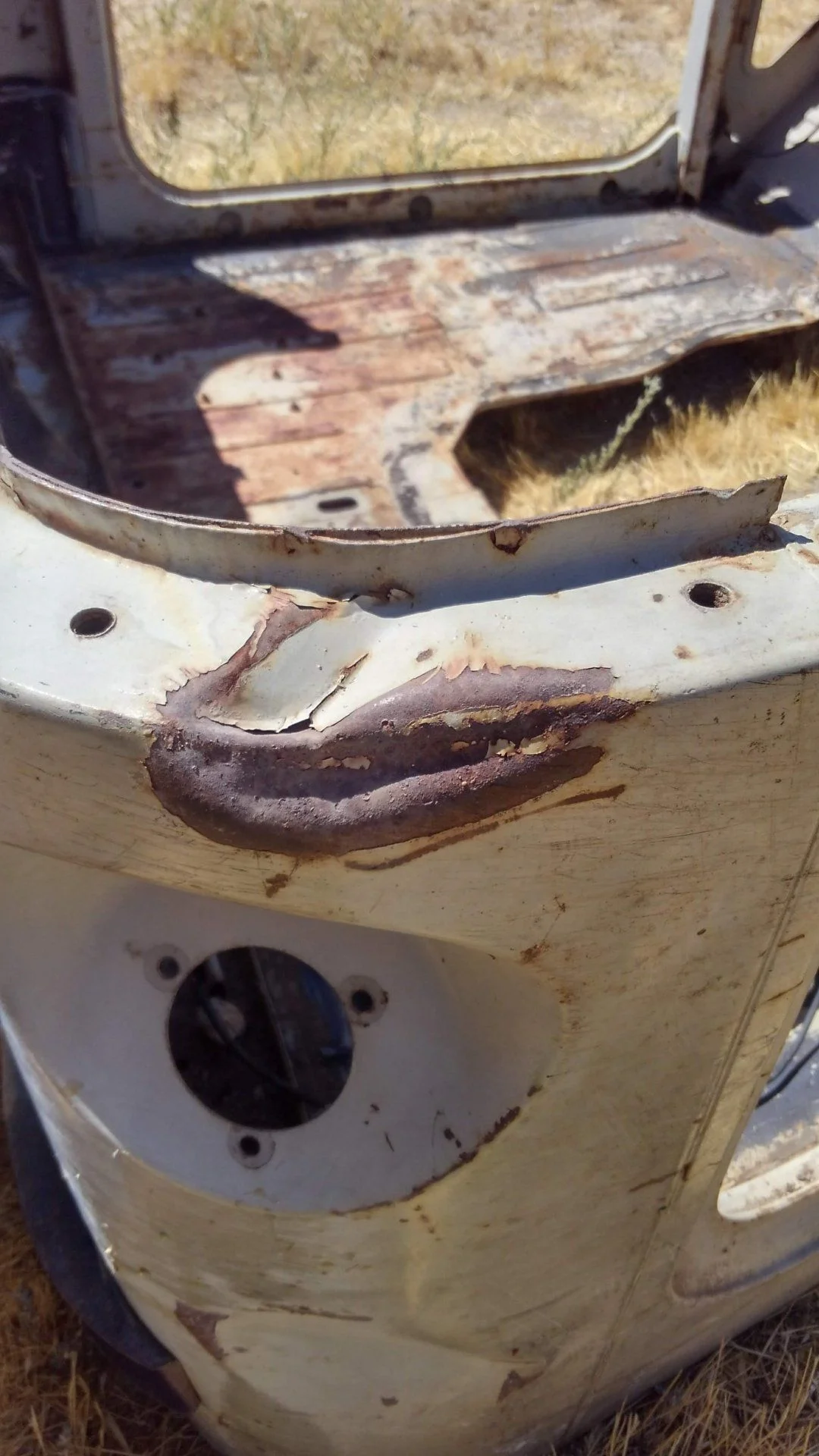

Windshield “cowl“ vent for ‘66 (IIRC) and earlier.
Yes at the base of the windshield. I am talking on later models between the windshield and back edge of the hood.

A cowl swap with a US spec 40 is very easy with readily available parts I did this to my AUS spec 45. I’m very pleased with the end results.
Well what year is this tub suppose to be? If ‘66 or earlier, no cowl vent. If later, then it’s been edited.
Looks like there’s been editing on the driver’s side firewall brace. So probably lots more been done.
I am very undecided on keeping it RHD. Definitely looking at the cowl swap. It needs lower bracing work anyway, so...

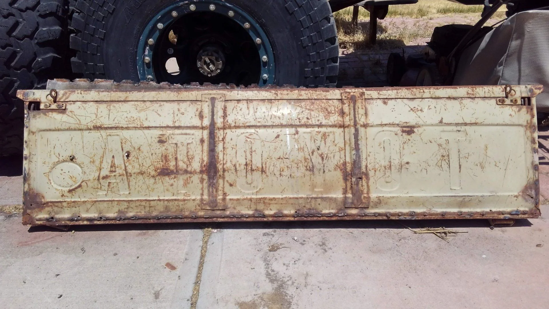

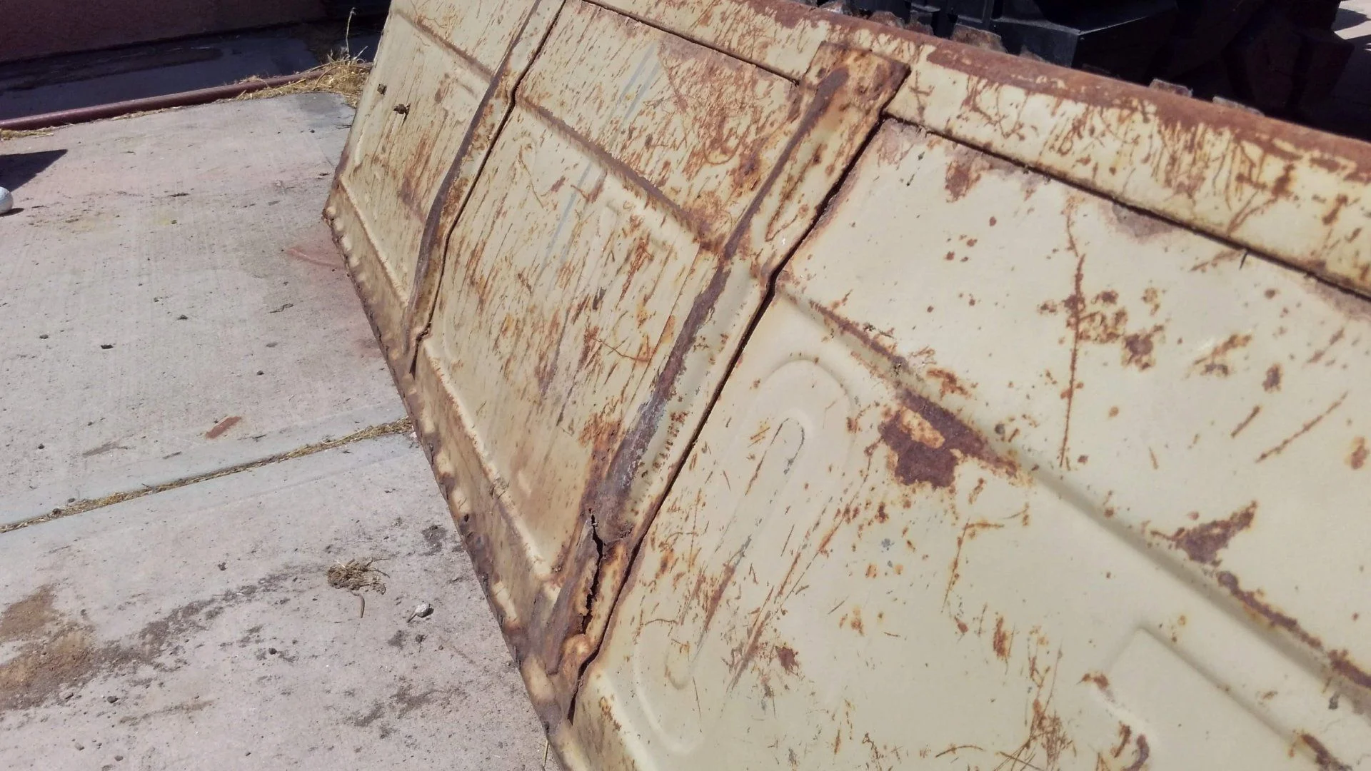

Took a few minutes with a cut-off wheel and grinder to take "repair" panel off the tailgate. Yep a sheet of galvanized welded to the steel...yikes! The 2 vertical braces in the mid section are pretty tweaked. Maybe I can convince Real Steel Cruisers to sell me just those. I am planning on blowing the tailgate apart and straighten each piece individually. I think it will look better in the end going that route. We'll see if I stick to that idea after I get the braces off. Once I get the braces off and burn out the plastic filler I'll hammer and dolly what I can. Gonna be a fun challenge refreshing the lettering stamping.

For some odd reason they dipped their toe in and out of the water a few times with the cowl vent, at least on all the trucks I've seen. My original 1970 cab had one. My current 1974 cab has one. Then they disappeared in 1975 but made a resurgence in 1976[?] for a year or two and then disappeared again.
