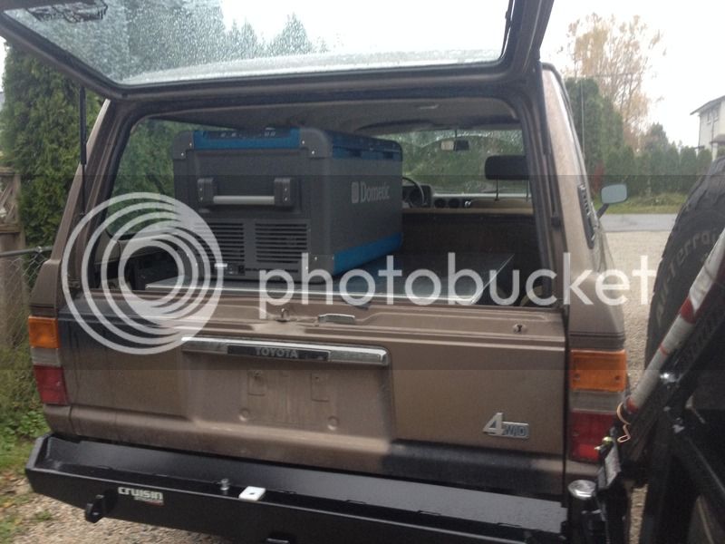

Fridge has been awesome by the way. I think you can get the off Amazon.com
Yeah Amazon doesn't sell that model just yet..
I contacted the vendor
I have a 12v fridge same size, but the dimensions don't jive with my plans and the 60 cargo series...
Thanks for the comeback....
