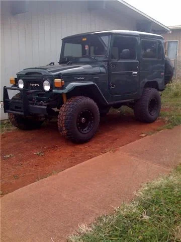

Here's for all the 40 fans. 4bd1t hooked to 4l60E. Fun to drive, just need some sound insulation now.
The 40 almost has the factory look to it.

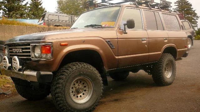

1988 tlc with isuzu diesel - running great

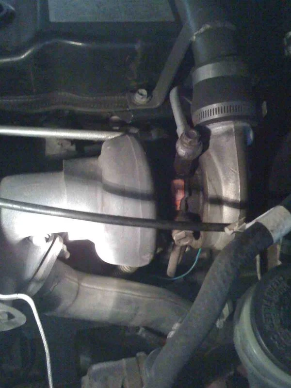

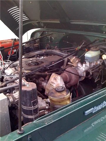

it has been awhile since i have posted any thing, but i have been doing some small tweaks on my fj62, and getting it out and using it!
My latest addition was a new turbo, which I posted earlier in this string. This turbo has helped a lot in getting power out of the small 4bd1t. i have also had to replace the radiator awhile back, the old one had holes, and leaking in the core.
I have been driving on many roadtrips, taking the truck into the uintas mountains shown here. also drove it up to the Gros Ventre range in WY, to elk hunt this fall. it pulls great in the mountains, first gear, 4wd it can pull anything. i have not had in 4wd-lowrange yet. i can imagine it will be a stump puller.
It has been a great rig, and settling in to the conversion. I have wished for more power. I did some mods to my 1996 dodge cummins, altering the governor, and the cam plate that controls fuel flow. the results were amazing!
so i gave the isuzu more fuel. Turning the screw on the side, counterclockwise, one full turn, has made the engine so responsive! it has more boost, and more power. i have to really watch the EGT gage however on the hills. i can easily get to 1200F and need to back off, or shift to third.

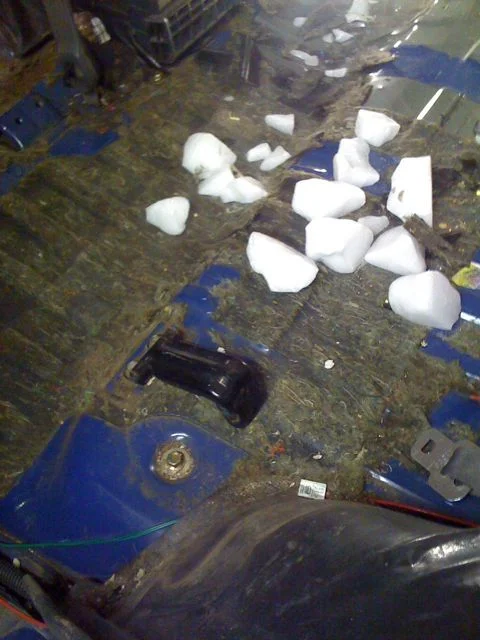

so i took out the interior, seats, carpets, pad, console, side panels, all of it, and then proceeded to add sound dampening. first thing was to remove the asphalt on the floor from the factory. this looked impossible, but with some searching on the forum, was able to discover a cool, cold trick. dry ice, and a rubber mallet. set the dry ice on the asphalt, wait 5 minutes, and then move it out of the way, and whack it. the asphalt breaks in it brittle state, and comes loose in large hand size chunks. floor was clean and ready for some sound deadening materials.
