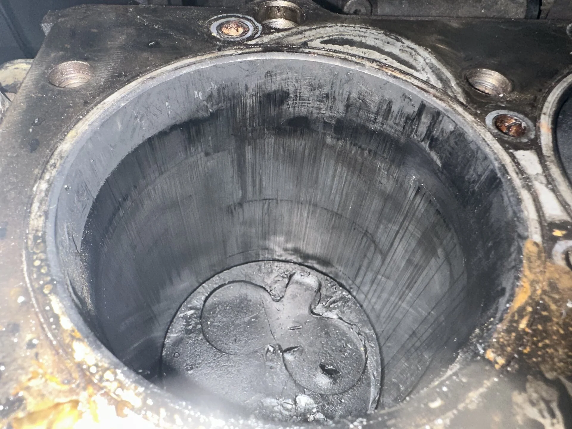

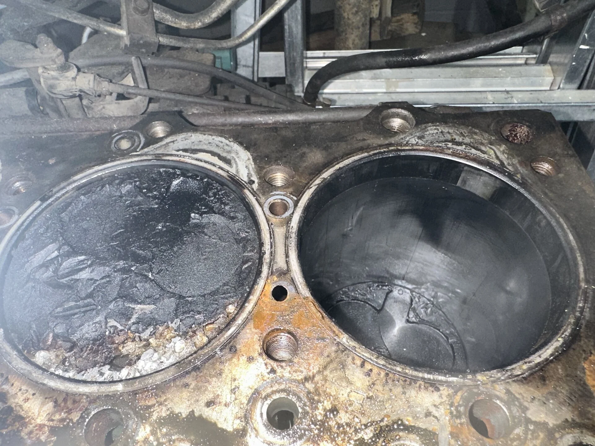

Well, I finally picked up a 4bd2tc that needs a rebuild. I’m considering rebuilding it as a 1t. I need a rebuild kit regardless, so might as well eliminate any potential head cracking issues down the road. Pistons, a new head, and 1t injection pump seems to be about all I need. Other than any necessary machine work, I want to rebuild this one myself.
The only machine work needed to rebuild these is pulling/pressing liners. Valve work in the head would count but if you're changing the whole head that's done.
That’s great news. I’m calling the two local Isuzu dealers tomorrow to see if I can get a rebuild kit…fingers crossed. If not I hope to save these liners. Turbo exploded and sent bits through the engine.
I'm running a 4BD1T that also ate a turbo before I rebuilt it. Doubtful those liners are salvageable, but fortunately, pressing new one's in is pretty easy.
