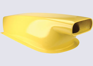

I ain't a fearin' ta cut in the hood and do something totally rad! Seriously though it seems like smarter time management to cut the pan instead of modding the body or hood, but I am in no hurry and have it all torn down. If anything maybe I can improve your morale by asking an easy to answer question.
Awesome job documenting your work, it is much appreciated. I have completely disassembled (frame off) my 80 and will soon start rebuilding for a 4BD. In your thread here and on 4BTswaps (and the other 80 swap threads) from what I understand it is standard to mod the oil pan for clearance. What I haven't learned is why? Is it hood, trans tunnel, firewall clearance or a combination? I am planning on 440 split case as well.
Well on the 4BD1T there is no oil pan modifications required. I did none and have lots of clearance. No need to put a silly hood scope or any other hood mods. This engine fits very easily and with quite a bit of room to spare.
