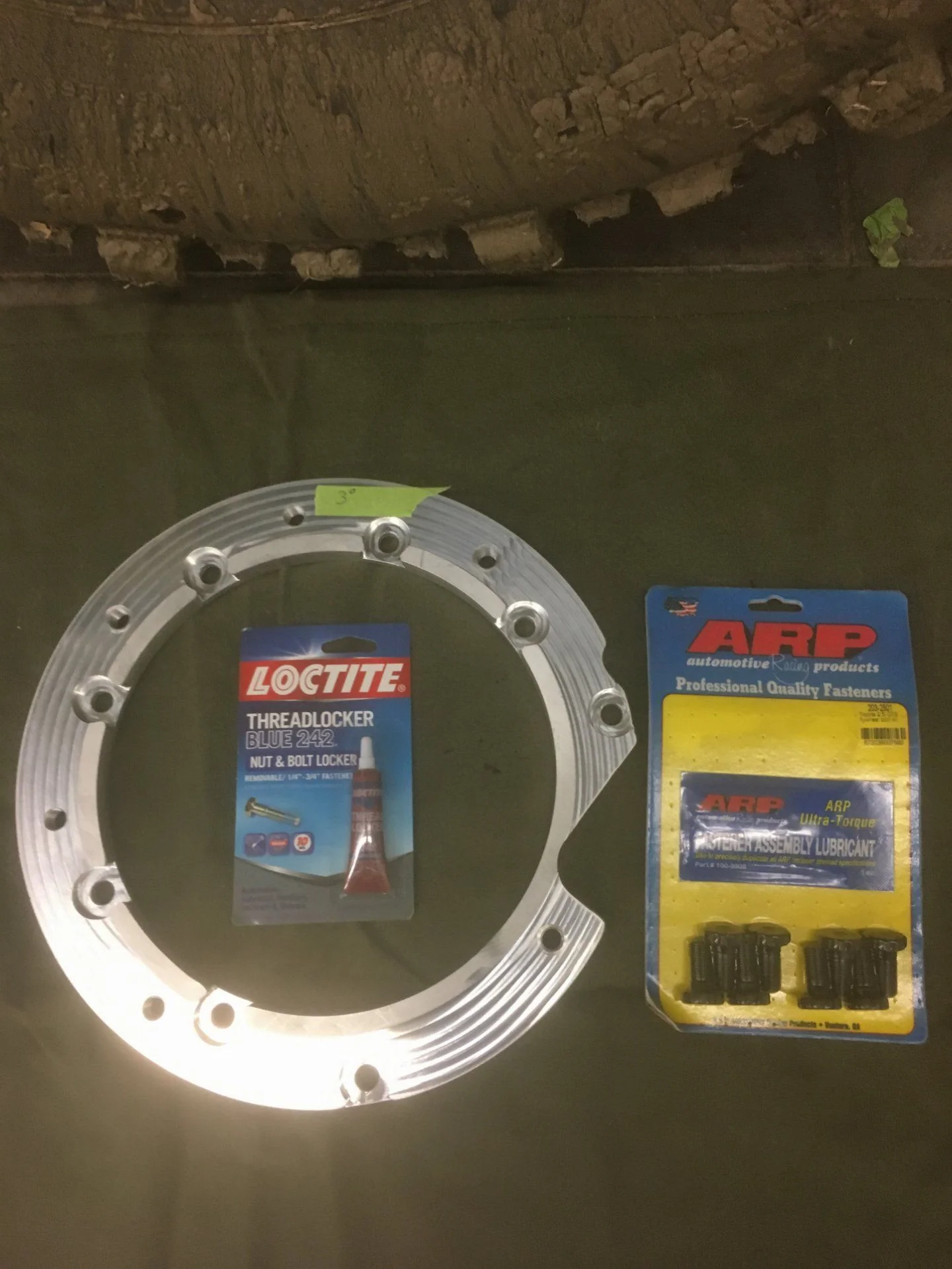

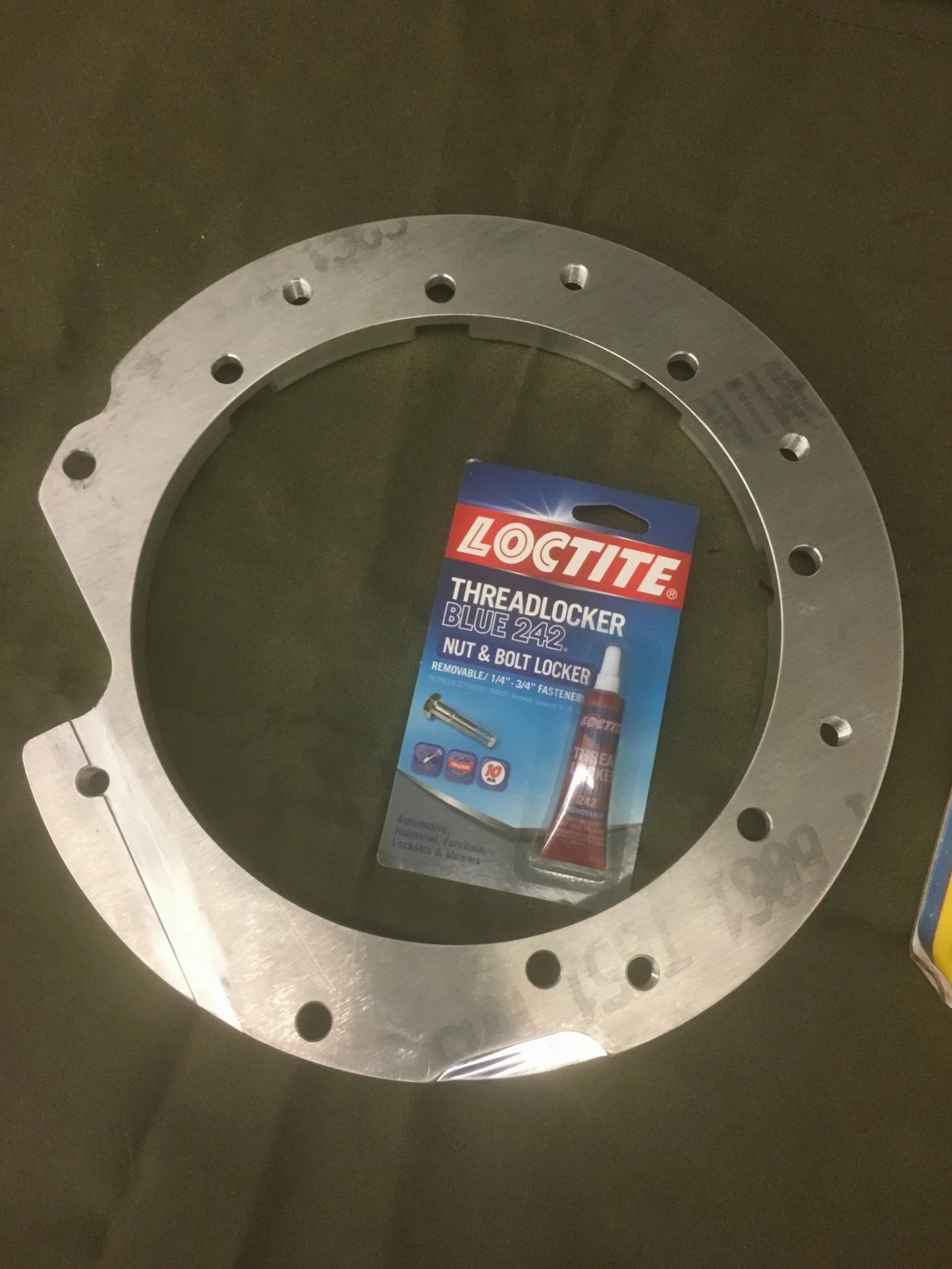

Adapter and low profile bolts to adapt A440 transmission to Isuzu bell housing $.+USPS
I have a 3 degree for some extra clearance or a straight up.

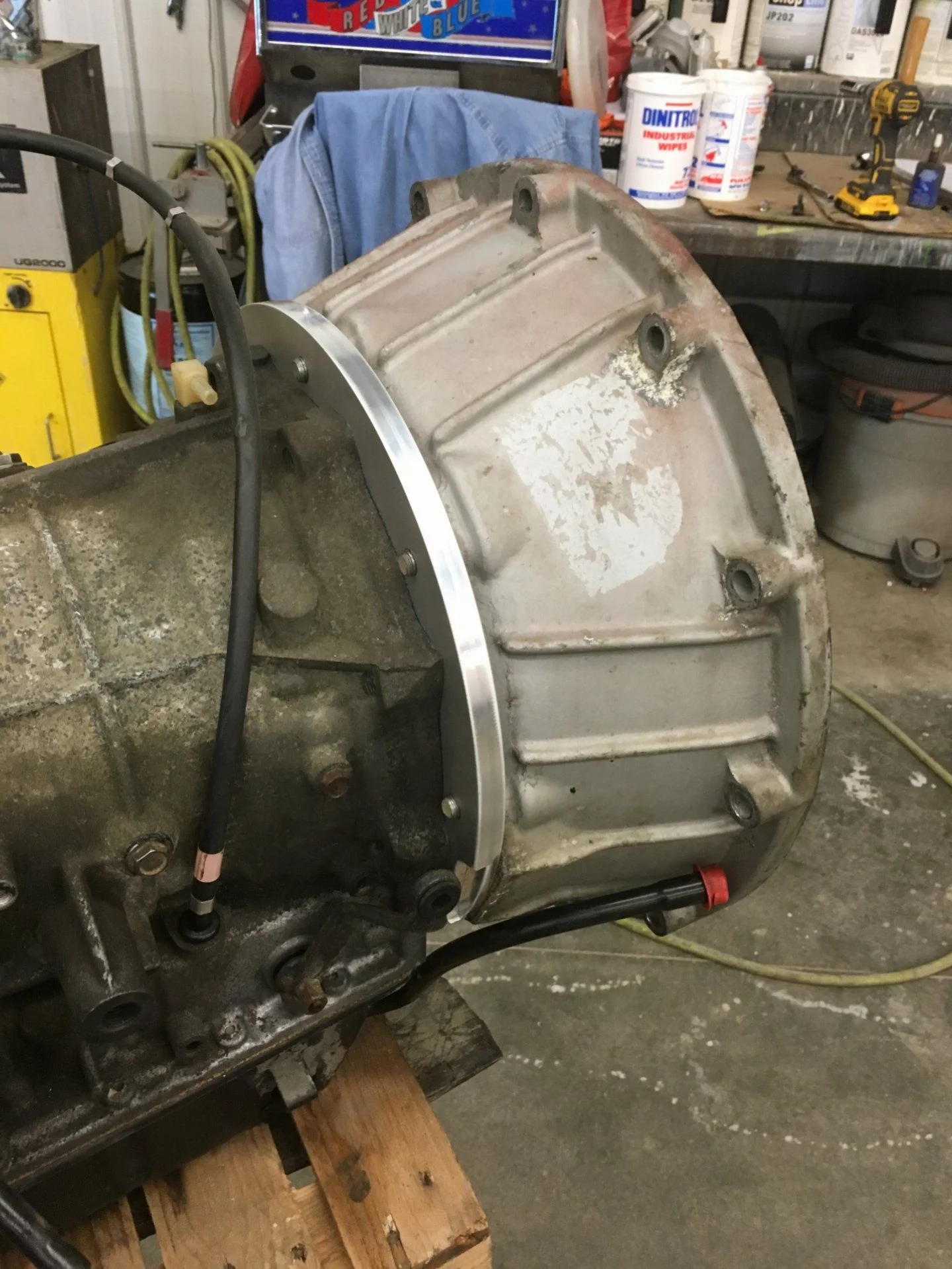

You will need the stock isuzu flex plate and torque converter.
The A440 doesn’t use a controller.
The A440 holds up to the isuzu no problem.
