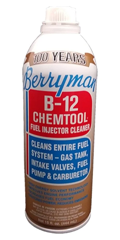

Since you're on the road hit up a WalMart and get some B-12, can't hurt.
