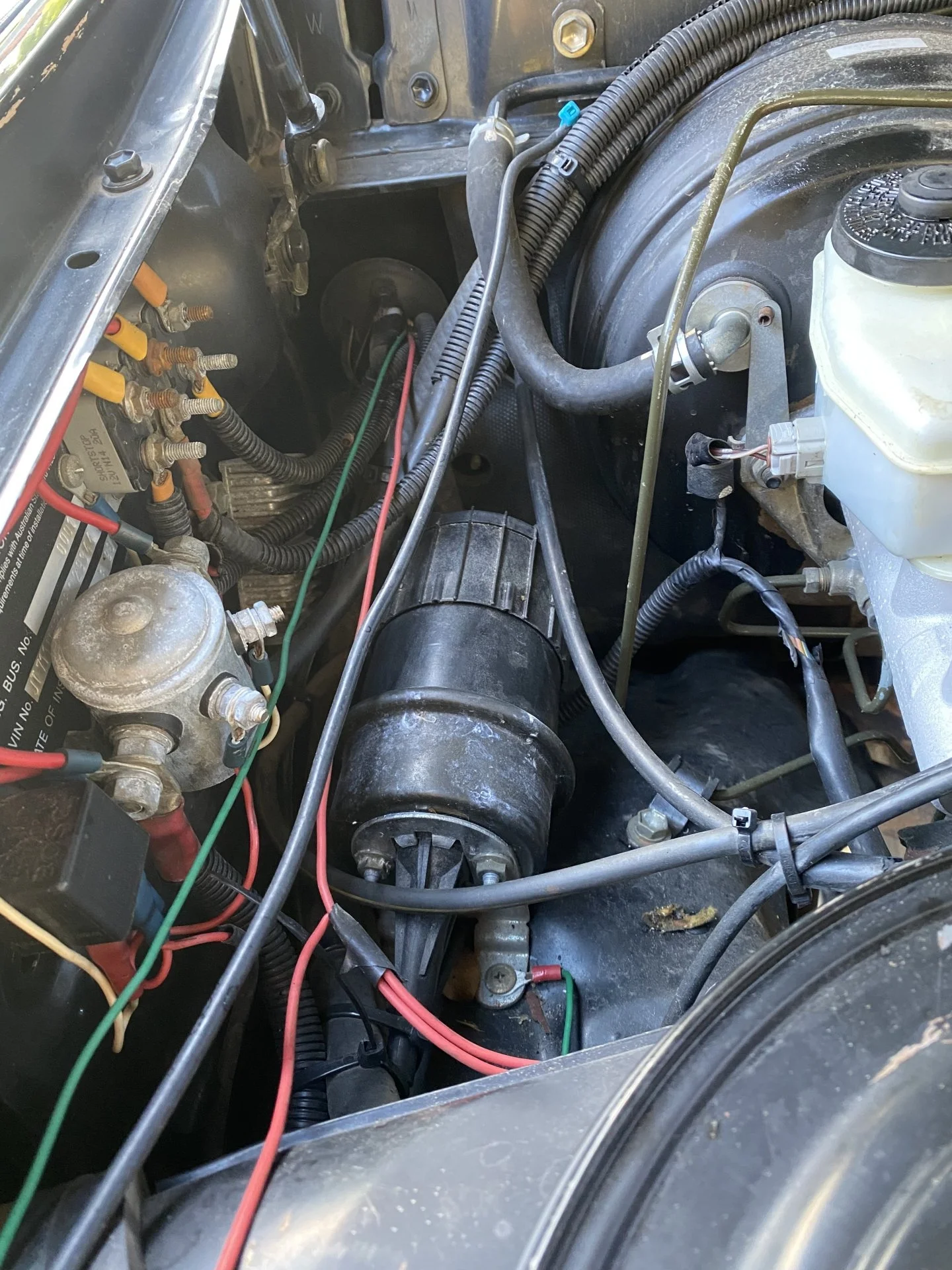

I’ll have to get photos later as I’m at work but I did notice 2 things, one is a vacuum line that goes into the intake (circled in red) that has a small black fitting with the nipple of it broken off (it has suction pressure), any idea to what that is for?

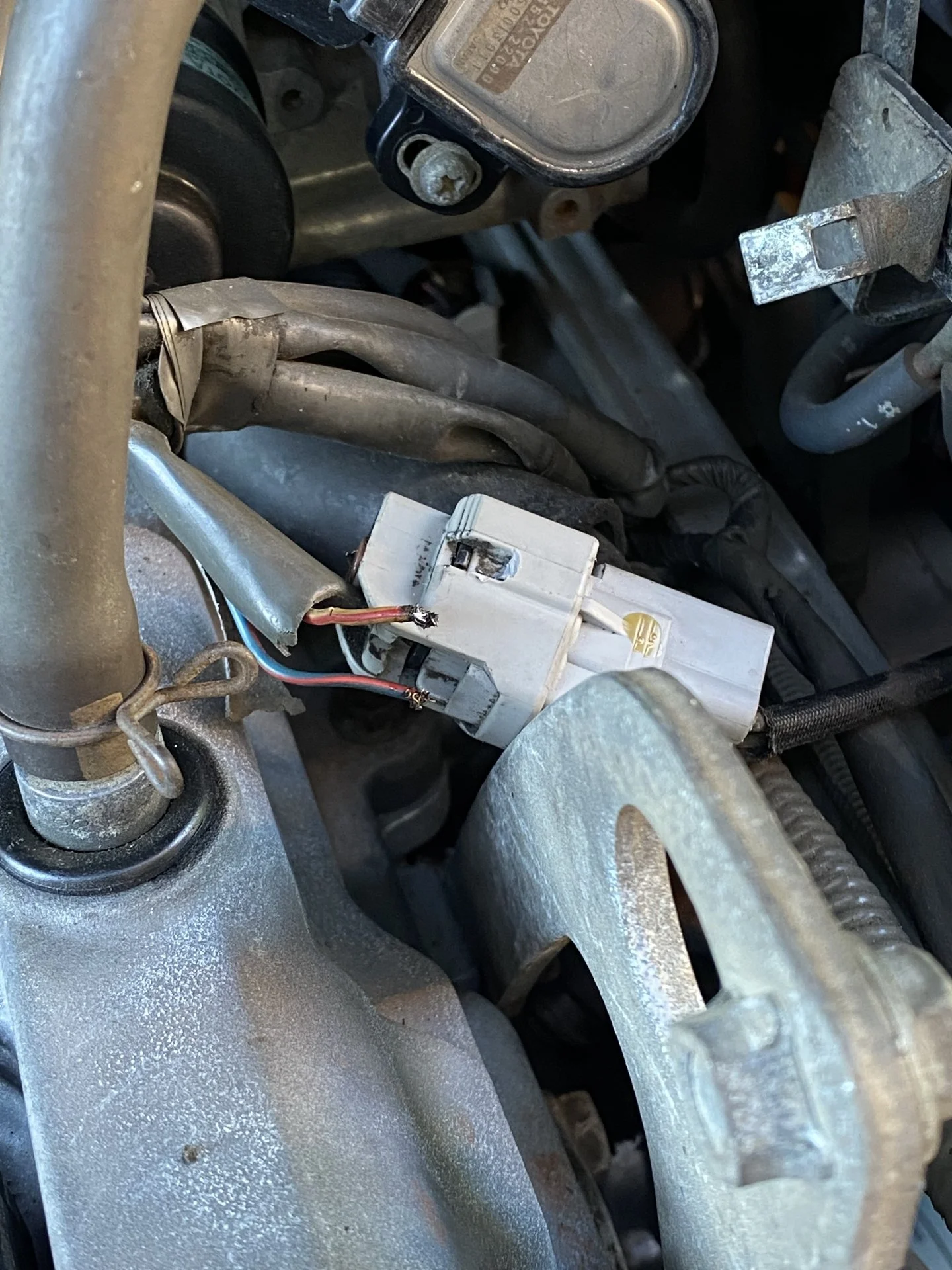

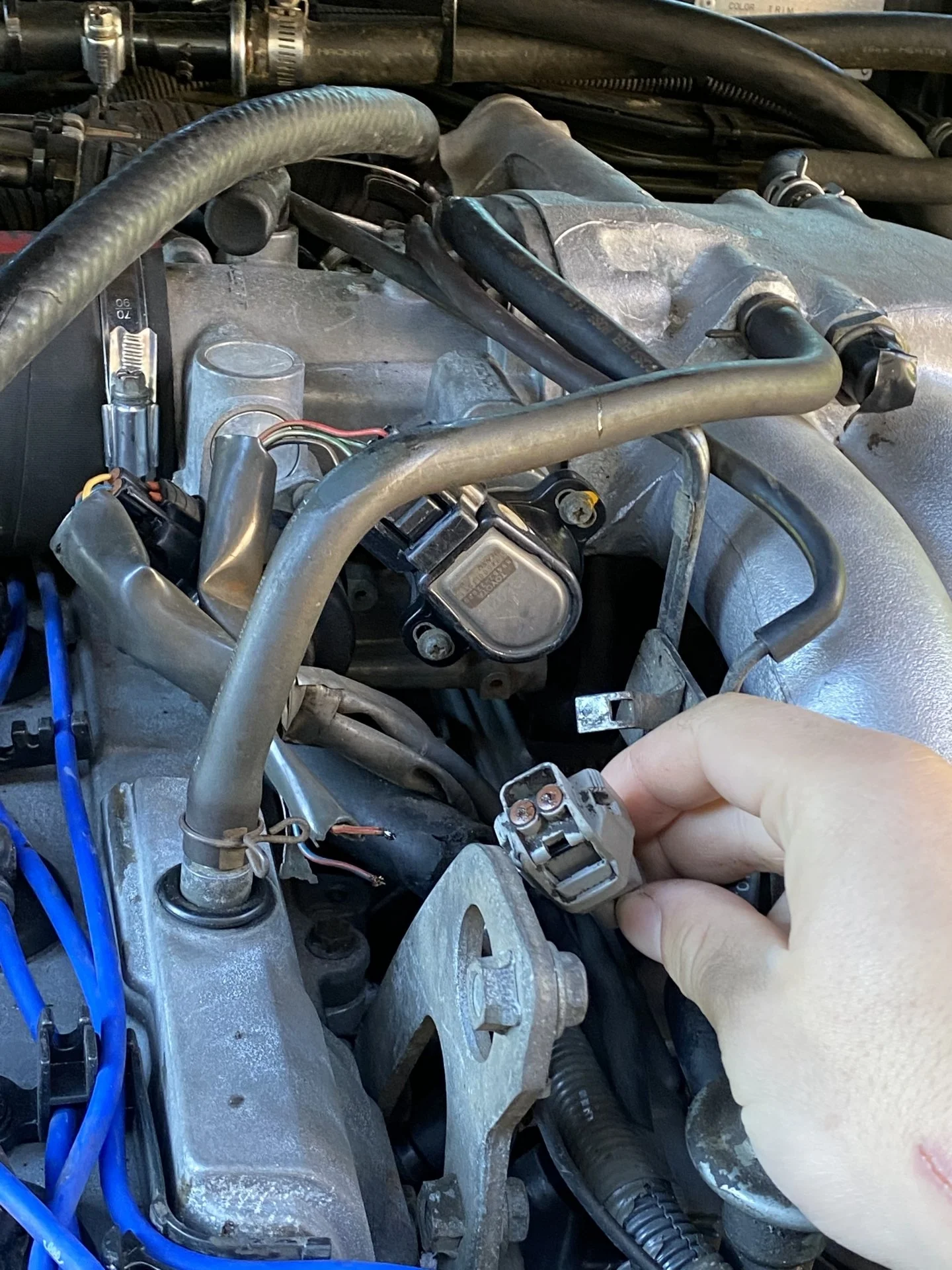

The area circled in blue has a connector down that area that has 2 cables going in and 2 cables going out down lower, I noticed one of the cables in that connector had broken away, I’ll grab a actual photo of this after work too but you wouldn’t happen to know what it’d be, if I remember correctly the cable was yellow with a black stripe

I forgot to check the spot it was coming from, but I managed to get this photo, wondering if you know what it’s for? She’s completely separated into 2

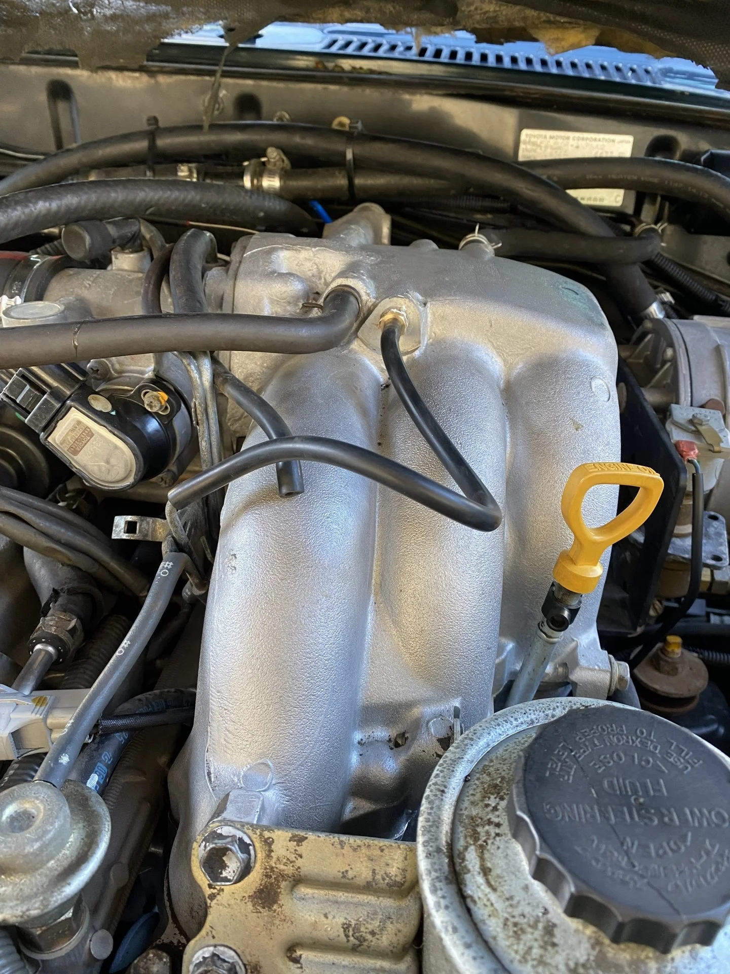

And this, it seems like a damaged vacuum line that sucks in, I plan to do off-roading and imagine if water got there it would suck it straight into the intake, any idea of the name on that part or where it should be ran to? I covered the hole because it made the car idle a lot better so maybe it’s better off being plugged?
Do you have a vacuum hose diagram on your hood?
The tubing routing looks a little goofed up unless it’s different from the US configuration. That gas filter is passing full manifold vacuum and should be connected to that metal tube in the foreground of your picture.
the broken connector looks like the EGR VSV connector on US trucks. Thought AUS didn’t have EGR? But if you do I bet that’s what it’s for. Are you throwing any engine codes?

I replaced the filter with a barb as it’s impossible to find one in Australia and reran that hose to how yours is, starts with much more ease now. The hose that you spoke about being ran oddly is now disconnected, and has caused no difference to how it runs, it runs to a black cylinder kind of thing and creates no suction. If I can’t find a place it runs to or if nobody knows, I’ll leave it disconnected until some symptom shows up that may explain it
Can you snap a pic of the vacuum hose routing diagram on the bottom of your hood?
The gas filter is a pretty simple one. It is connected to a hose, then to a pipe, to another hose, to the VSV, a hose, a pipe, a hose, and then to the Regulator. You can follow that circuit under your hood to verify that is hooked up properly. It sort of looks correct now but the pics don’t show all the angles.
that’s the general gist of it. Your PCV hose is blocking the view a bit to understand where the hose you unplugged is supposed to go to. But first identify the components under the hood and then you can follow the vacuum line routing between them.
I’m not sure if that black canister is your charcoal canister-it looks different than US charcoal canisters.
