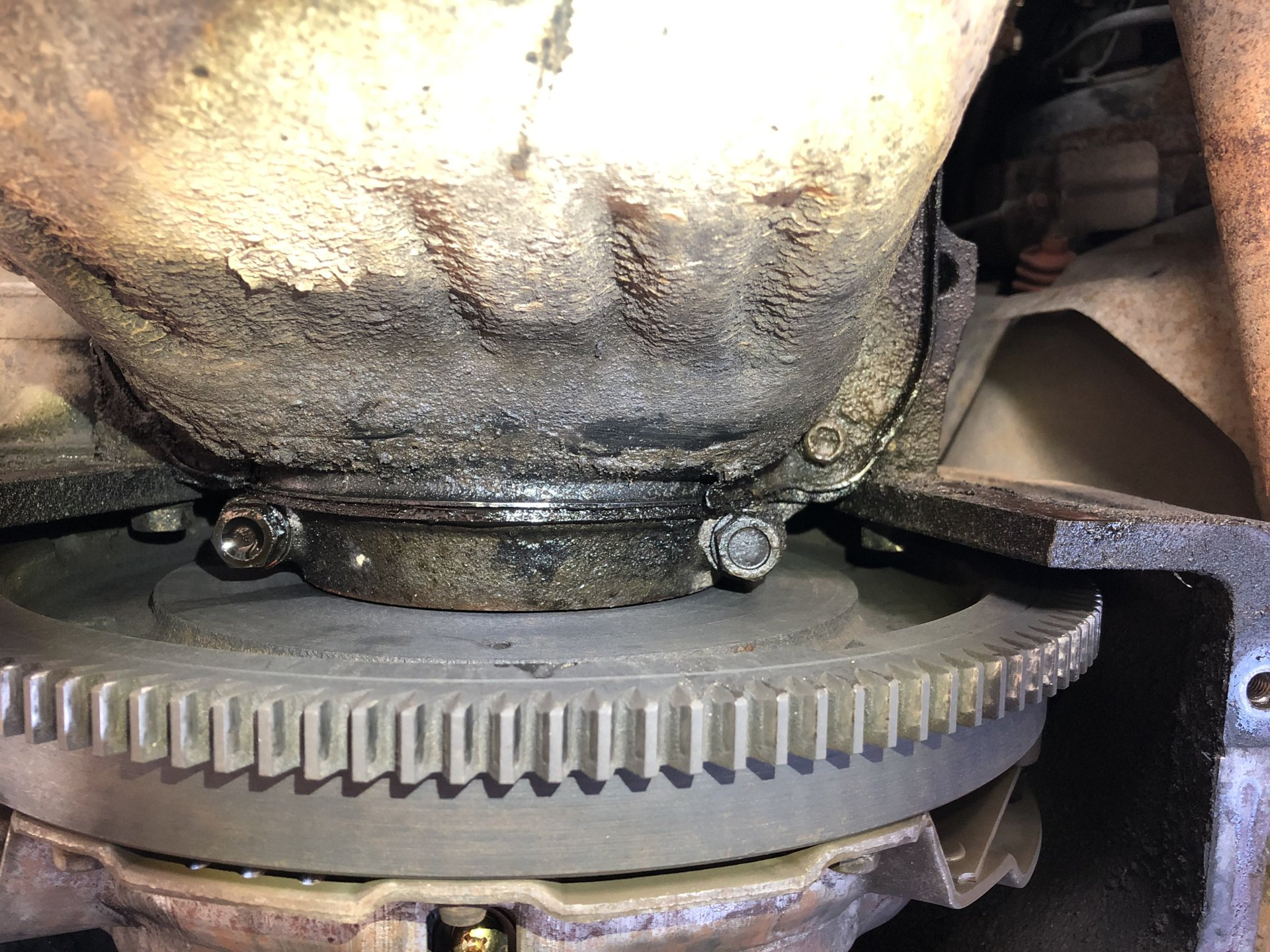

That's an very odd sound for a end bearing to make, but I suppose it's possible. They call it a 'Rod Knock' for a reason 'cuz there's a rod involved with the ignition thrust.
Can you carefully put the stethoscope rod on one or the other of the rod cap bolts while the engine is running?
Isn't # 3 the end cap ?
You’re right, it’s #3. I had it oriented wrong in my head. I don’t think I can get the steth on there with the flywheel spinning - the cap is sloped towards the flywheel. I’m using a long screwdriver and it’s going to slide right into the spinny stuff. Maybe I’ll try to get it on one of the bolts.

Here is another video of the noise, this time underneath the truck with the flywheel inspection cover removed. Notice that when the phone mic gets adjacent to the edge of the bellhousing the sound increases in volume. When I used my homemade stethoscope I found that the sound was loudest through the bellhousing. Correlation? Possibly.
There is no easy way to inspect that bearing. First, the oil pan has to come off because it sits on it. Second, the flywheel has to come off to replace the rear crankseal. I guess the upside is you could check more than one bearing and you could have a look at the pilot bearing.
