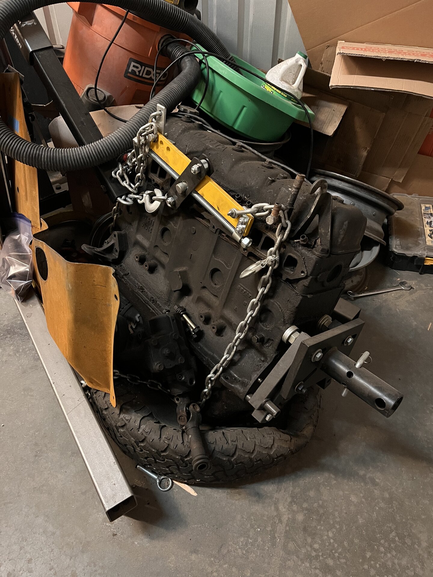

Onward to more testing now that I’m finally at the shop. Worst case scenario I lose a season of camping & wheeling while refurbing this:

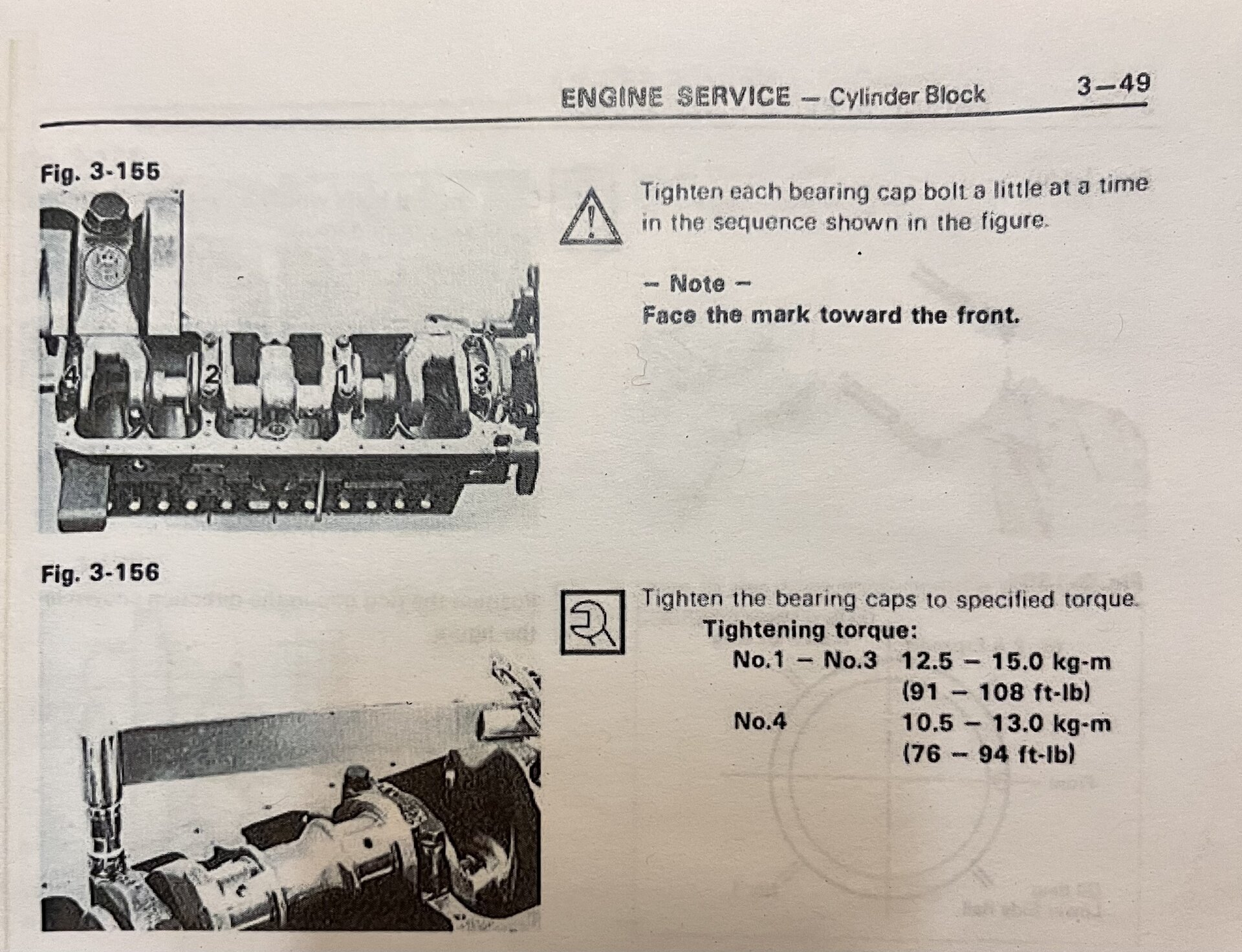

Looks like the FSM calls for 76-94 ft-lb of torque on that rear main cap. If I’m reading things correctly. Yes?
Having never done this before, would I be good to remove that, inspect, then replace and torque it down? 76-94 is a wide margin, what am I looking for on that? Is it a feel thing?
That's an very odd sound for a end bearing to make, but I suppose it's possible. They call it a 'Rod Knock' for a reason 'cuz there's a rod involved with the ignition thrust.

Isn't # 3 the end cap ?
