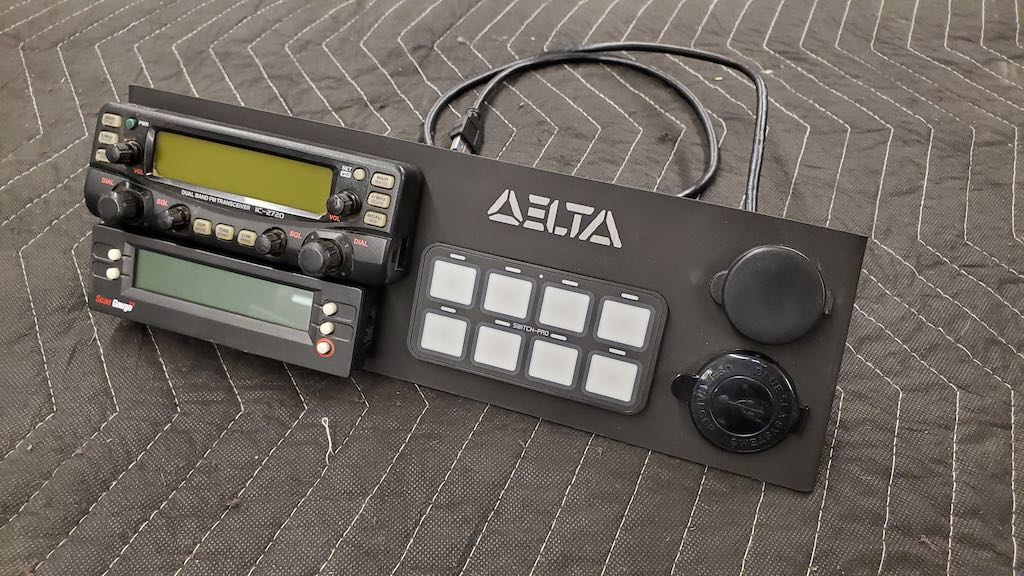

Just added a new faceplate for LHD auto shifter consoles, this one has a big blank space for things like remote mount radio headunits, ScanGauge, etc. The pics with the parts installed are on this particular faceplate, SwitchPro just mounts over the switch holes.

Recently received some nice pics of a RHD auto shifter console, put them up on the product page. Fit seems to be completely proven at this point.
It's made from 14ga cold rolled steel, should be good with Andre the Giant standing on top of
I agree about the corners, bur appreciate the tradeoff on available space and manufacturing.. Can you show a pic of the hinges you plan to use and how they will be integrated? That said, I think the combo of the shifting console sells it.
To be clear, there are no "plan to use" parts any more, these are all finalized and have been on the market for a while now. The hinge is simply a heavy duty stainless piano hinge held in place with bolts so it is a little adjustable. You can see some more photos on the lower part of this page: Delta Vehicle Systems - FJ80/FZJ80/LX450 Locking Center Console - https://www.deltavs.com/all-products/fj80-fzj80-lx450-locking-center-console
Wow! My apologies, that is extremely well done and I see how it works with the shift console.
