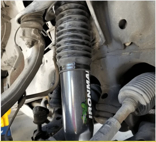

Installed my pro and boy they're very stiff. Not sure if I like it that way.
1. They will soften a little as they initially heat up. They'll be stiff for the first 1-2 miles while they cycle and then soften a tad. They'll do this every time....just a product of the foam-cell design (same thing happens on my ToughDog foam-cells).
2. They will ride "harsher" compared to OEM as these are valved differently and designed to handle loads greater than stock and off-road/corrugated roads. I prefer the greater control of these larger foam cell shocks on my rig and find them to be very comfortable (but I have a bunch of weight on mine).

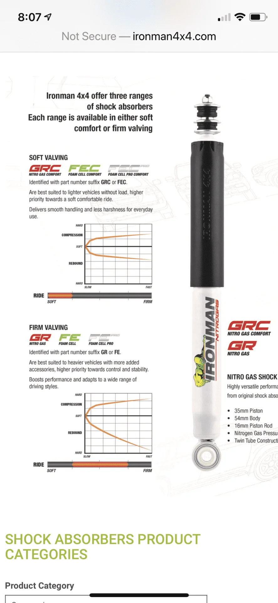

They do?! Where are you seeing this?
I spelled this out in the beginning
The 100, even LOADED like mine does best with the soft ride.
I chose the firm for my 55 and 60 to help with body roll. I chose correctly.
Your shock will be labeled.
I'll be damned. Looks like I have the FE on my 100. Wish I'd gotten the softer version the back can get a little "skippy" unloaded.

There are rubber bushing like things on the shocks near the dust cover. Does anyone happen to know the orientation and where they go exactly?
I'd also like to ask which way the rear shock bottom mount goes (it's offset)?
That’s the bumpstop. It goes on the shaft first
Awesome! And which way up? I’d think the flat part is the bottom part so when the shock compresses it contacts the larger possible area?
Do you happen to know which way the bottom eye of the rear shock should be installed? Closer to axle or further from axle?
I don’t understand the question
The bottom mount ring on the rear shock (that attaches to the axle) is off-centered on the FCP shocks. I’m searching for an answer about which way out of the possible two should it be installed onto the lower shock stud.
