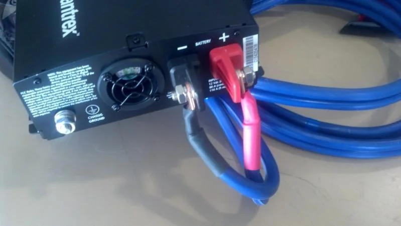

Thanks for your feedback. I actually did order one, I went with a Xantrex Prowatt 1000 from Amazon. Then I picked up a really nice set of 2ga jumper cables, I cut the clamps off of one end and crimped on some nice ring terminals, with heatshrink. These attach to the studs on the back of the inverter.
We've tested the setup twice now in the field and it has worked perfectly both times, no issues.

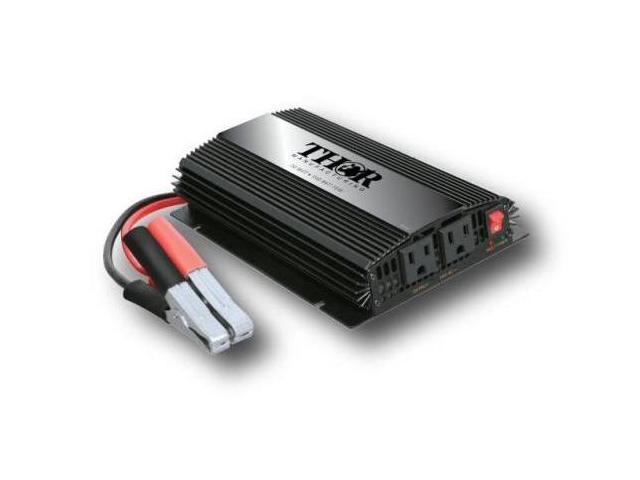

Don't know if you found what you wanted yet but back in the spring I was looking for what inverter to buy and I came across a thread somewhere where a guy worked someplace that sold and serviced inverters of many different brands with many fleet contracts, from corporate fleets to limo companies, and he said the one manufacturer that had the fewest returns was a newish company called 'Thor Manufacturing'. He said they were in the process of converting all their accounts to Thor inverters, and that this brand was overbuilt, producing 10 or 20% more power than their rating. Perhaps this was one reason for the few number of failures.
So based on this and the fact that I knew little about power inverters I bought a Thor 750 Watt modified sine wave inverter ($50 on sale) for the modest needs of my cruiser, and it powered my phones, electronics, lights, drill, boom-box and a shop-vac all summer and fall with no issues at all.
They also make a new line of pure sine wave inverters for a lot more money but I've since seen these being highly rated also.

Edit: installed on the rear panel, 4ga wiring.
