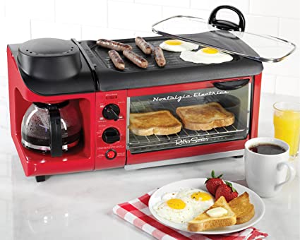

This is something I saw today that is 1500w that reminded me of this thread:
@Fast Eddy haha, that's about what I'd run with it at camp, and those draw a decent amount without even looking at the specs. I'd probably ly look at the largest griddle specs and double it, maybe slightly higher to the next size up. Better to have and not need than be SOL!
